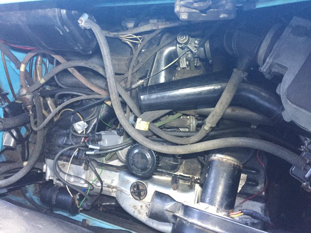

I finally got my '74 1.8 engine started. Seems to be spewing white smoke Also, when I connect vacuum hoses to the decel. valve the engine stalls.
I wonder if I need this valve? also if I eliminate the valve I can't just plug the hoses because, again, the engine will stall. (IMG:style_emoticons/default/WTF.gif)

I went through this many mon ago; When I removed the decal on my '75 L-Jet, we used rubber corks and inserted on into the plenum nipple and a second one into the boot orifice/nipple. And, removed the small vac line.
Sound like you may have an air leak there or on another connection. Be carefull; sometimes a hose looks good, or a Y connector is holding; but closer inspection/testing reveals cracks.... (IMG:style_emoticons/default/smile.gif)

Can you post a picture of your engine bay?

Make sure that the hoses aren't switched.

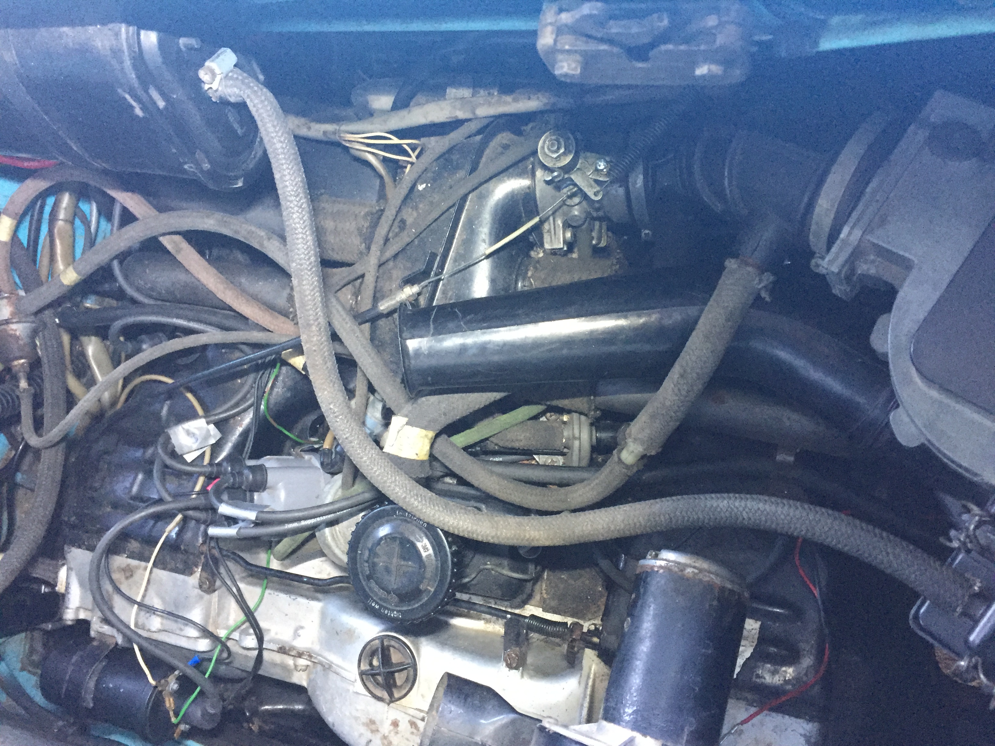

Here is some picturesAttached Image Attached Image

Well, it's been many days and a lot of fiddling with ignition and fuel and i'm still no closer to solving my problem.
Car will only run when I disconnect the decel valve and don't plug the hoses.
Also, white smoke.
I'm a patient person but i'm just about at the end of my rope!
