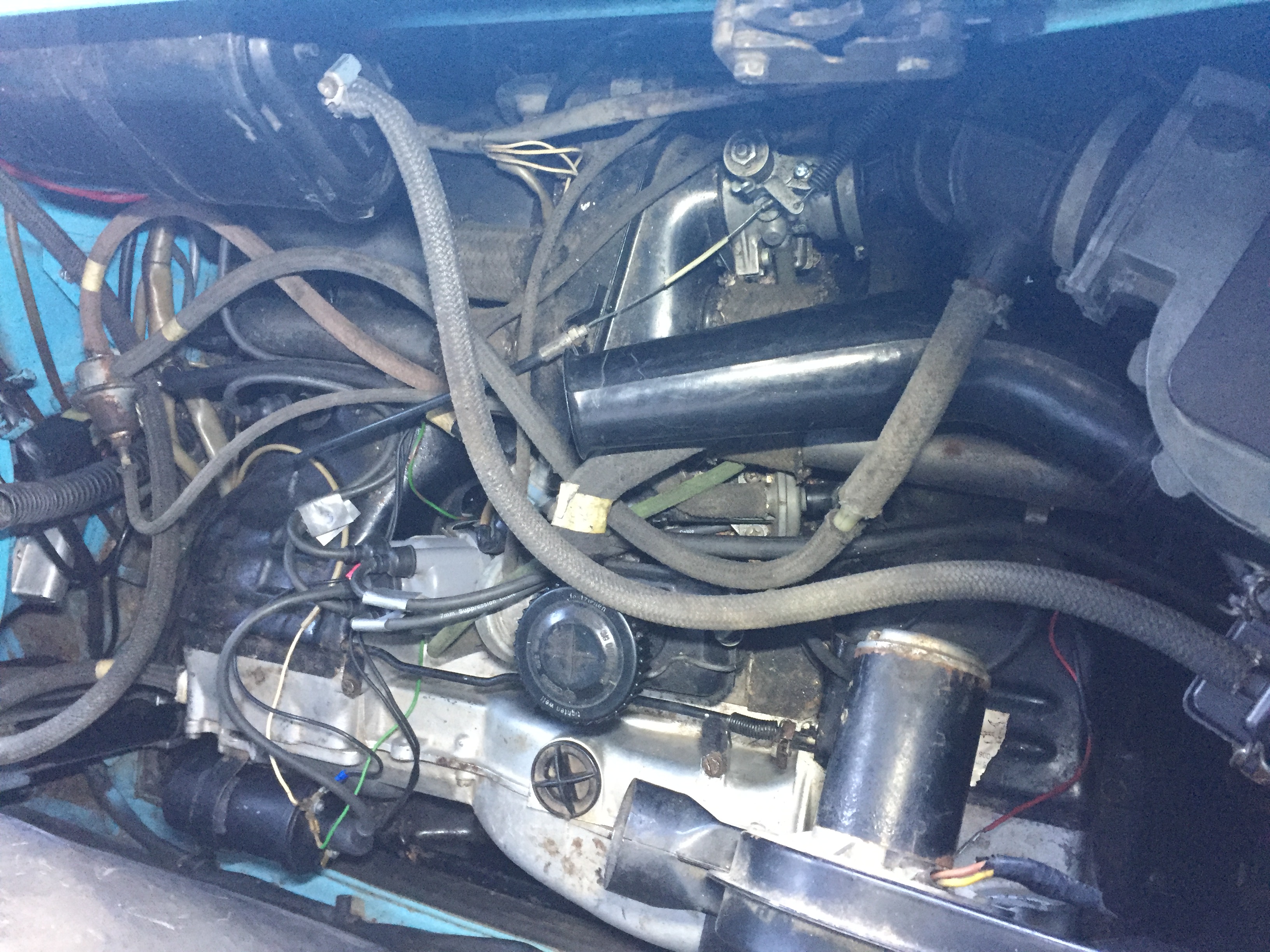

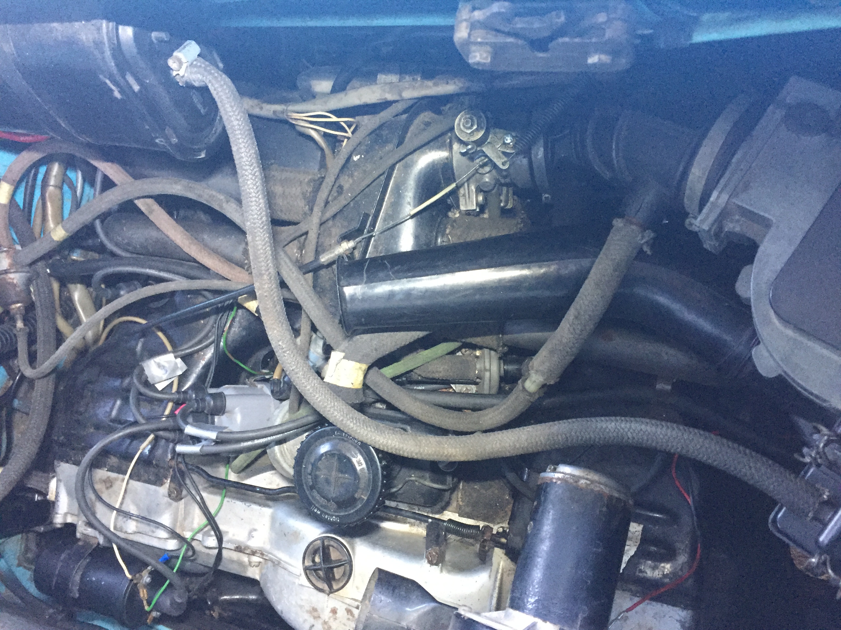

timothy_nd28
Can you post a picture of your engine bay?

ricardo
QUOTE(timothy_nd28 @ Nov 17 2016, 10:17 PM) *
Here is some picturesClick to view attachment Click to view attachment
