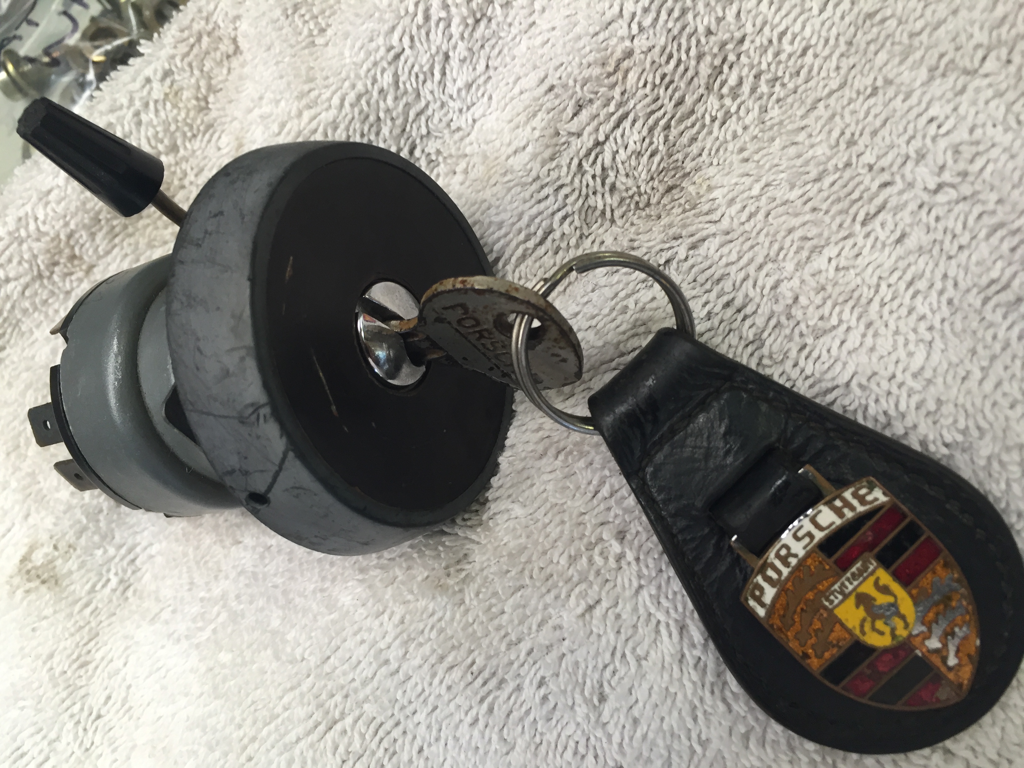

I found this older 911 switch and thought it might work?

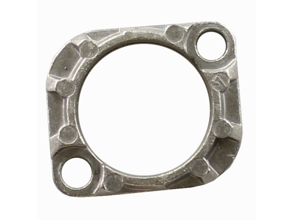

Dash escutcheon picture. Apparently AutoAtlanta already makes a typically crappy reproduction.

QUOTE(Larmo63 @ Nov 26 2016, 10:06 AM) *
Will that lock use a regular 914 key ?

It has a Porsche key in it. I'll use that. This ignition switch also has an accessory mode which comes in handy.
It fits into a plain round hole, too. No wheel lock.

QUOTE(Larmo63 @ Nov 26 2016, 04:19 PM) *
...like the hole for the fog light switch ?

Quick question, how were you able to locate this "crappy " repro one at AA? I searched just to see and could not located a picture of that crappy one...it looks just like my OEM.

Here's the image I was looking at. The surface finish and the 'fuzzy' edges bother me. I would have to spend a couple hours making this better before I would feel comfortable using it.
(IMG:http://www.914world.com/bbs2/uploads_offsite/c767170.r70.cf2.rackcdn.com-419-1480282437.1.jpg)

Thanks for posting the "mickey " part from AA. I did see that part and thought the same when I saw it.
My apologies as I was mistaken about the part in question.

Found it; only $29.95......yikes (IMG:style_emoticons/default/blink.gif)
