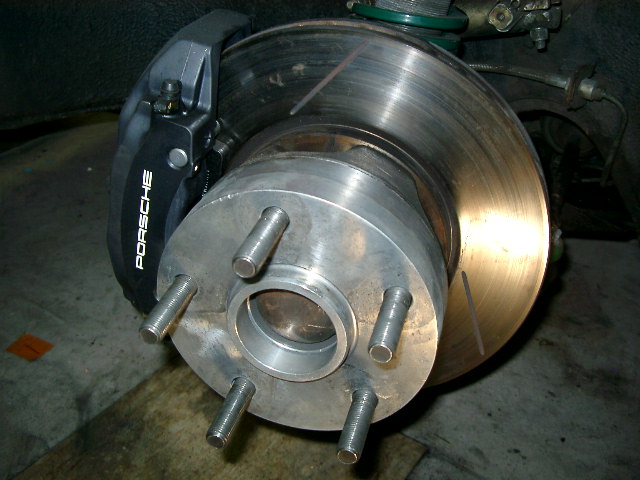

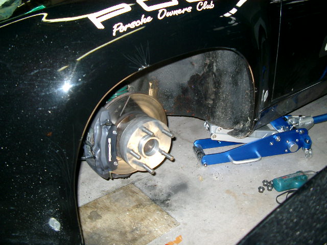

In between watching the crummy coverage on CBS of the San Marino Grand Prix, I installed Boxster monoblock brakes on the 914.

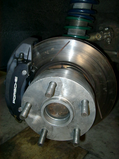

Another view.

Last one.

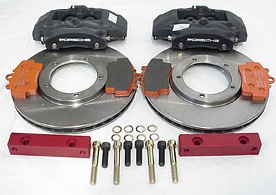

show us the adapters please (IMG:http://www.914world.com/bbs2/html/emoticons/smile.gif)

The adapters are shown in the photo. I think that they are available separtaely from Racers Edge but I bought a package from Paragon Products (talk to Jason). You wouldn't want 4 Boxster calipers - just the fronts. I am using Carerra rears.

wrong. bolt spacingss are different. boxster kit is also 1 grand.... and you need 911 3.5" struts..... so your better off going a whole 911 front suspension...

Damnation. I swear I saw some adaptors to fit a 3.5" caliper on a 3" bolt hole spacing somewhere..

Aaron's right, you need 3.5 inch spacing to fit the adapter. Early 911 struts have this. The Boxster calipers fit Carerra rotors. In Aaron' s case he already has M brakes so he has the proper spacing.
nope. M calipers are 3" spacing. same as 914 calipers.
early cars with S calipers have 3.5, and later cars with A calipers have 3.5....

The Boxster calipers work with standard 24 mm Carrera rotors.
