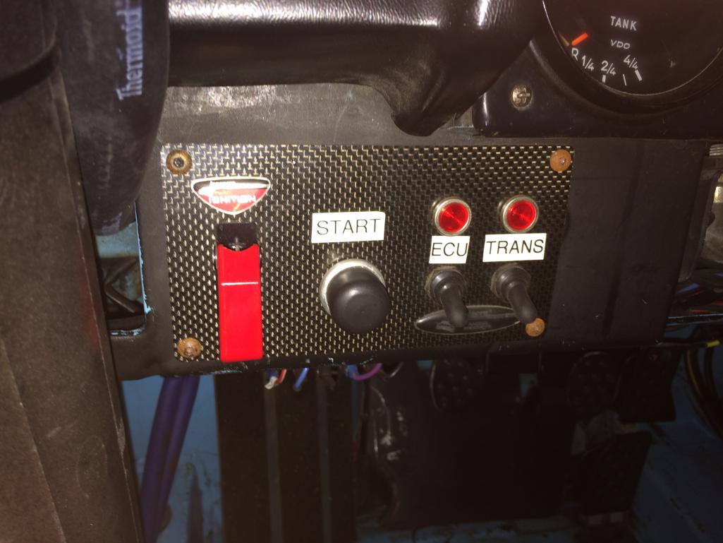

naro914
post Nov 29 2016, 07:36 PM
Post #23
Losing my mind...
Posts: 2,476
Joined: 26-May 06
From: Charlotte, NC
Member No.: 6,073
Papa Smurf has a push start and two switches: one for the starter and one for 'everything else' including the ECU. Flip starter switch, push button and develop oil pressure without ignition to prime the oil system, then flip ECU switch, start the car.
Good habit for race engines and cars that sit for a while.
(damn those screws look rusty!!)
