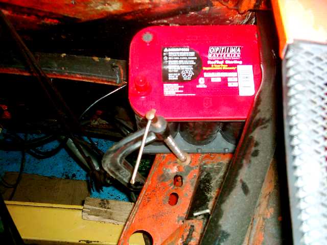

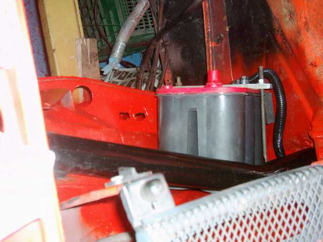

Just thought I might get some good comments or suggestions in mounting my Optium
Battery within the engine bay of my V8 project car. You will notice from the attached
photos the vehicle has a roll bar which passes through the original battery location as
well over top my "new" suggested location.
Does anyone have any pictures of their V8 project car showing if there is sufficent room
around this area; which may be needed to remove the battery for replacement. Can I
actually remove it once the V8 is installed. Since I am a little while from installing the
engine just wanted to know if anyone has previously used this location or the original
location successfully ? I understand the Optium battery can be mounted just about
anywhere and seeing that I am trying to retain some luggage storage space I thought
this might work ok.
Any comments, replies or suggestions are appreciated. Thanks from Toronto
Allan

Top view
ajracer
post Apr 24 2005, 06:43 PM
Posts: 204
Joined: 18-April 04
From: Toronto, Canada
Member No.: 1,945
Another view

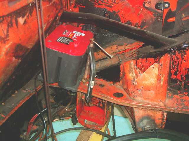

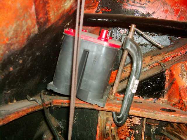

post Apr 29 2005, 07:23 PM
914 Freak!
Posts: 19,148
Joined: 23-December 02
Member No.: 8
Flip the battery over on its side facing us in the pics. See if it will fit under that bar facing the drivers side. Otherwise.. I have done the sunken battery box like Clay mentioned (and used a smaller battery)
B
ajracer
post May 2 2005, 08:47 PM
Posts: 204
Joined: 18-April 04
Member No.: 1,945
Brad:
Thanks for the simple yet great idea; I tried it and fits well, now I just
need to fab a bracket and hold down strap. Thanks again. All the Best
Allan

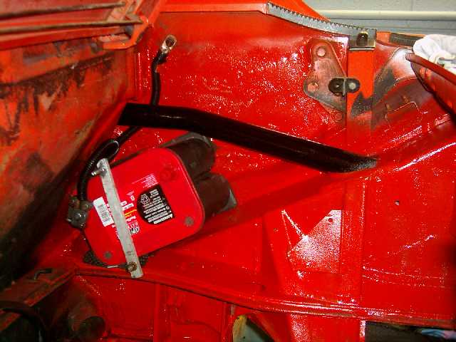

ajracer
post May 23 2005, 09:20 PM
Posts: 204
Joined: 18-April 04
Member No.: 1,945
Thanks BRAD;; greatly appreciate the common sense; I usually am pretty good
with that stuff, but just drew a blank when I was working on the mounting and
battery set-up.
Check out my pictures and provide any comments accordingly. Thanks again
everyone for your input.
Be sure to look over my progress under the "Project 914-LT1" things are starting
to take shape and hope to actually be cruising the streets of Toronto this summer.
Allan
ajracer
Posts: 204
Joined: 18-April 04
Member No.: 1,945
top view; sorry I should have rotated 90 deg. but a least you get the idea,
there appears to be lots of room.
