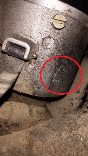

I was able to get the numbers off mine by sticking a cell phone down beside it and taking pictures. Mine ended up being aftermarket, so I don't know if the stock distributor would be the same.

Does this help?
