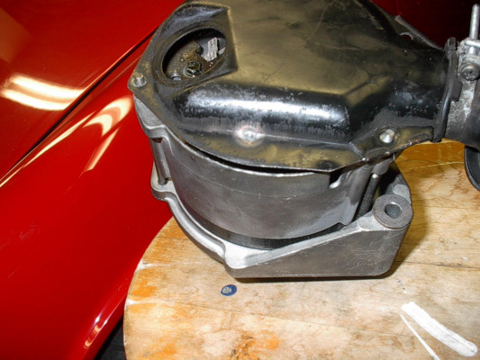

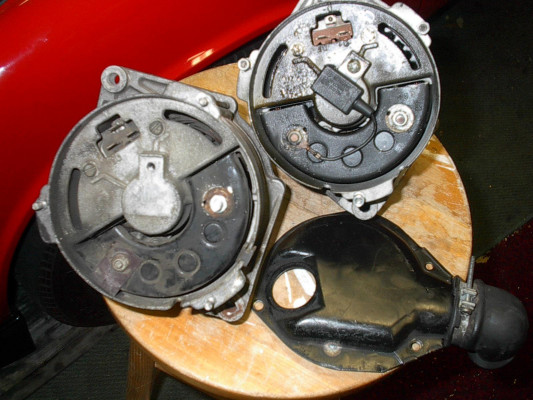

Oh my gosh! That's exactly what happened. The washer under the black wire, grounded to the cover. It looks like somebody took to it with an arc welder. Go to my picturetrail site and check it out. If someone can post the picture, I would appreciate it.
http://www.picturetrail.com/gallery/view?p...2754&uid=598455
The alternator on the top is the brand new Bosch unit. The bottom one is the old unit. You can see that there is a new black box with a wire coming out of it. That wire is connected to another post with a washer and screw. The washer contacted the cover. You can see on the cover picture, it dang near burned thru. The alternator harness is toast. A warning should come in every Bosch Alternator box about this.
Everyone in Hell prolly has to remove a 914 alternator, with the engine in the car, once a day. What a PITA. I bet it's a whole lot of fun putting it back in.
