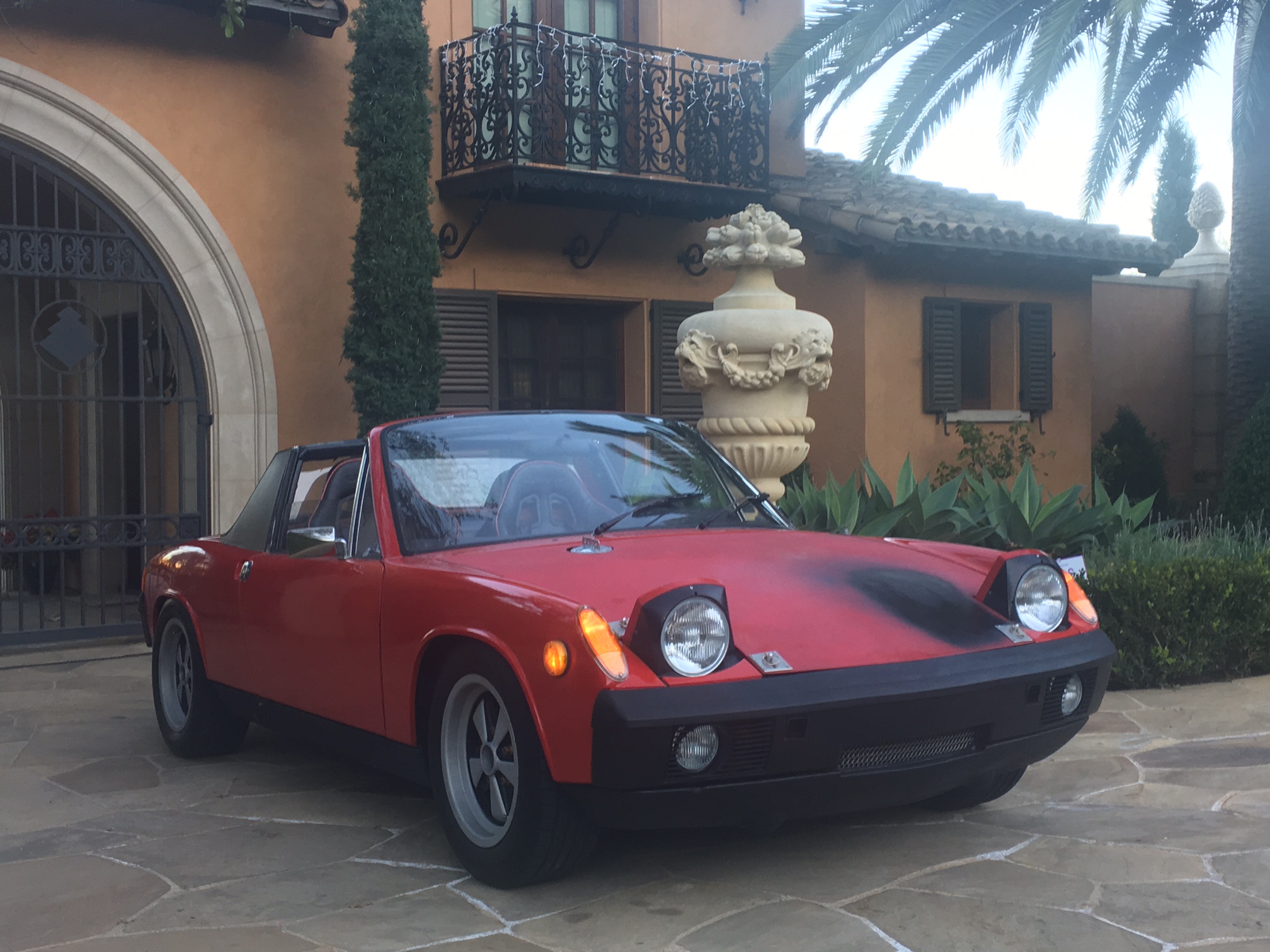

VIN tags look all wrong. No pictures of the VIN in the front trunk. Porsche/Karmann never stamped their numbers that straight. The tags don't look OE. The door jamb sticker is obviously a reproduction.

For 110k you get kybs and a tub that needs bodywork and paint. I think this car will languish for awhile.

Wow those are some awful looking attempts at reproduction tags. If the car is even for real what idiot had them replaced?

Is that the correct speedometer?

How about those rear wheel arches. They look a little too round.

QUOTE(flyer86d @ Dec 19 2016, 11:15 AM) *
I agree. Those fenders look rolled.
