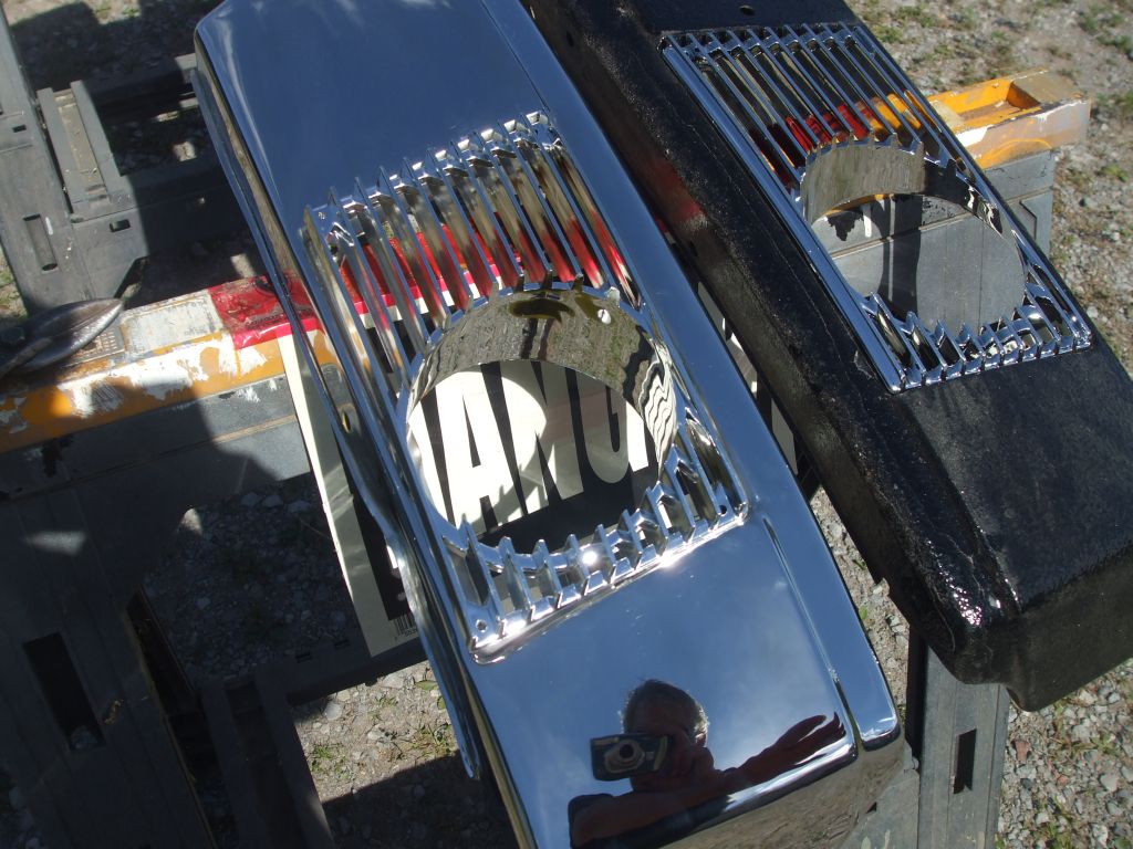

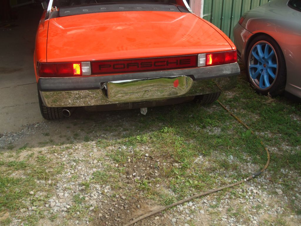

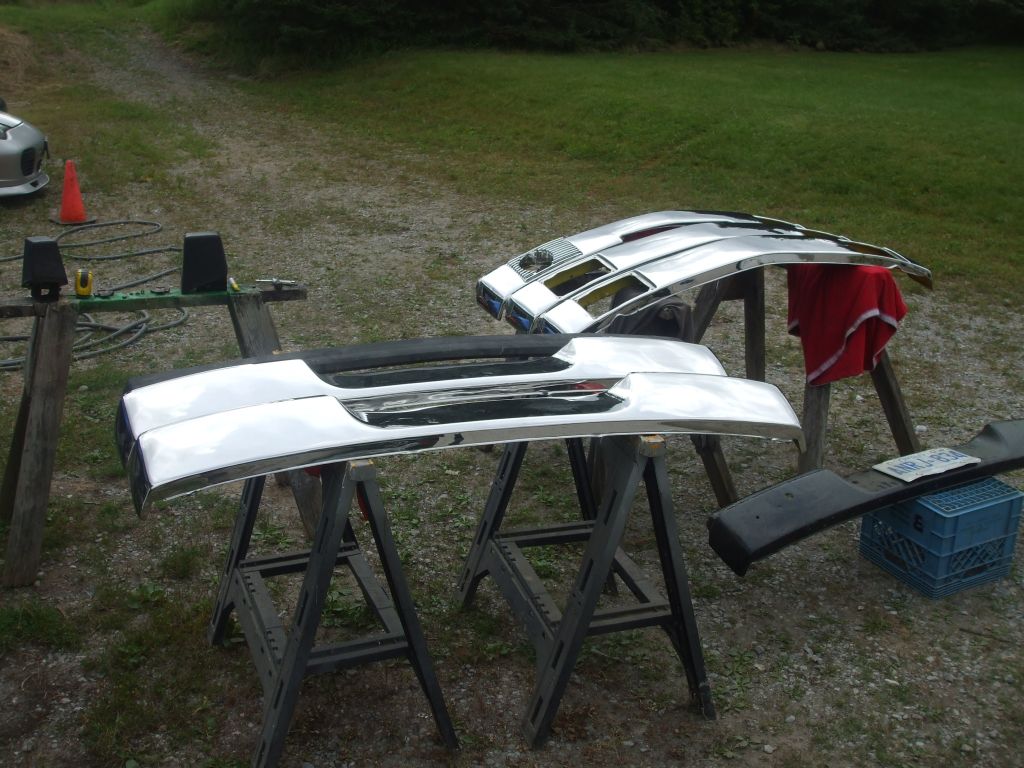

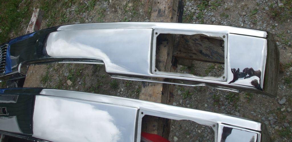

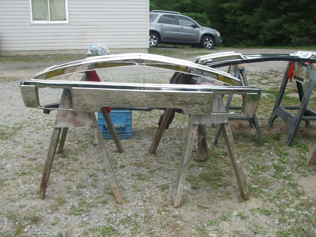

OK, first sorry this is taking so long.
Samples are here, 3 sets, but it's going to take me till the end of the weekend to do all the QC checks.
I have to work at the jobs that put food on the table and my 996 engine program is consuming most of my time.
Overall pretty good, but I'm finding numerous small issues that need to be corrected before they are ready for prime time.
These include things like the opening for fog grills is not cut out enough for the grill to sit down correctly and grill mount holes are off slightly. The one rear the brackets are about 1/8" proud, might be able to correct this one by trimming the dogbone steel insert a bit, but I again want this corrected.
They went and frick'n welded nuts to the inside front bumper brackets. (IMG:style_emoticons/default/rolleyes.gif)
There's a few more things but let me scope them totally out first.
All these things need to be corrected.
From a visual check the GT bumper looks outstanding. (IMG:style_emoticons/default/piratenanner.gif)
I was hoping that I could drop ship to some who wanted no options or only GT (option E), as it would save on the 2nd shipping from Canada cost, but I really don't think that's a good plan.
I think I should QC every bumper, also I think I'm going to demand a 20% holdback from the manufacturer till they pass QC.
I was also hoping to sell a couple of these sets to recoup some cash, I might be able to soon, but these ones need work on this end which I wasn't planing on.
So progress, but it's slow going.

Mark,
Thanks for the update. No rush at this point, better to get it right after all your work so far!
The GT bumper looks awesome by the way!!
