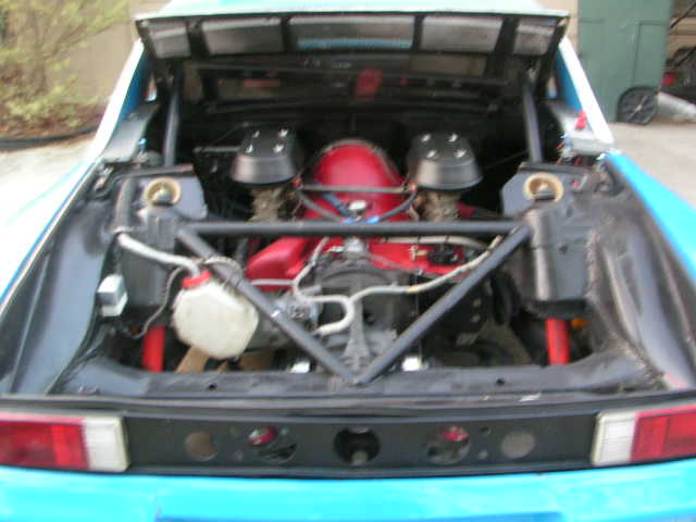

This stylish number on the left is plastic & started life as a mixed nuts container. Inside is a breather to knock down vapor & under the lid is a half inch of foam for the same purpose.....bunch of holes drilled in the lid to vent. We are not all hooked back up yet.....but I'm workin' on it.
It stayed dry in normal usage but caught 6-8 oz at AXs.

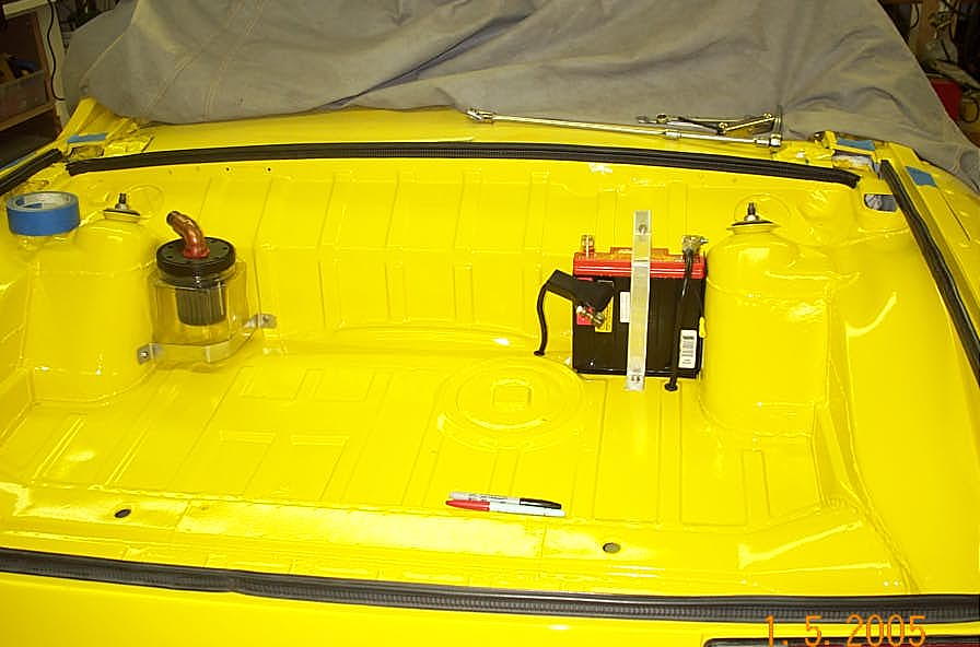

Here is a JAZ breather bottle I found on ebay. These have a filter and a drain at the bottom of the bottle.
http://cgi.ebay.com/ebaymotors/ws/eBayISAP...5&category=6763
