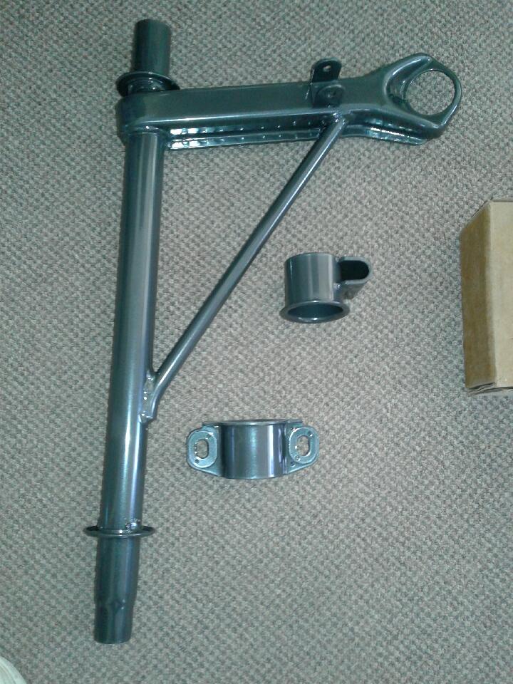

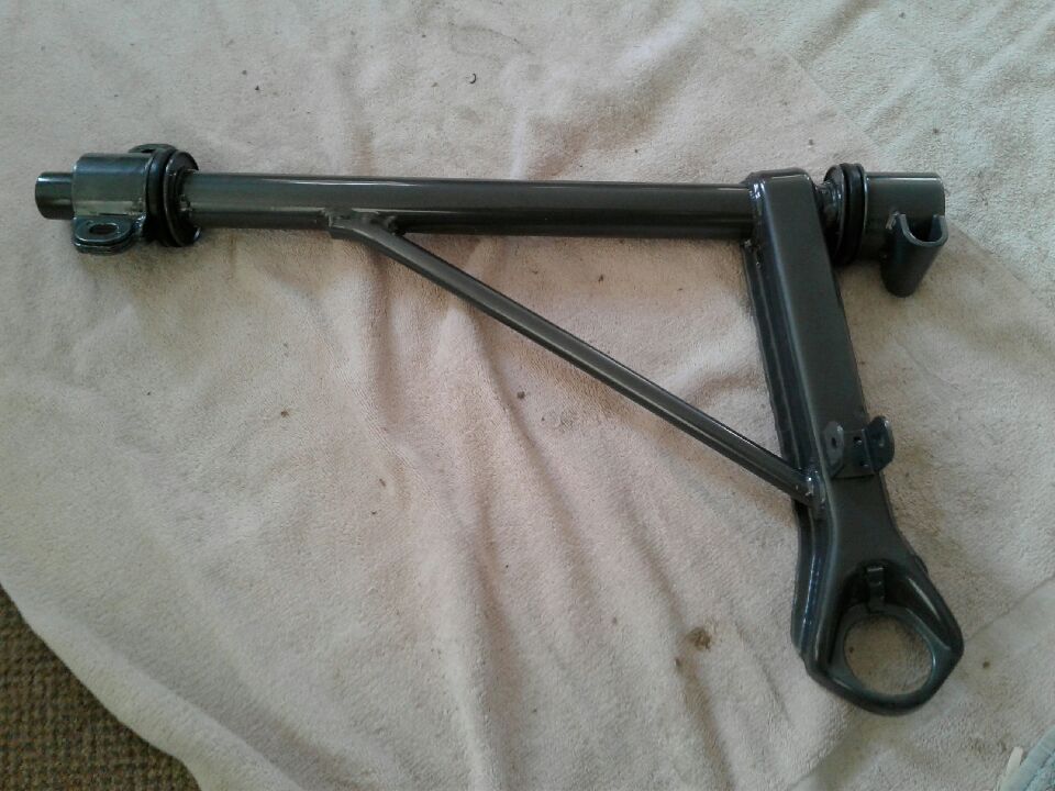

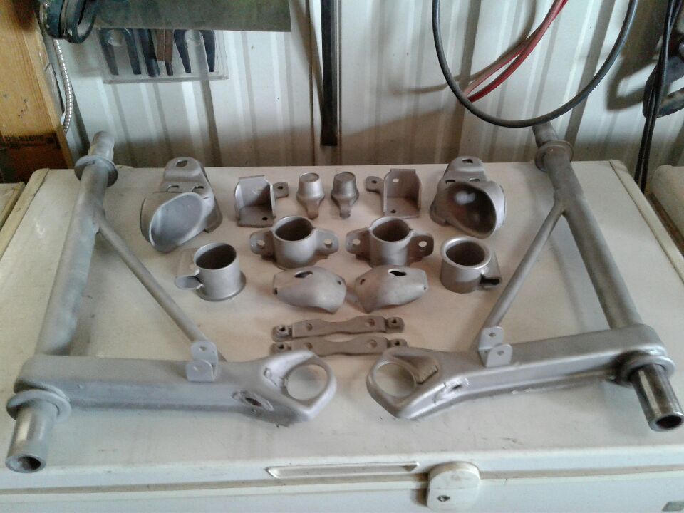

So I liked the look that 914 Teener had. The dark Charcoal just looked sharp. So I went to my local Powder Coating shop, Platinum Powder Coating, in Colorado Springs. The folks there were very helpful and I chose a dark Charcoal with fine metal flake in it. They coated 16 parts and the price was more than reasonable. I did blast the parts which saved me about 25% on the cost.
After Blasting
Powder Coated
And thanks to Elephant Racing it is now going back together.
Now I have to decide on the color of the strut housings, I am thinking Red or Yellow....They are Konis,. Any Ideas?

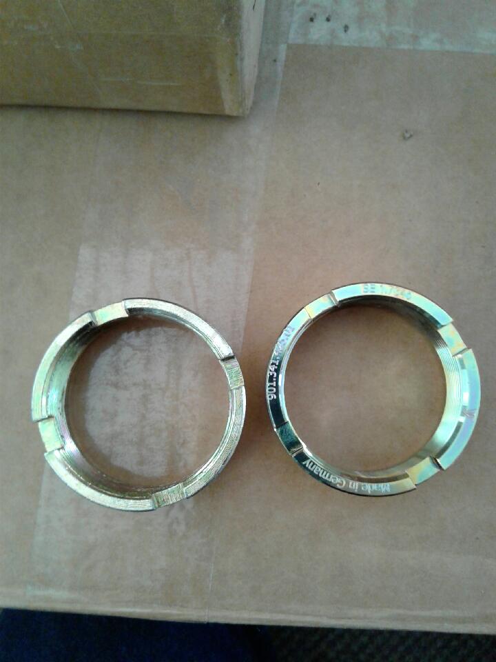

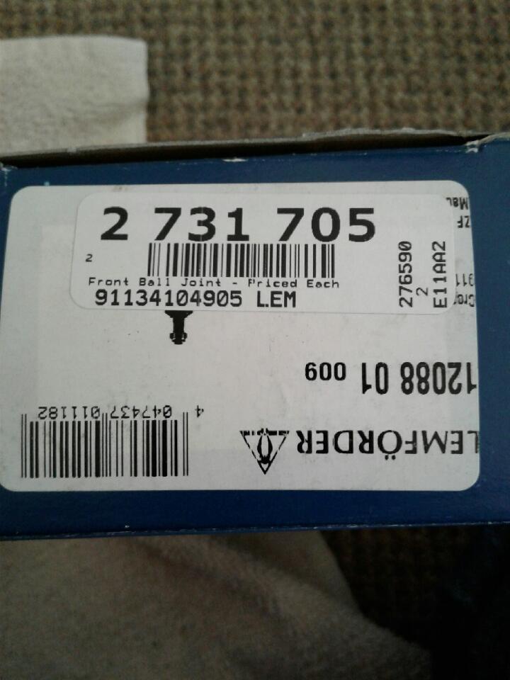

(IMG:style_emoticons/default/ar15.gif) So pissed off, my Lemforder ball joints came in so I was going to mount them in the arms.....the damn nuts that go on will only thread part way. The nuts that came off the old ball joints (original Porsche) thread all the way on so it isn't the new ball joints, problem is with the new ring nuts, I would send them back but I cant friggin remember where I bought the damn things.....Just broke down and ordered the damn things from Porsche, pretty expensive but pretty damn sure they will fit properly. (IMG:style_emoticons/default/sheeplove.gif)

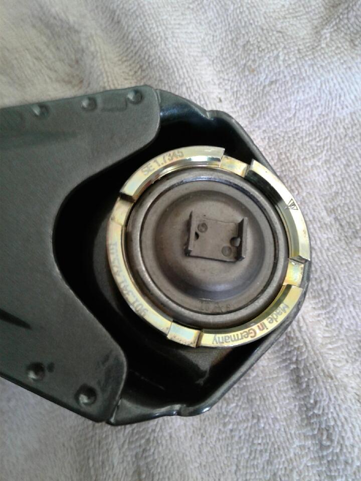

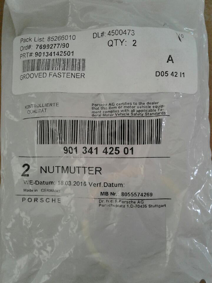

So I finally got all of the parts to re-assemble the control arms
The Lemforders are here

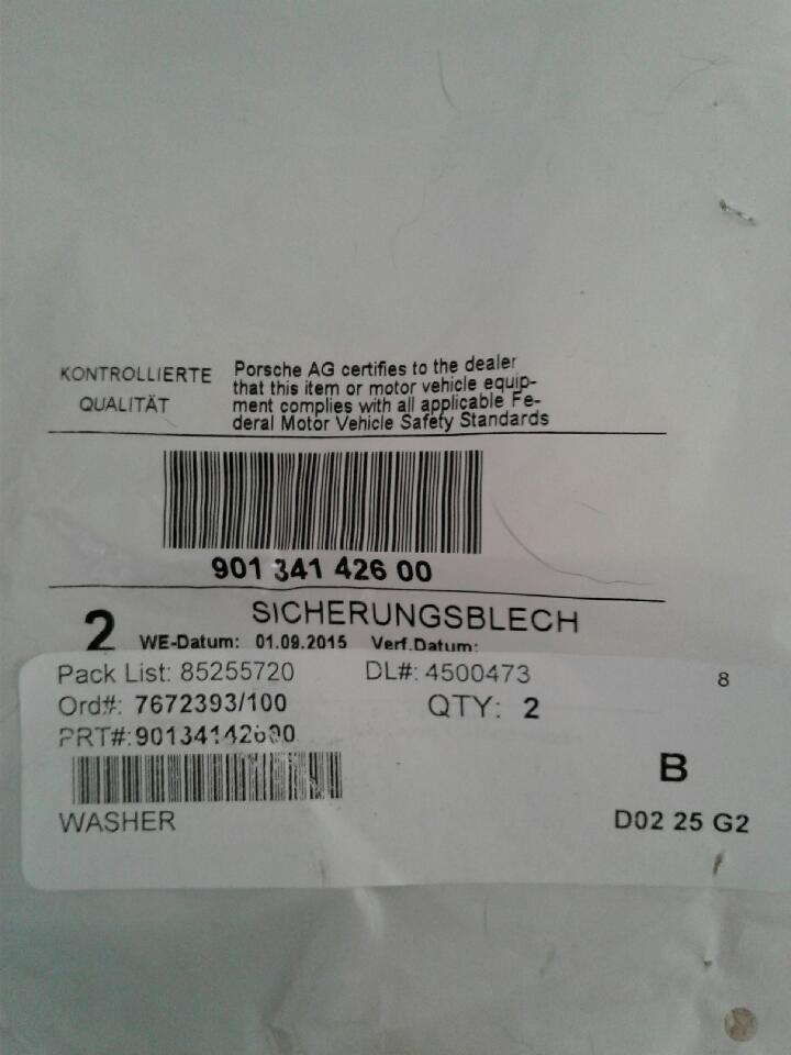

And here are the ball joint fasteners and washers....from Porsche... a tad on the pricey side but you cant beat the quality...Besides, I like the German Writing
Attached ImageAttached Image
As you can see the quality of the Porsche part (on the right) far outshines the POS part that I cannot remember where I purchased it...In fact they are so proud of what they manufacture, they engrave it....

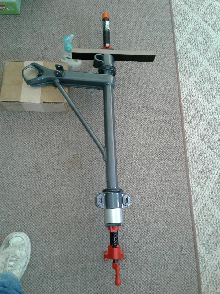

And here it is installed, torqing these to 180 lbs by yourself is a bitch, wish I had the jig
So now I just have to put the lock washers on and the cotter pins in and they are done.
