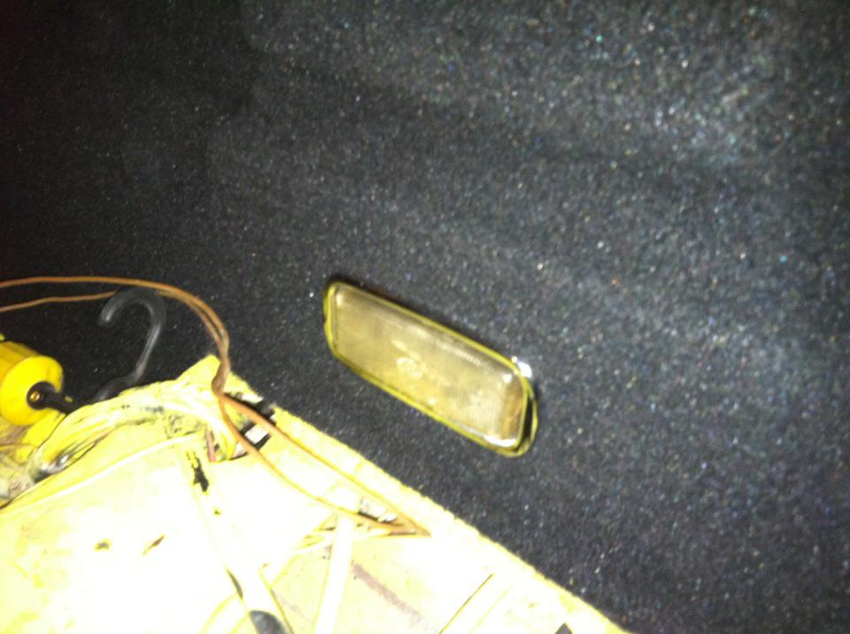

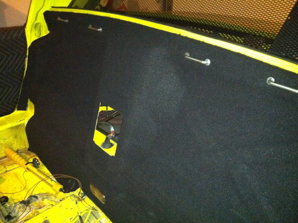

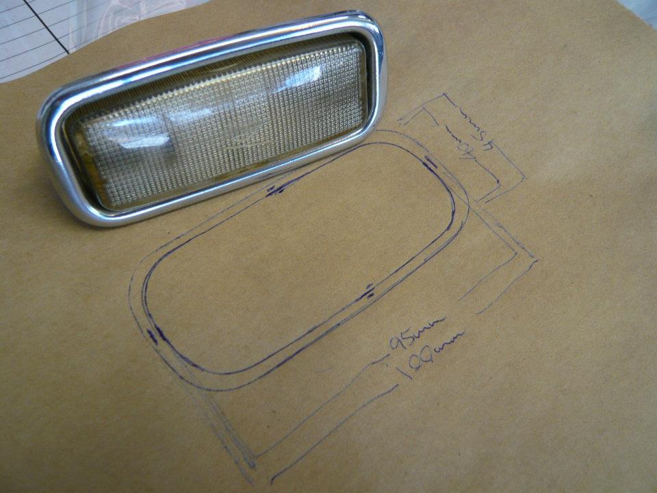

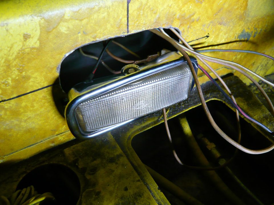

QUOTE(Dave_Darling @ Feb 9 2017, 09:40 AM) *
People have run the original wires under carpeting that replaced the back-pad, then mounted a different interior light directly on the firewall in roughly the original location.
I run 911 interior lights at the base between the two seats because the original higher location isn't double walled so, no real way to mount unless it's a base mount light.
Done this on a few cars with great factory look results...
(IMG:http://www.914world.com/bbs2/uploads_offsite/www.sierramadrecollection.com-1110-1486691246.1.jpg)
Here's some install shots...
