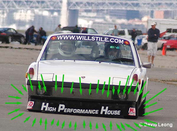

get rid of the snow-plow so your brakes get some cooling air !!!

vented brakes only work IF they get airflow. his airdam is sweeping the pebbles from the track, there is *no* airflow under his car, there's no way to get air through vented rotors with this setup.
trek, the solution is MUCH cheaper than all that was suggested above, simple *remove* the air-dam ...
(IMG:http://www.914world.com/bbs2/html/emoticons/biggrin.gif) Andy

i added a green arrow to show you your real problem ...
(IMG:http://www.914world.com/bbs2/html/emoticons/wink.gif) Andy
