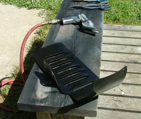

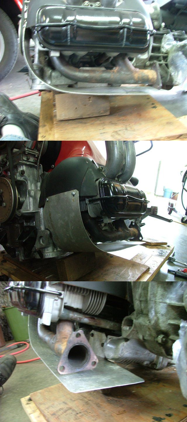

My engine shroud blows the air straight down and blows dust everywhere, so I want to try these baffles I made up to blow it out my rear.
Can anyone see a reason why this would be a bad thing?

don't have any personal experience.
and don't want to sound negative either...
but off the top of my head, I would think that the shroud would increase motor temps (oil and head) because it would radiate heat back and because it would prevent some heat from escaping...
again, don't take this negative and maybe temp isn't an issue for you. Nice fab work though!

maybe drill some holes in it or add some louvres(?) so it's more like a diffuser than a
shield.

Stock air guides won't fit this shroud, so I'll try these, but keep a close eye on the temps.

QUOTE (brant @ May 5 2005, 10:01 AM)
(IMG:http://www.914world.com/bbs2/html/emoticons/agree.gif) moving air under the engine helps with cooling, that's why the factory added the "flaps" to the lower firewall in later years ...
you'll probably see higher oil temps ...

I think I'll take Mattillac's suggestion and put some louvers in the baffles. I think that will minimize any radiant heat created. I'll also paint them flat black.

I've modified the tins....Added louvers, and cut a wider opening in the front......Thanks for the tips guys.

Ya didn't waste any time. Looks good, hope it works for you... (IMG:http://www.914world.com/bbs2/html/emoticons/smilie_pokal.gif)

QUOTE (Pugbug @ May 5 2005, 10:47 AM)
Looks great. With your fab skills, I think it would be easy to make some tins that replicated the factory ones in function. Right now, your cooling air is cooling the top of your engine well, but it is missing the hottest parts of the heads and cylinders: the bottoms. If you can channel the air around those bottom-side curves a little (like the factory did) I think you will run much cooler. At least your temps would be more even, which is as important. I wouldn't use the stock type 4 bottom tin though. A type 1-style bottom tin would do (basically a flat plate under the "cleavage" between the two cylinder barrels.)

From: Burford, ON, N0E 1A0
Member No.: 1,244
It appears you are missing the lower air guides. This may cause uneven cylinder cooling and that may be a bad thing. What I'm thinking of is that the bottoms of the cylinders will run much hotter since the airflow bypasses them. This could cause the running cylinders to be slightly out of round.
