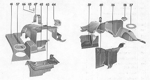

I was referring to part numbers 59, 60, 62 and 63 on this diagram.

Also, with an upright cooling system like that, it may cool better with the type 1 bottom tins than the type 4 tins.

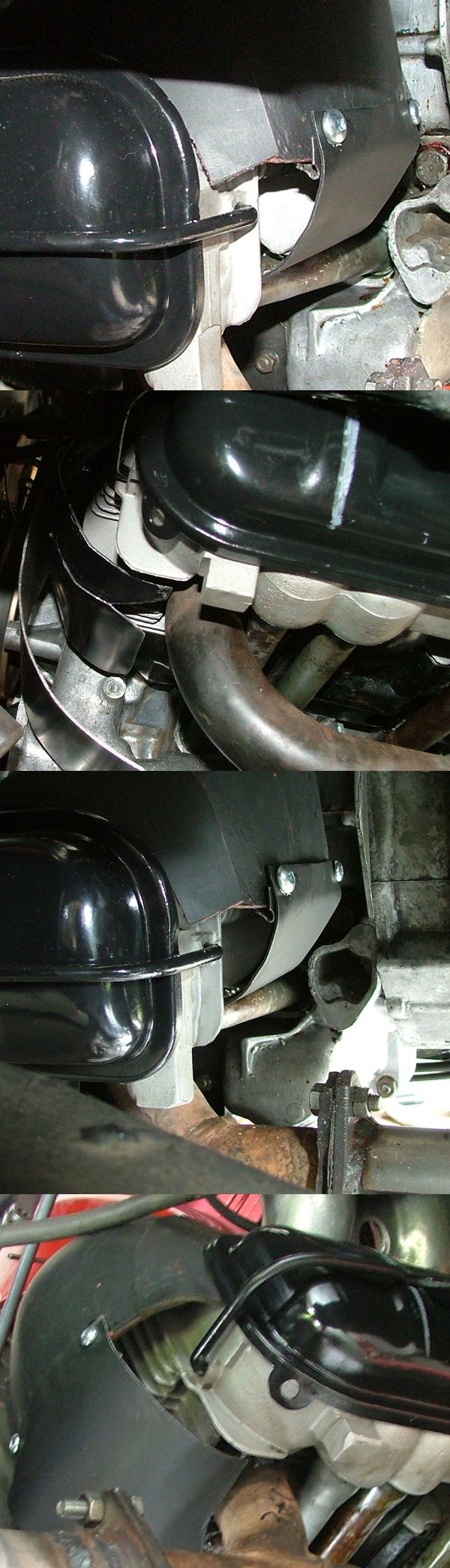

Update...I've made up air guides for the shroud since the stock ones won't fit, and you guys got me all worried!
Tell me what you think.

Well done. I think that will work much better for cooling. If not, you could trim the ends of those new baffles until it does. Do you have a CHT gauge? Keep us posted.
Your dust problem should be solved too.

Those head pipes are from a 75-77 Bus.... The rest of the system is pure junk..
The Bus head pipes will work and are the same as the 914 right up till August of 1978 when the heads on the bus changed to a square port... The 914 heads are not magical in this area..
As for the tin you have made, it should work fine.. The stock TI engine had a tin just like that and it actually helps draw air from the engine as vehicle speed and fan pressure increases...
BTW- Make sure you run a 4-1 collector with that exhaust, not duals, these engines MUST have a collecteor and the nicer it is the better! I have seen a TWENTY FIVE percent power loss when going to dual exhaust without an collector/extractor on a TIV engine!
