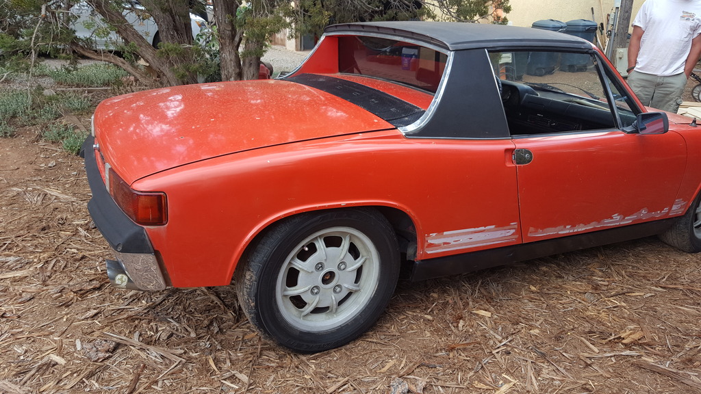

$1800 later, we towed home a mouse infested ran-when-parked 75 914. The 1.8 FI engine had been swapped out for a 1.7 with 1.8 heads and a single Weber carb, and the impact bumpers had been backdated to chrome bumpers. Mars Red with Mahle gas burners!
(IMG:http://www.914world.com/bbs2/uploads_offsite/i1322.photobucket.com-20880-1490063977.3.jpg)

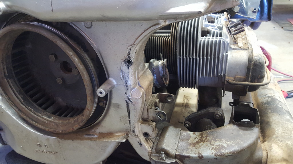

It had been parked because the previous owner thought it had developed a serious front main seal leak. We got it running with a minimum of effort and saw the significant oil leak. We impulsively dropped the motor and resealed the oil pump, suspecting that might solve the problem.
(IMG:http://www.914world.com/bbs2/uploads_offsite/i1322.photobucket.com-20880-1490063978.4.jpg)

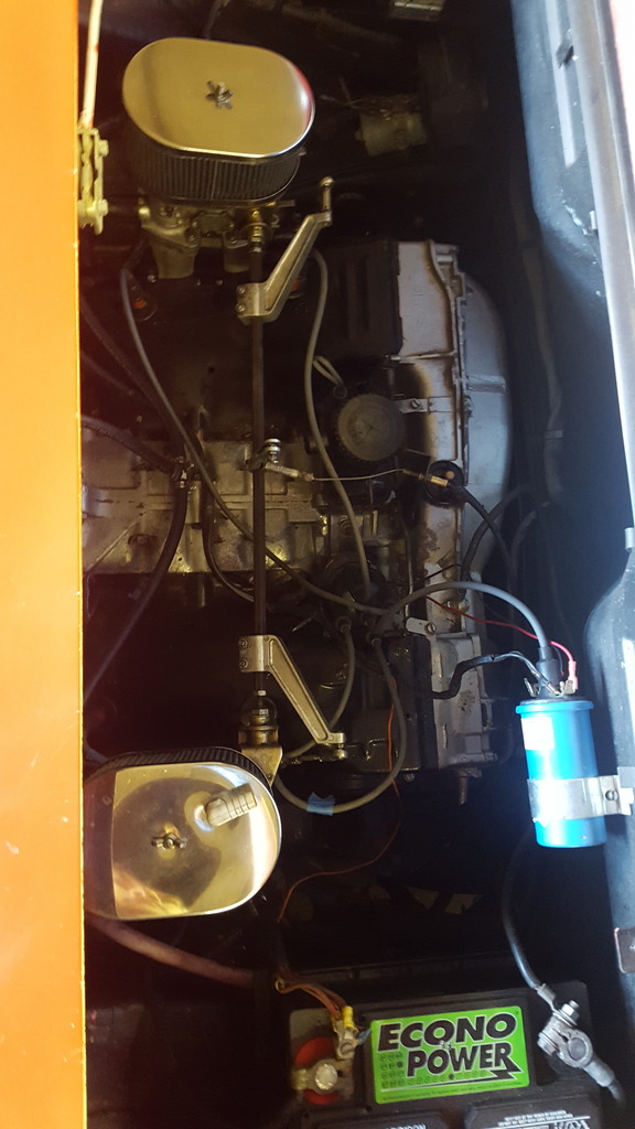

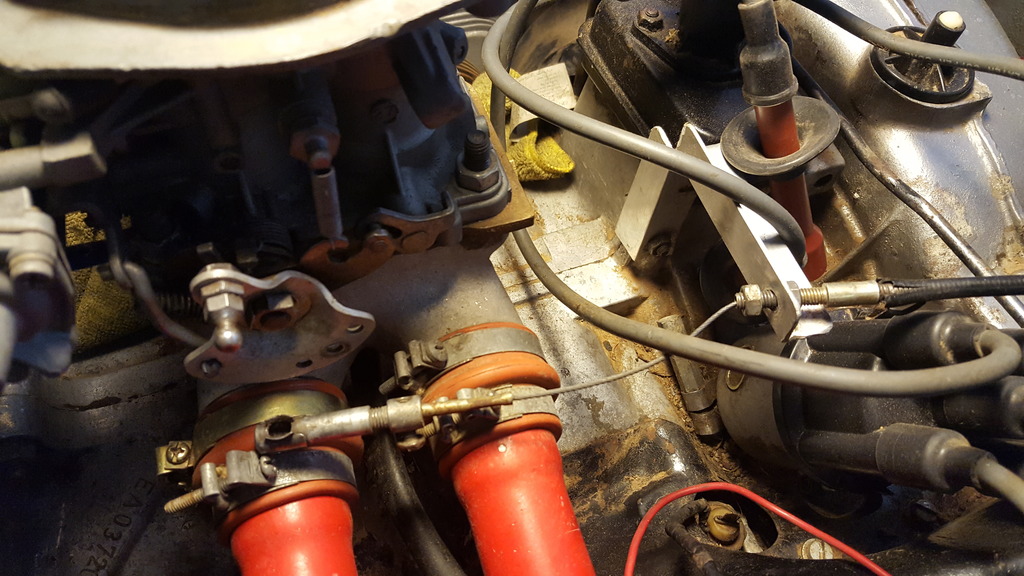

Motor back in, along with a dual Weber setup we came across, it seemed like the leak was fixed. But it was running so badly, we couldn't really drive it. Since my brother was working part time at a Ferrari shop that primarily builds vintage motors, we were able to get the carbs rebuilt for cheap by the excellent Ferrari mechanic.
(IMG:http://www.914world.com/bbs2/uploads_offsite/i1322.photobucket.com-20880-1490063978.5.jpg)

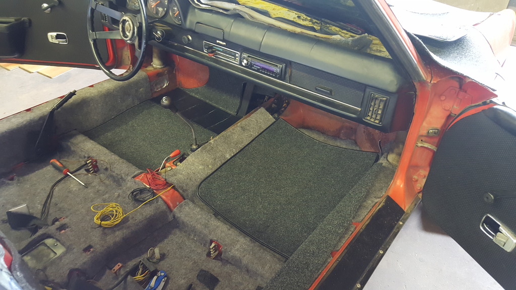

The interior really wasn't bad, thanks to some reupholstered seats in black vinyl with corduroy centers. The carpet was nice, but because of the mouse problem, it had to be trashed. Out came the interior, a bunch of scrubbing and deodorizing (not entirely effective), and a new carpet kit went in.
(IMG:http://www.914world.com/bbs2/uploads_offsite/i1322.photobucket.com-20880-1490066034.1.jpg)
(IMG:http://www.914world.com/bbs2/uploads_offsite/i1322.photobucket.com-20880-1490066034.2.jpg)

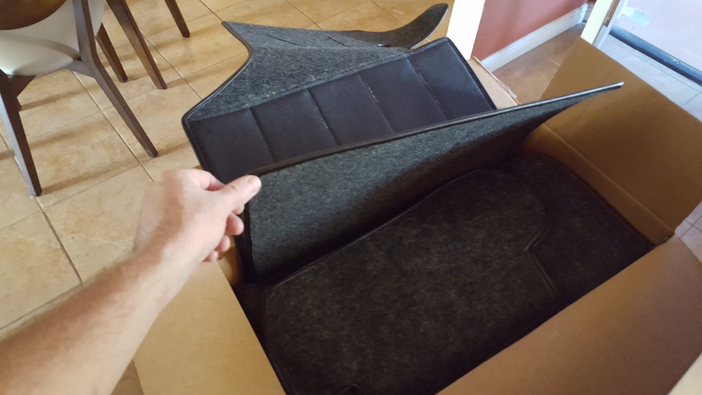

It will get a molded dash cover soon to cover up that cracked dash. A leather wrap with thicken up the factory wheel.

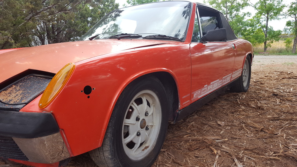

The nose of the car is a paint mess, but with pretty straight metal. The hood was painted orange (IMG:style_emoticons/default/blink.gif) at some point and looks awful. It will be smoothed out and I will wrap it in 3M 1080 Matte Black.

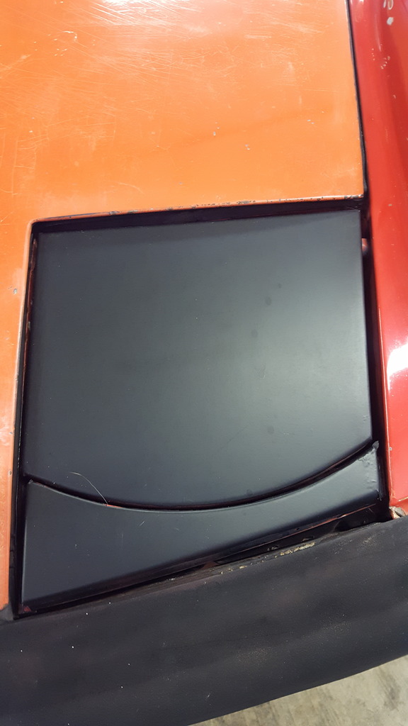

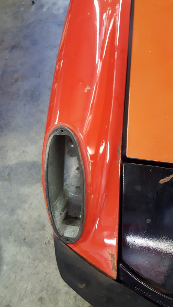

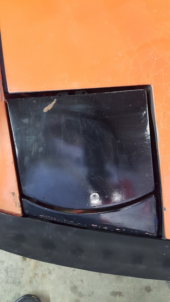

The popup headlights had been poorly painted in gloss black. They got smoothed and wrapped in the Matte Black.
(IMG:http://www.914world.com/bbs2/uploads_offsite/i1322.photobucket.com-20880-1490066035.4.jpg)
(IMG:http://www.914world.com/bbs2/uploads_offsite/i1322.photobucket.com-20880-1490066035.5.jpg)

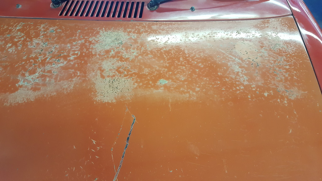

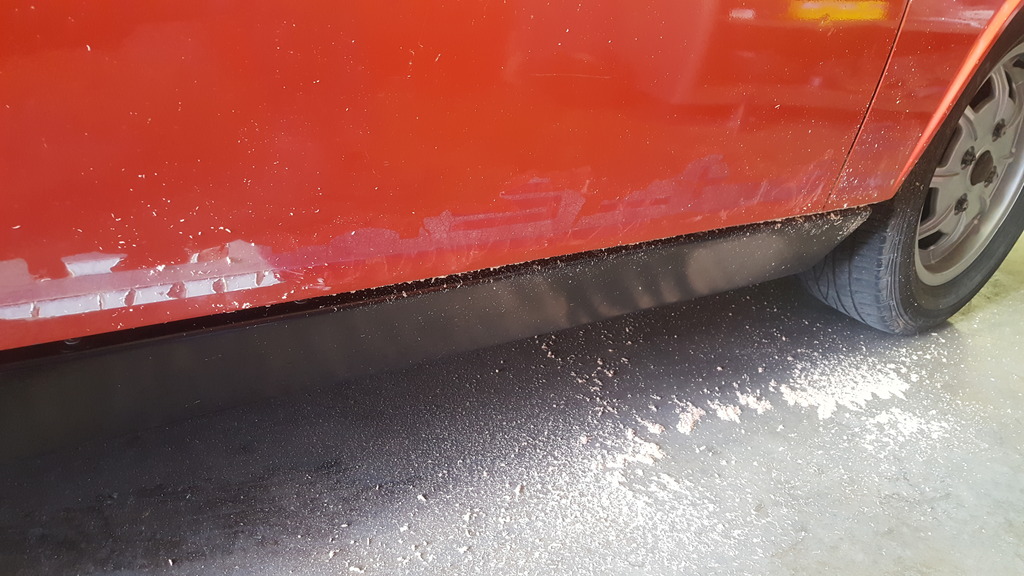

There was some orange paint overspray on the front fenders. A little wet sanding with 2000 grit removed it pretty well, followed up with some Meguires machine glaze.
(IMG:http://www.914world.com/bbs2/uploads_offsite/i1322.photobucket.com-20880-1490066035.6.jpg)
(IMG:http://www.914world.com/bbs2/uploads_offsite/i1322.photobucket.com-20880-1490066035.7.jpg)
I picked up some Mars Red touchup paint and will gradually work on the chips and scratches.

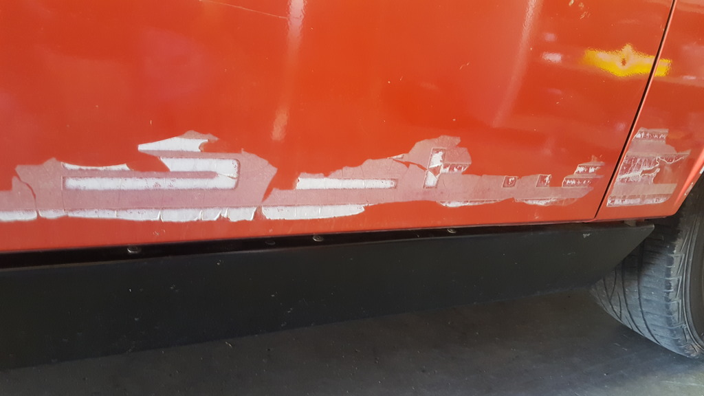

Old white Porsche script is a major eyesore, so using an eraser wheel in a drill, I went to work to prepare the area for new black Porsche script.
(IMG:http://www.914world.com/bbs2/uploads_offsite/i1322.photobucket.com-20880-1490066036.8.jpg)
(IMG:http://www.914world.com/bbs2/uploads_offsite/i1322.photobucket.com-20880-1490066036.9.jpg)

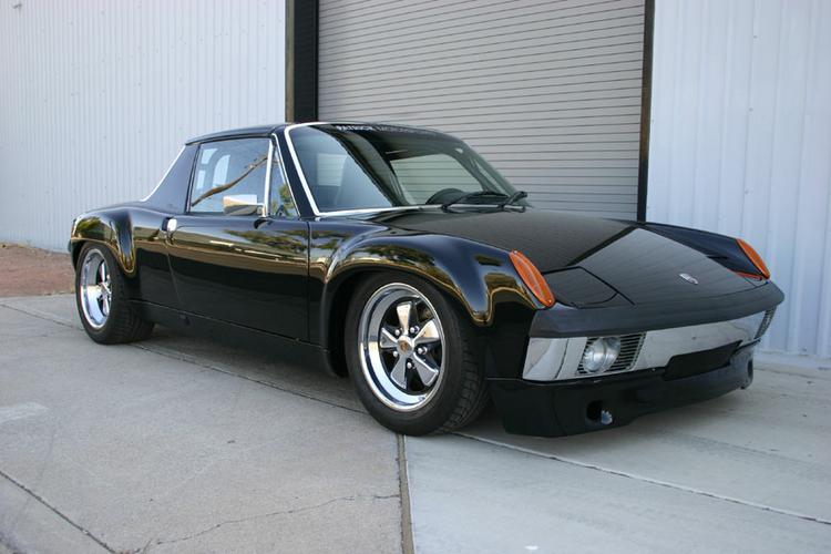

Thanks for the encouragement! The car that is serving as an inspiration right now is the Magnus Walker 914. My car will end up looking a bit like this, but all chrome, vinyl sail panels, and stock targa top will remain intact.
(IMG:http://www.914world.com/bbs2/uploads_offsite/i1322.photobucket.com-20880-1490104006.1.jpeg)
I just have to keep my sights on that, rather than my long-term dream build inspiration: Black Beauty built by Patrick Motorsports. If I ever get to that, it'll need a different thread, and a couple extra jobs!

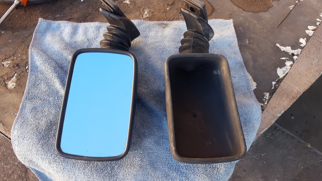

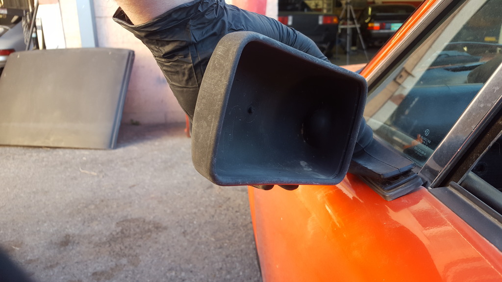

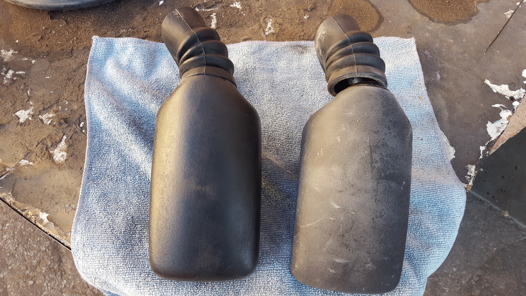

Back to the real world. When I got the car, it had Vitaloni mirrors which are okay but don't really suit the car. But that's fine for now. Since there was no mirror glass on the drivers side, I removed them both to see if they could be swapped. With a little wrangling, I managed it, so now I could at least change lanes without trying to look out that joke of a rear window. I'll see if can get a mirror cut for the other one and reinstall it.
(IMG:http://www.914world.com/bbs2/uploads_offsite/i1322.photobucket.com-20880-1490104007.3.jpg)
(IMG:http://www.914world.com/bbs2/uploads_offsite/i1322.photobucket.com-20880-1490104007.4.jpg)
A coating of Plasti-Dip helped freshen up the chaulky plastic housing.
(IMG:http://www.914world.com/bbs2/uploads_offsite/i1322.photobucket.com-20880-1490104007.5.jpg)

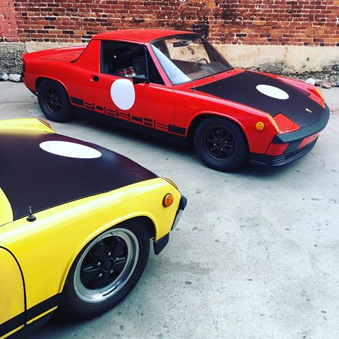

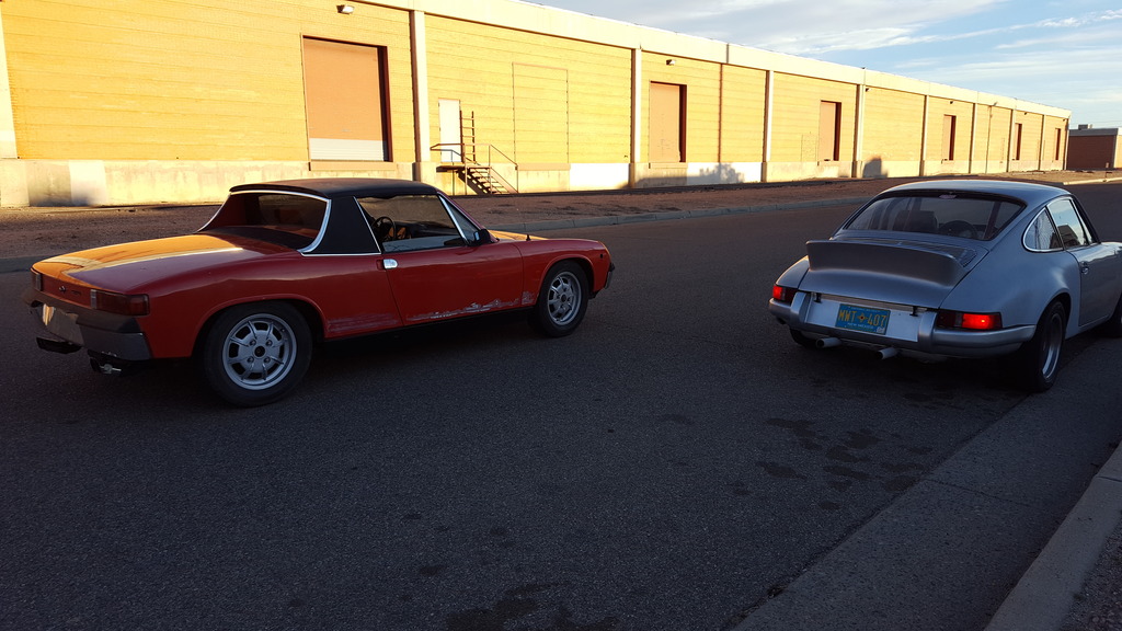

It's been awesome to take a few short drives in the industrial area by our little shop. Here's a few pics of the 914 and my brother's 911.
(IMG:http://www.914world.com/bbs2/uploads_offsite/i1322.photobucket.com-20880-1490104007.6.jpg)
(IMG:http://www.914world.com/bbs2/uploads_offsite/i1322.photobucket.com-20880-1490104008.7.jpg)
It's very cool being around these old road warriors! Hopefully soon we'll be able to get them out onto some winding mountain roads for a real drive.

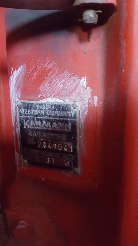

Please post a photo of the chassis plate with the paint code for us to drool over. L31B is not 914 color.

As for the paint code, I was wrong, it's L 31 M.
(IMG:http://www.914world.com/bbs2/uploads_offsite/i1322.photobucket.com-20880-1490194692.1.jpg)
When I went to a paint store to get the touch up, they couldn't find it under Porsche colors, but did find it as a Volkswagen code for Mars Red.

L31M is Scarlet Red
http://www.914world.com/bbs2/index.php?act=colors
