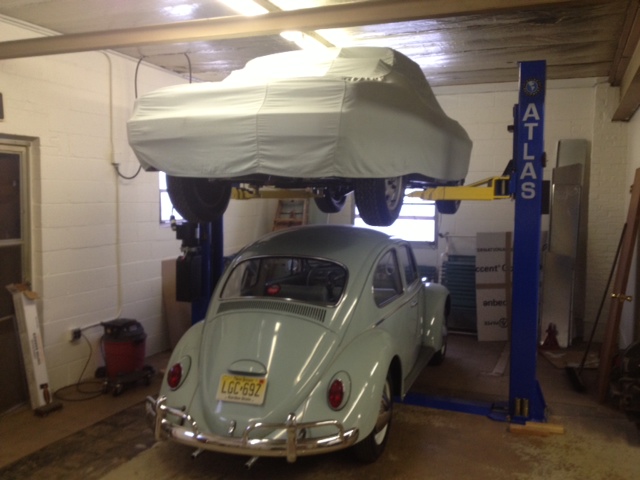

I've had a Greg Smith BP8000 for over 2 years. Works great. I bought it in Delaware and picked it up at their warehouse. No shipping charges, no sales tax. We actually picked up 2 lifts and got a discount. I installed myself with the help of 2 friends. The first one took 2 3/4 hours. The second one took just under 2 hours. You can't beat the price, and the quality is there. I had 4" of concrete and I own a Hilti hammer drill so installation was fairly straight forward.
