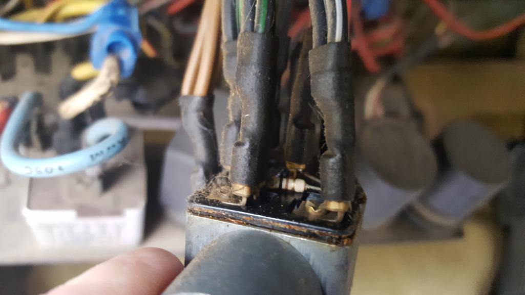

Think it was the emergency flasher that I was taking pictures of and just now, when I zoomed in, I noticed what seems to be a DIY resister. Maybe not. Looks suspect. Any ideas?

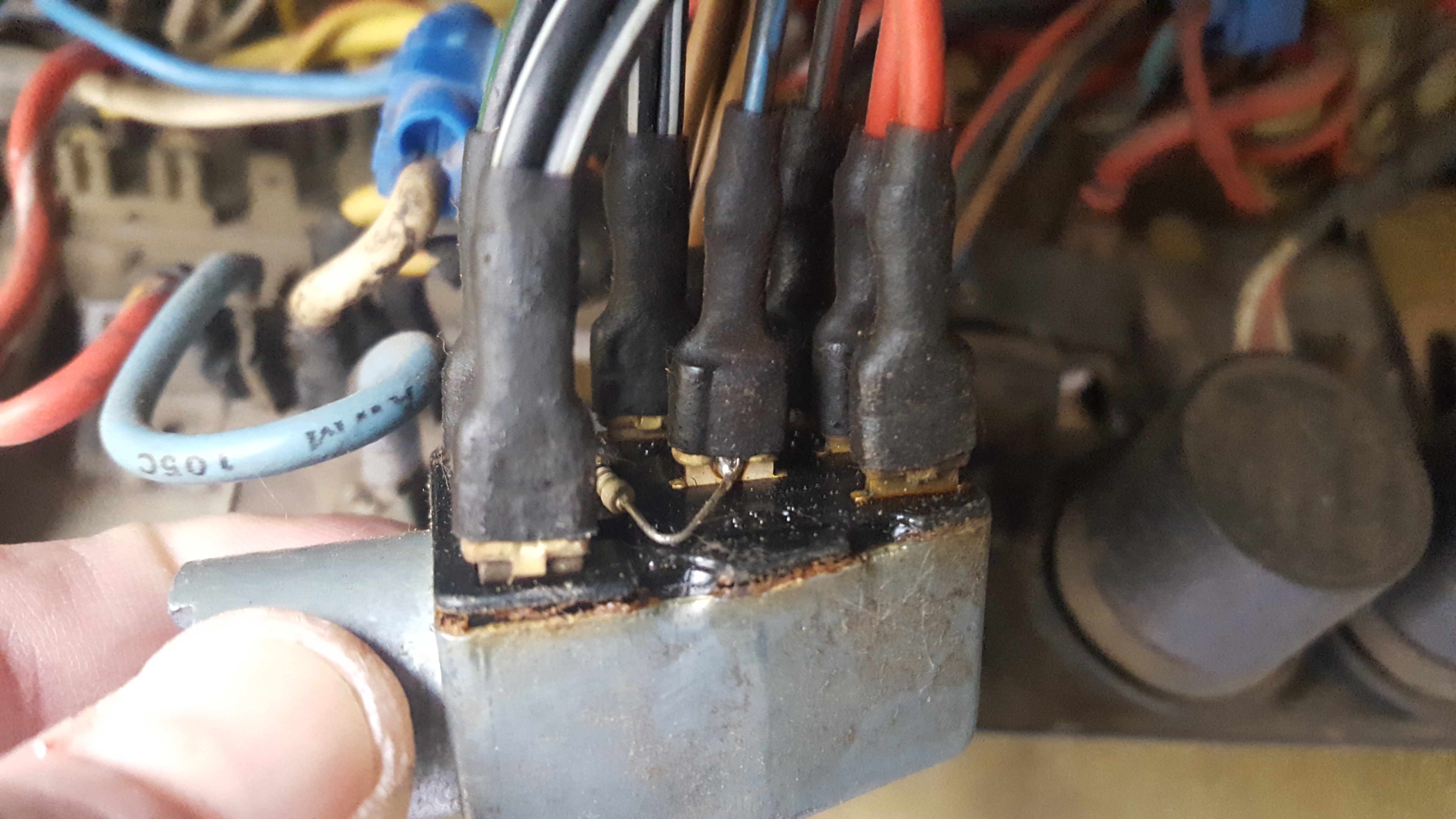

Here is a shot from the side. Doesn't look factory installed. Ideas?

I'm not sayingsing its factory, But I have seen this before.

? Possible suppression resistor ? Tom used something like that in his custom hot-start relay set up. Forgot it's purpose....

Its bone stock for the 1973-76 hazard switch.

Just a wild ass guess, but maybe that sets the flasher relay duration? (IMG:style_emoticons/default/confused24.gif)

The resistor is hooked to the instrument lighting circuit and is used to make the light in the knob glow when the lights are on.
