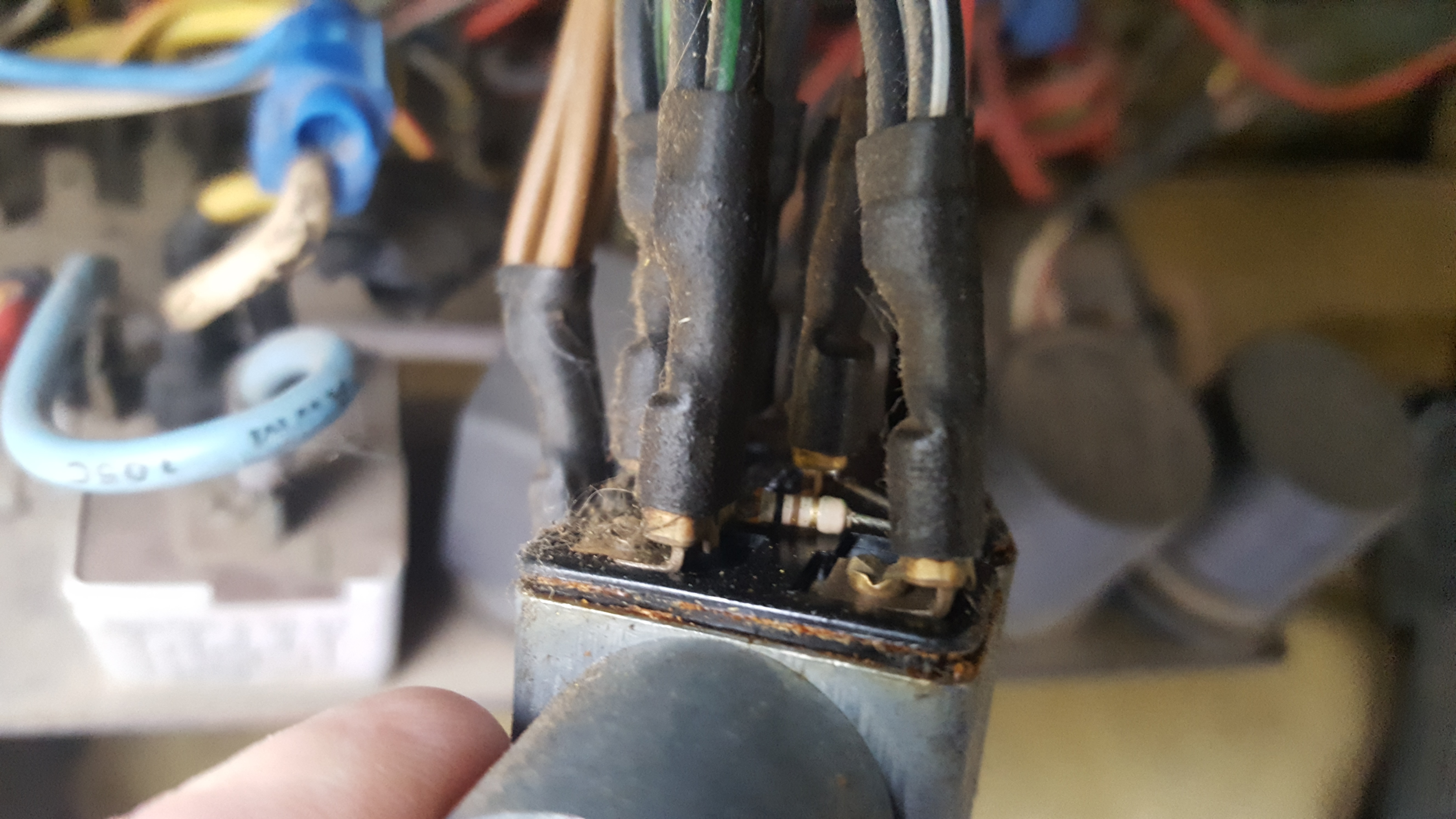

Think it was the emergency flasher that I was taking pictures of and just now, when I zoomed in, I noticed what seems to be a DIY resister. Maybe not. Looks suspect. Any ideas?
gspreeman
Mar 27 2017, 08:42 PM
Here is a shot from the side. Doesn't look factory installed. Ideas?
cgnj
Mar 27 2017, 09:02 PM
I'm not sayingsing its factory, But I have seen this before.
jim_hoyland
Mar 27 2017, 09:12 PM
? Possible suppression resistor ? Tom used something like that in his custom hot-start relay set up. Forgot it's purpose....
JeffBowlsby
Mar 27 2017, 09:17 PM
Its bone stock for the 1973-76 hazard switch.
cgnj
Mar 27 2017, 10:02 PM
Blind squirrel finds acorn film @ 11
stugray
Mar 27 2017, 11:21 PM
Just a wild ass guess, but maybe that sets the flasher relay duration?
ejm
Mar 28 2017, 06:48 AM
The resistor is hooked to the instrument lighting circuit and is used to make the light in the knob glow when the lights are on.
