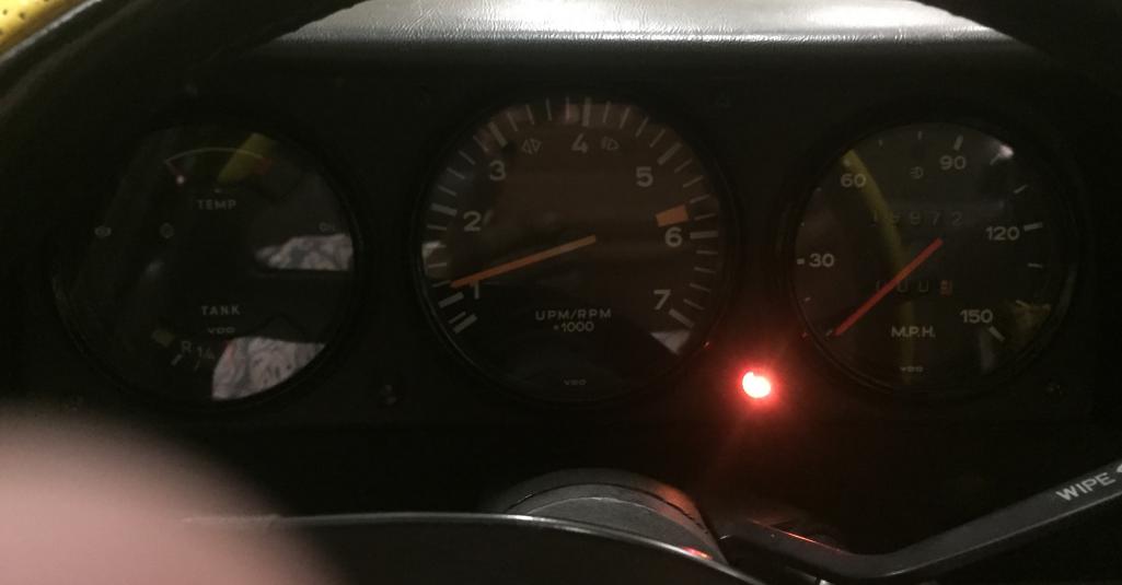

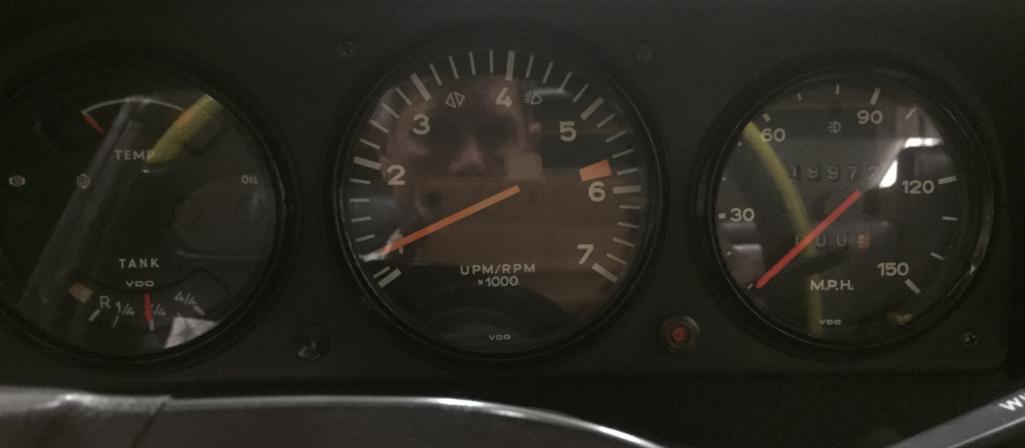

I kept feeling a small amount of heat coming in on my feet even with the heat control down. I checked the cables and the heater valves underneath the car, it felt like they were closing when I manipulated them. I finally pulled the valves out, and one of them had a nut stuck in the valve gap so it wouldn't close all the way. No idea how the nut could have gotten there, but it's nice to drive now without the heater leaking into the cabin! Btw, I had no use for the disconnected CAT and EGR lights on the dash, so I black plugged one light and connected the other to the cabin heat switch. Now when I pull the console lever to get heat, a red light goes on in the dash to remind me that heat is on.

oakdalecurtis Off, then On pic:
