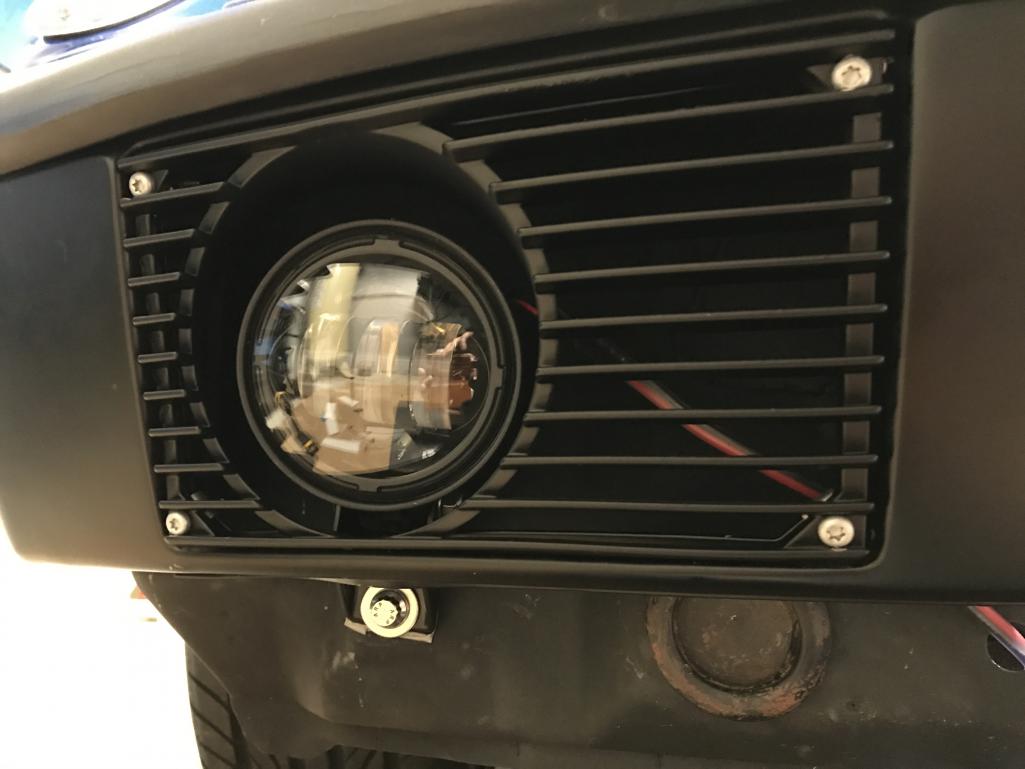

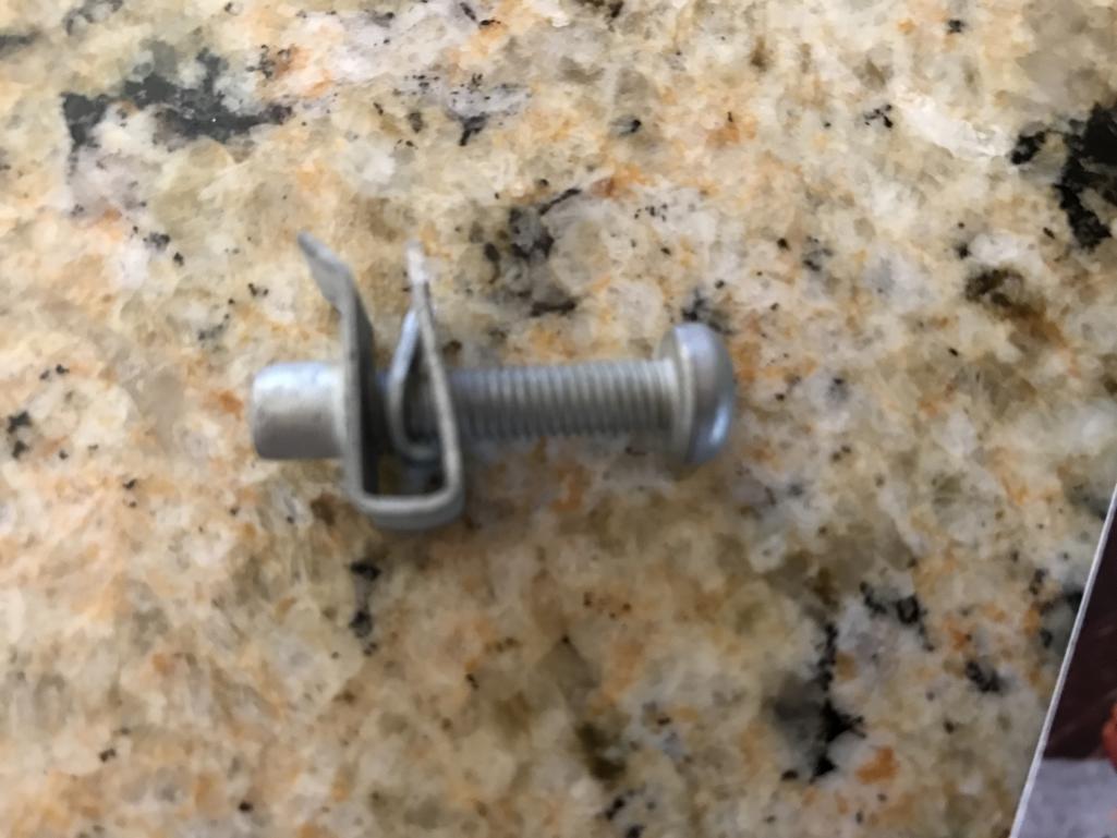

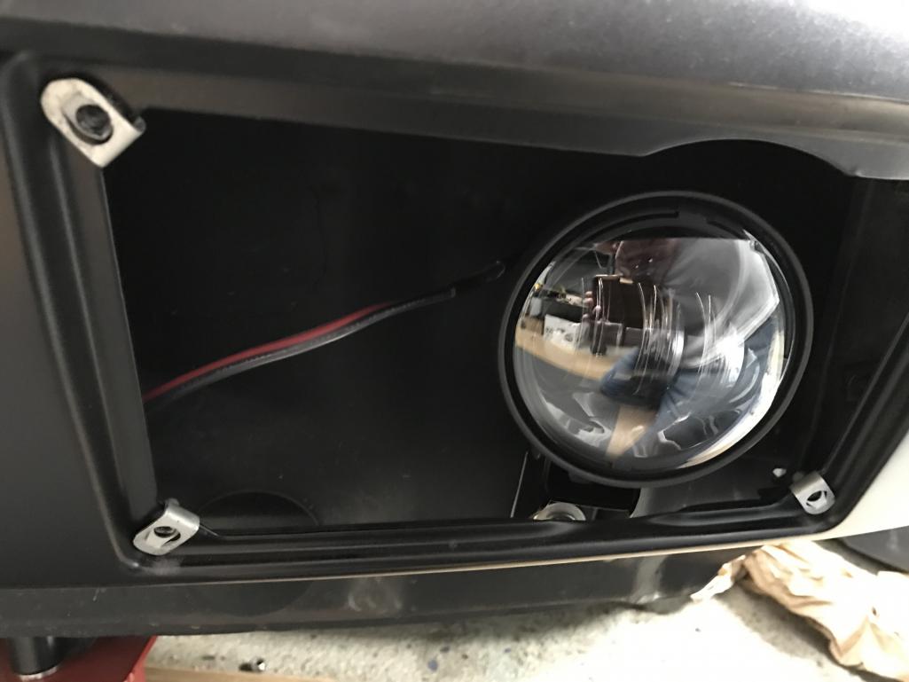

For what seems like forever I have been searching and posting for fog light grill nuts. Several members have been gracious enough to send me some. Some of those worked better that others. I gave up and decided to improvise. Instead of the #8 screw I'm using a M5 "J" nut with an M8 pan head screw with an internal torx drive. I agree that it is overkill but what the hell I'm finally done with my fog light grill install.
