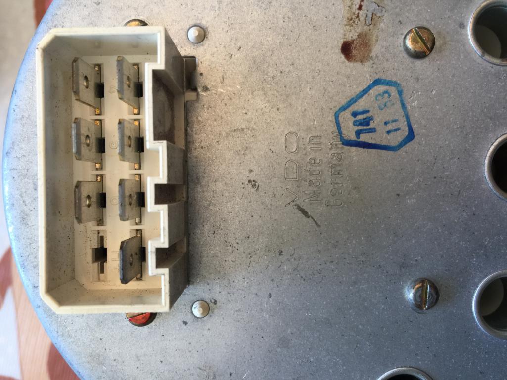

Anyone have a diagram of wiring connections for an '83 911 tachometer? I am going to connect to an MSD 6AL ignition. What are all the connections for? I suppose for turn signal lights which I don't care about.

Actually, the terminals on mine are labeled 1 - 6 and HG and H+

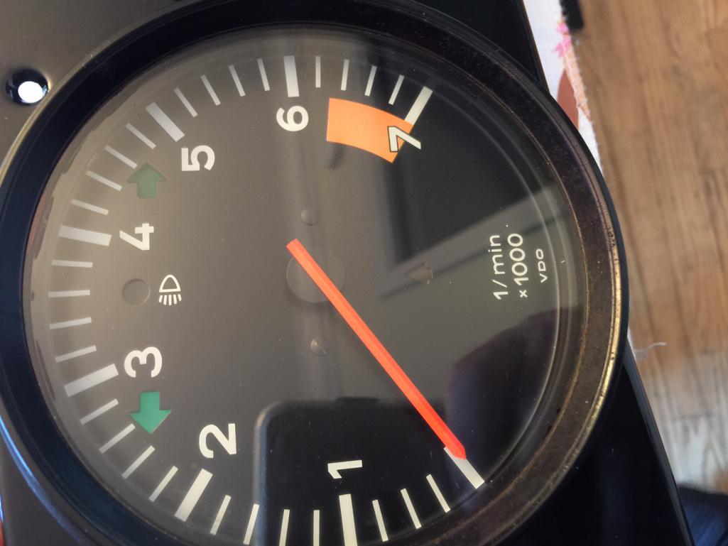

Member No.: 128
I would guess #2!
That tach looks different than mine but mine is an 82.
The stamp date is when it was manufactured not the model car it is for so it "could be" for a 3.2L. What is the part number on the inside top of the front side of the tach around the ring. Mine is 911 641 301 03.

Does it have a shift light. That would identify it as a 3.2 tach.
No, weird huh.

Look for the part number above the 3 and the 4 under the glass. Then you can figure out exactly what you have.
Edit - It does have an upshift light. That would make it a 3.2 tach

jcd914
post Apr 3 2017, 09:22 PM
Posts: 2,096
Joined: 7-February 08
From: Sacramento, CA
Member No.: 8,684
Based on the 8 pin connector on the back of the tach it is a 3.2 DME tach.
Pin 2 would be the tach signal but since it would be coming from the DME control unit I have no idea if it would work with a signal from the MSD unit.
What is the up pointing arrow just below the needle center?
Mark Henry
post Apr 3 2017, 09:44 PM
that's what I do!
Posts: 20,065
Joined: 27-December 02
From: Port Hope, Ontario
Member No.: 26
If it is a DME tach is it compatible with the MSD?

Shift indicator light...pretty sure that is a 3.2 tach

QUOTE(Mark Henry @ Apr 3 2017, 08:39 PM) *
QUOTE(mepstein @ Apr 3 2017, 09:18 PM) *
LOL...so maybe it is a 3.2 tach. Will it work with a 3.0 motor/MSD

QUOTE(mmascari @ Apr 3 2017, 08:45 PM) *
I would think it will. Again try it and see if it works!
As long as you do + and - correct you won't mess it up!
