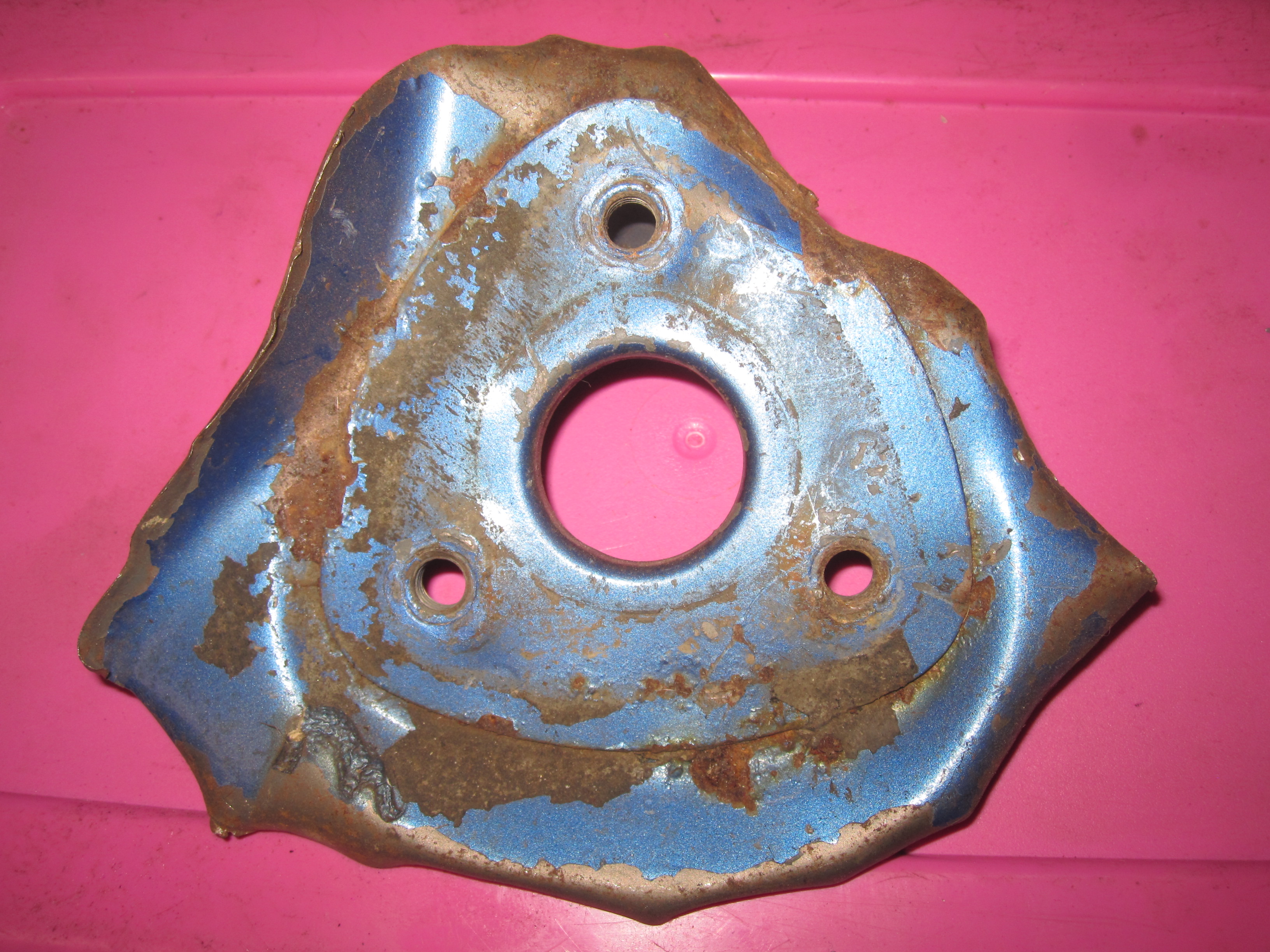

Wheel side / tank side
DennisV
post Dec 1 2023, 09:52 AM
Post #47
Posts: 1,031
Joined: 8-August 20
From: Santa Rosa, CA
Member No.: 24,575
QUOTE(rgalla9146 @ Nov 29 2023, 09:31 PM) *
Very helpful photo. Thanks!
Best I can tell, no seam welds. Just a few spot welds in not so precise locations, as suggested by Rich / @914werke ? (IMG:style_emoticons/default/welder.gif)
