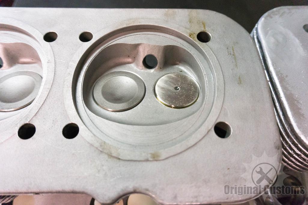

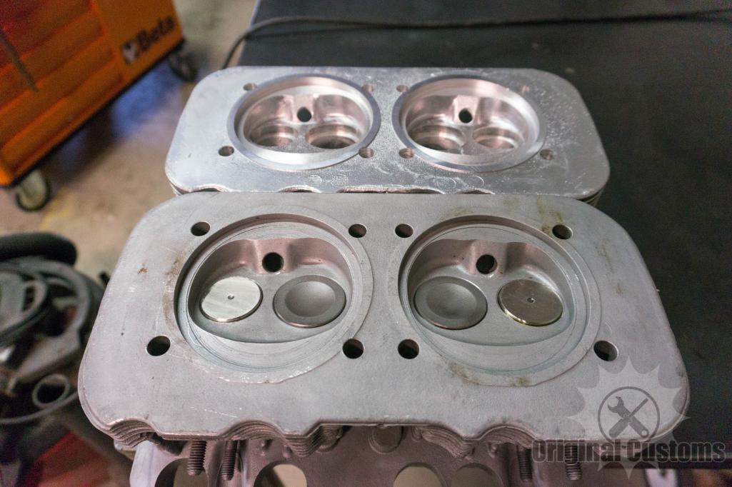

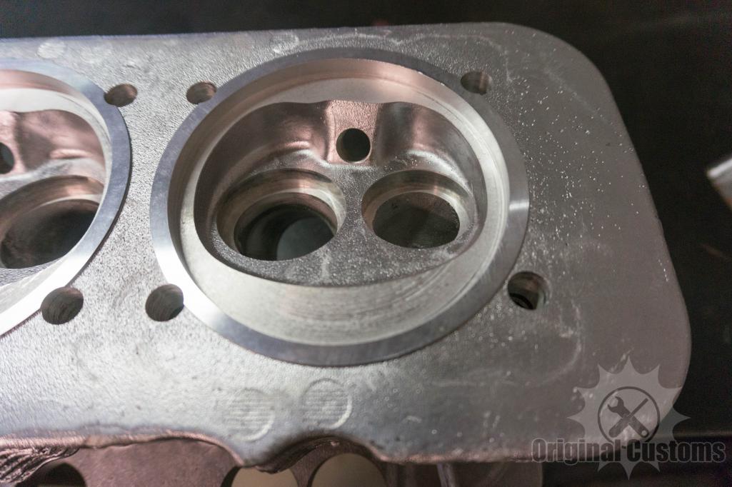

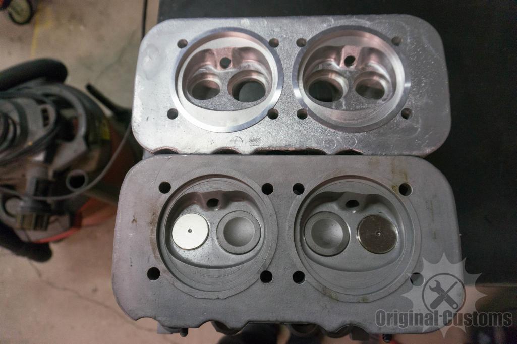

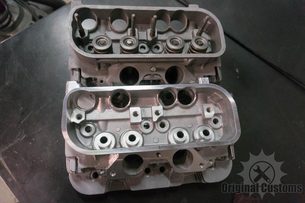

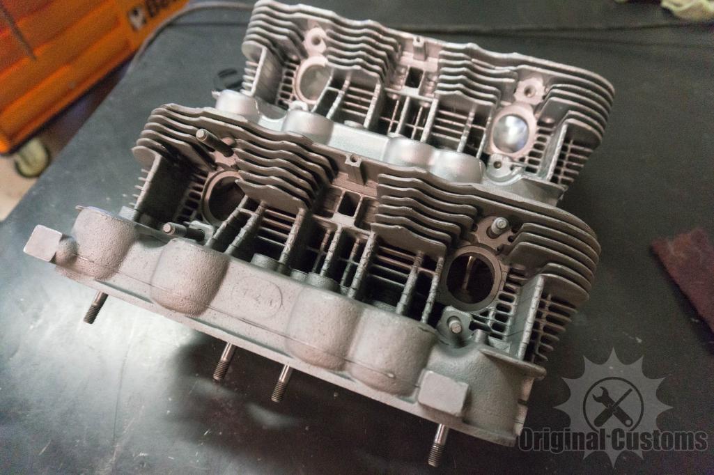

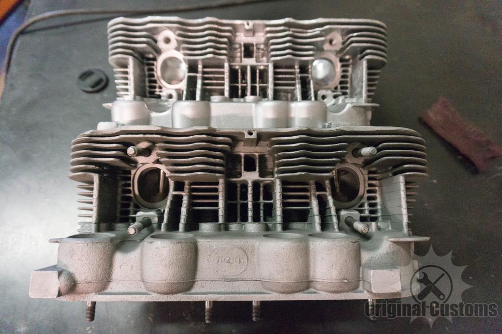

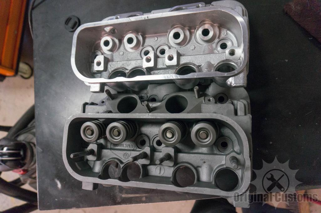

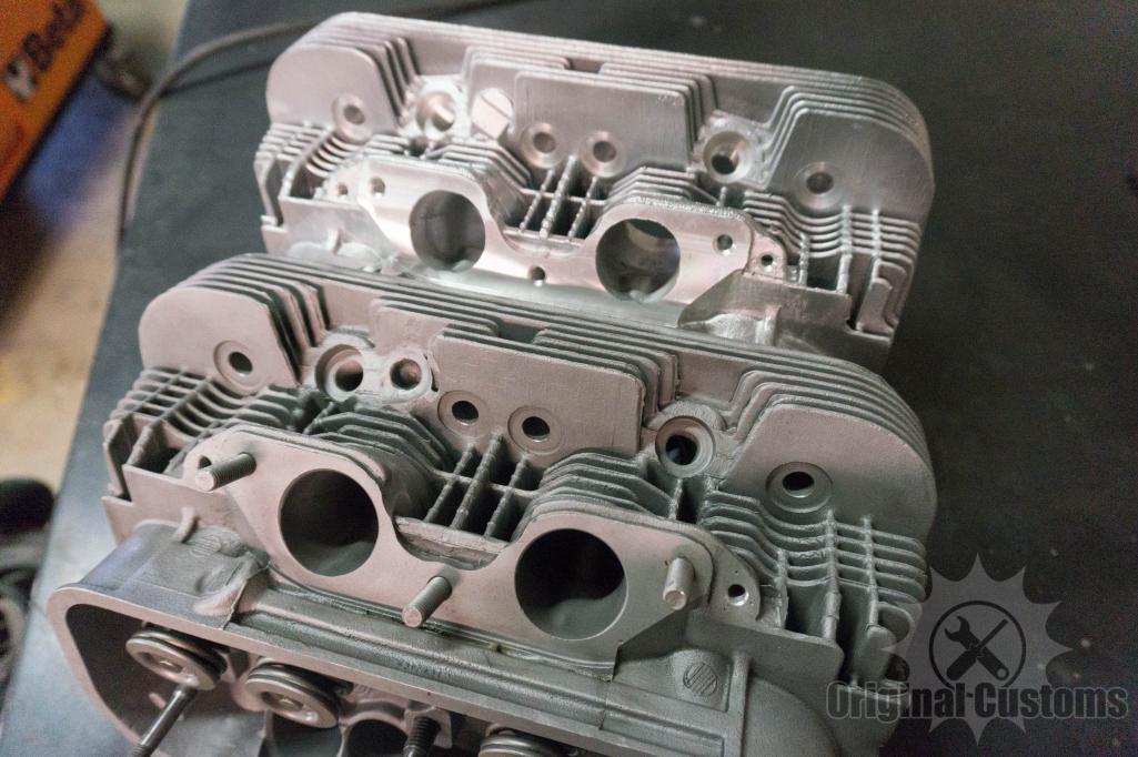

Got mine. I could've sworn I replied to this thread, but I guess I got sidetracked. (IMG:style_emoticons/default/wacko.gif) At this point I've only inspected them visually. But comparing them to stock 2.0 heads, everything looks the way it should. You would be hard pressed to identify these as reproductions. My next step is to ship them off to a machine shop that I trust for a more thorough inspection than I'm set up for. But I don't see why the bare castings shouldn't be a good starting point. The first few sets I end up usings I'll expect to remachine the cylinder spigots and then I'll know if their machining is correct. Installing the seats and guides should be the same as having a stock set rebuilt.

Click the pictures for the full size versions if you want a closer look.

Nice, thanks for posting.
Are you going to install Timeserts or Helicoils for the studs?

I think I'm going to have to get a set.
QUOTE(Mueller @ Apr 27 2017, 03:31 PM) *
I don't see why you have to on a new casting. (IMG:style_emoticons/default/confused24.gif)
One thing I do see is no step in the cylinder seating area. It would be interesting to know what the chamber CC is.

notice the CHT location isnt drilled/tapped either.

Overall they don't look bad at all for a first genertion casting run. I'll be porting a pair this weekend. I'll also use my cnc to reverse engineer and check critical features to see how they compare.
I wish they'd copied the later smog version which has more material around the exhaust port. My contact at AA said they plan to add material in several areas to the next batch for more aggressive porting. Wasn't able to get alloy info., but I'll be able to tell a lot by the way it machines.
They aren't as beefy as the AMC heads we've been modifying for years, but if AA works on that like they said they are they could have a solid product at a much more affordable price.

Verdicts still out on these castings. They make a good first impression, but at this point I need to work a pair. They clearly aren't as beefy as the amc's. The amc's are very good castings that have proven durable on a lot of very high output large displacement engines over the past 15 years. We'll see. Like I said, once I machine a pair I'll know a lot more.
I would LOVE it if I didn't have to weld heads to move the spark plugs anymore. I still do all of the welding and peening personally and it takes it's toll physically. Not to mention the time.
