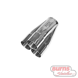

Only thing I like about the BB is the collector. But if they built it cheaply it is no better than the factory style collector. If they do them like these. It would certainly help the performance.
Attached ImageAttached Image
Burns Stainless Merge collector (IMG:style_emoticons/default/aktion035.gif)
We digress, I like the touches on this build, enjoy the (IMG:style_emoticons/default/driving.gif)

QUOTE(914forme @ Apr 18 2018, 09:49 AM) *
I don't think b&b uses the reverse cone do they?
I have a fixture to make those collectors and can do it for half of what burns sells theirs for.. Hmm maybe a new product

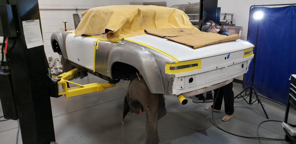

Getting ready to cut.

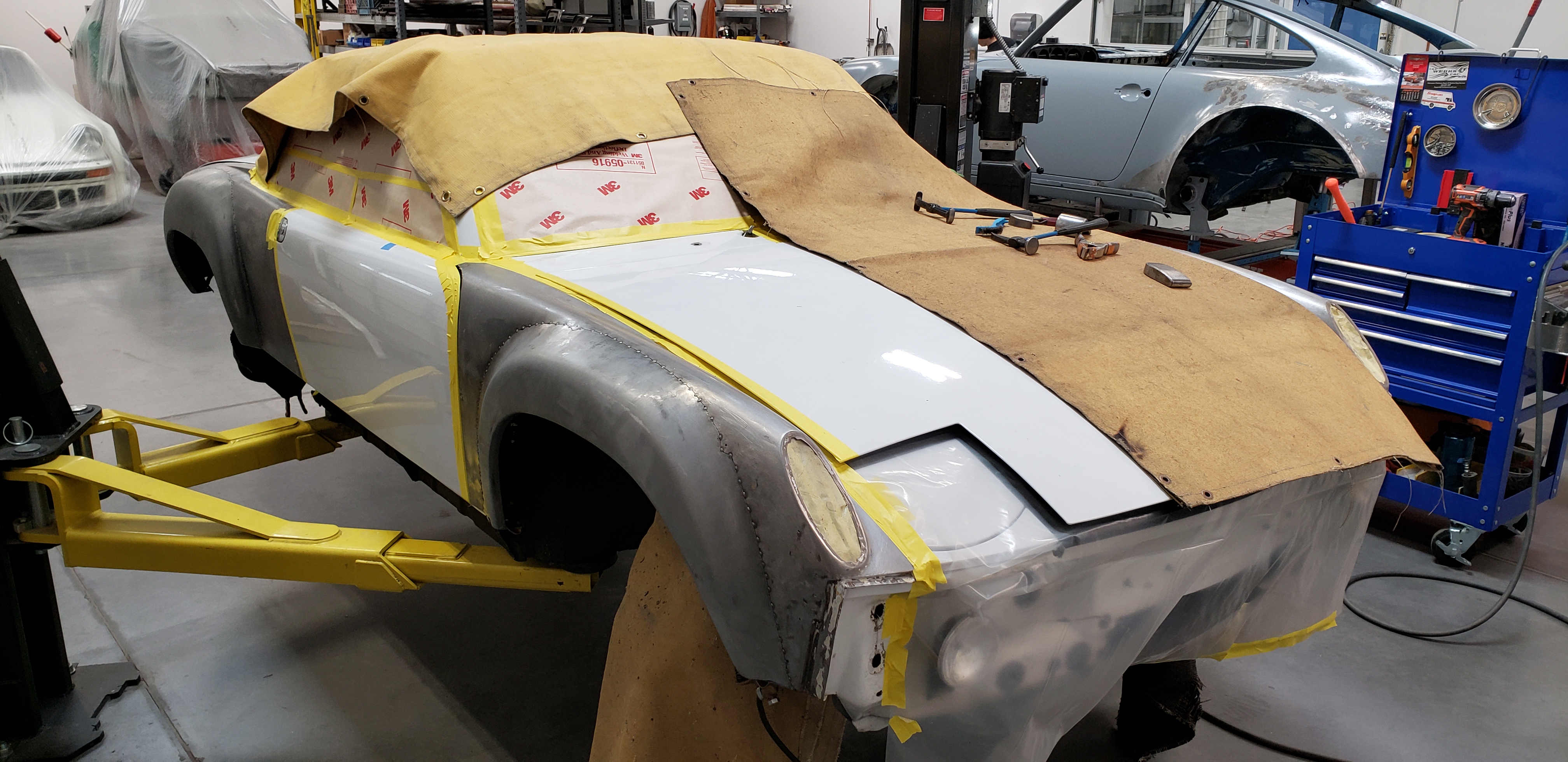

Moving along.

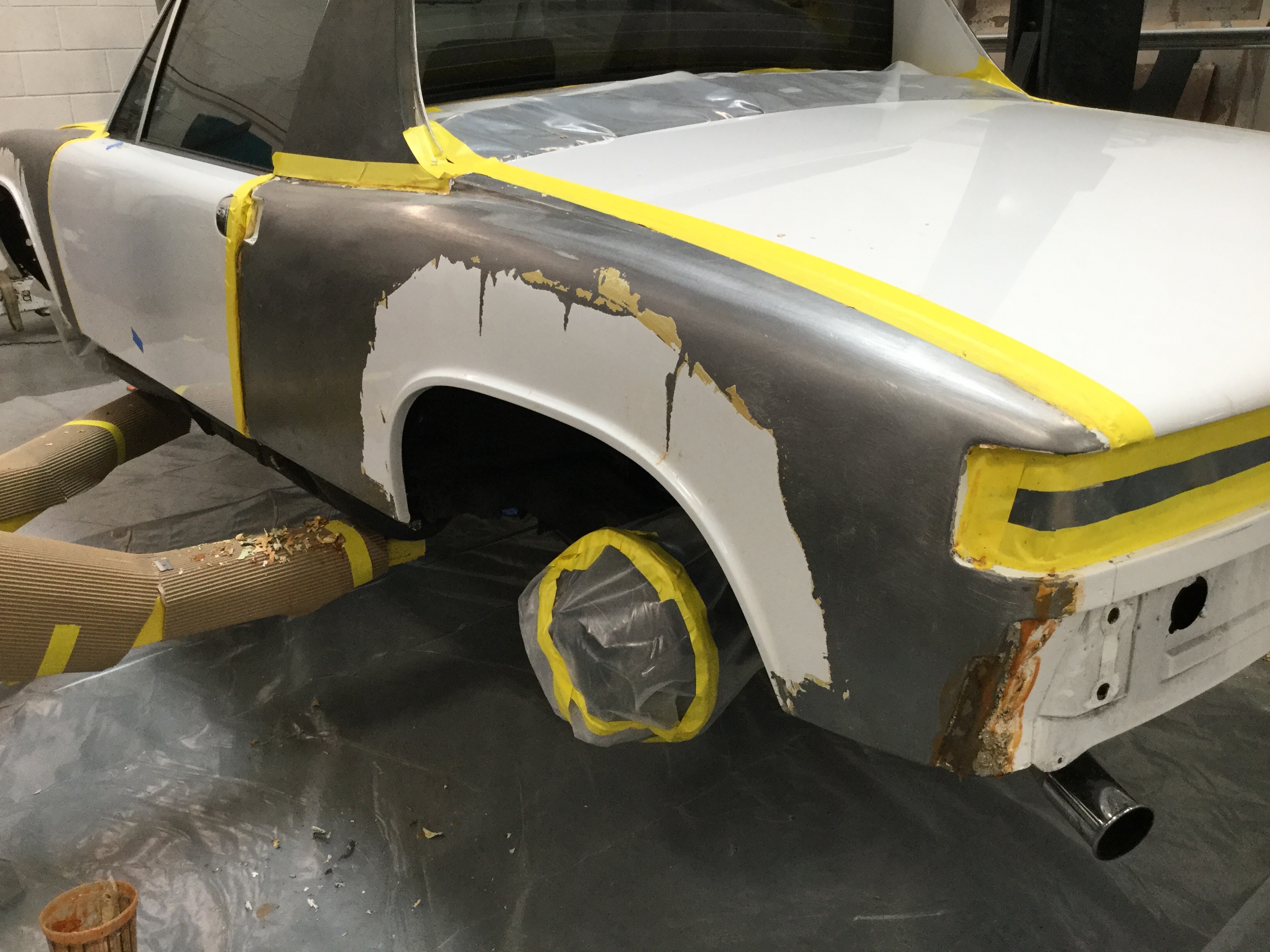

Starting to look like a GT.

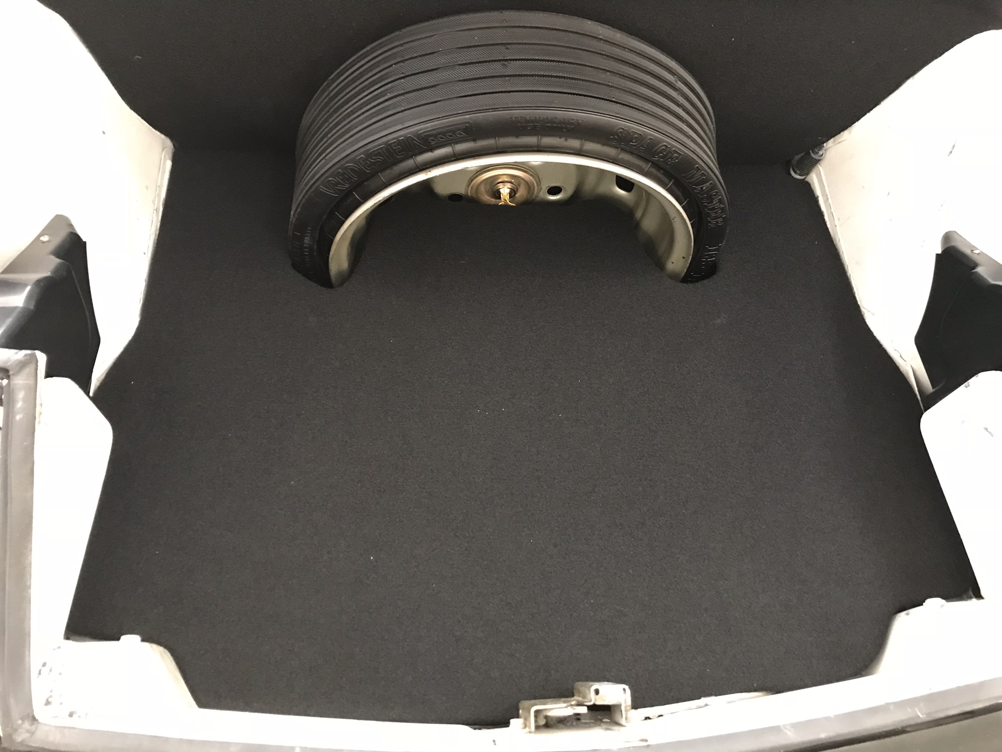

QUOTE(burton73 @ Jan 25 2019, 11:25 AM) *
What is your 5 lug spare tire set up?
You will have it back soon. The waiting is almost over
Bob B
(IMG:style_emoticons/default/driving-girl.gif)
Bought the collapsible spare and the floor pan bracket from Bruce. Had my muffler shop friend make a custom plate and then weld everything in place.
