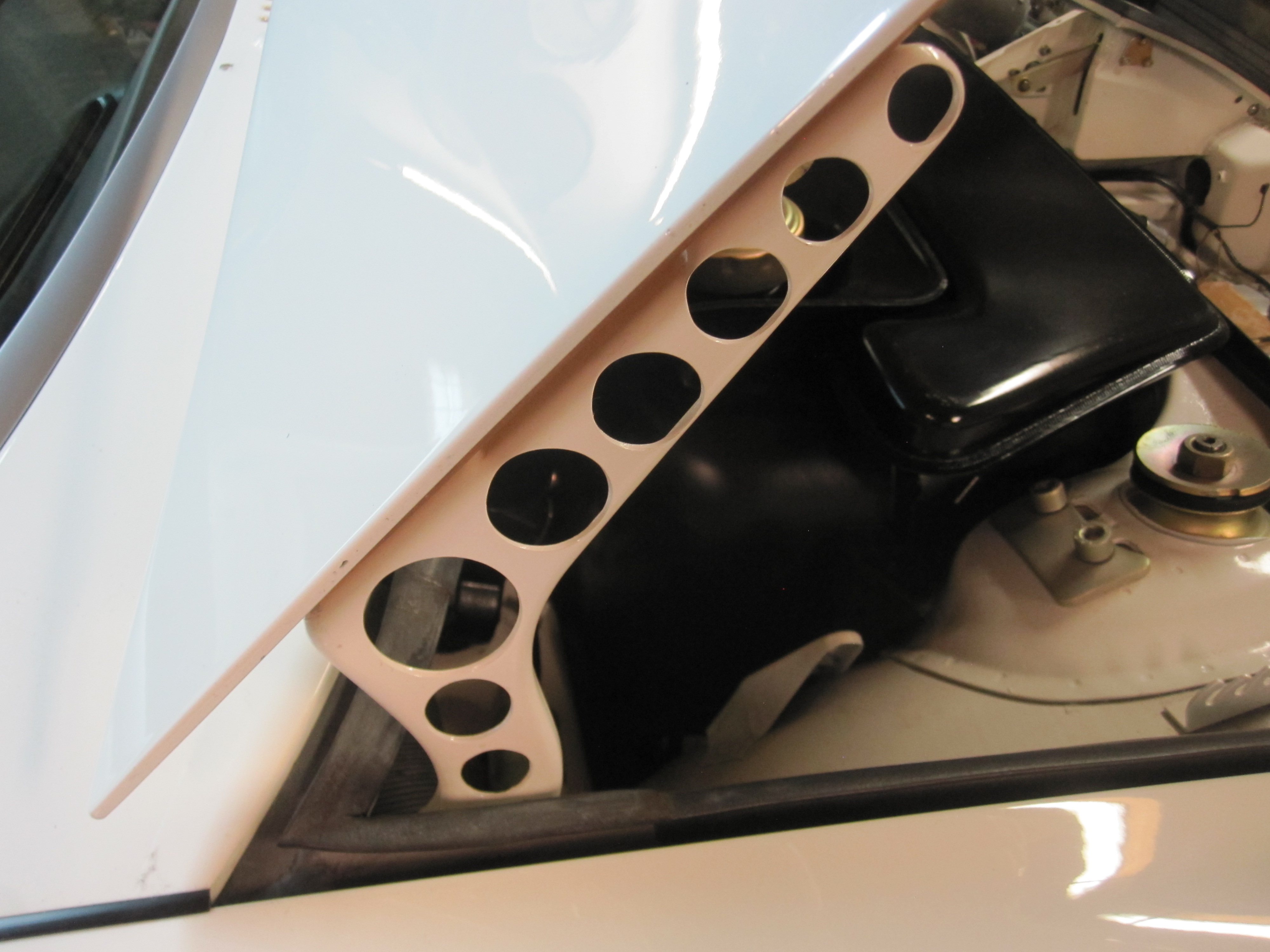

Attached another pic....... my pics can go only one at a time.
Front hood hinge detail

I love the details like this, especially when they look so uniform and precise.

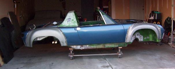

.......July 2012

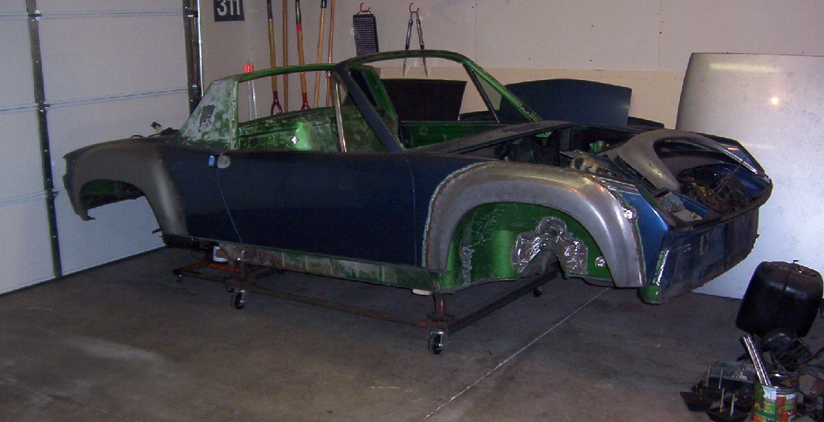

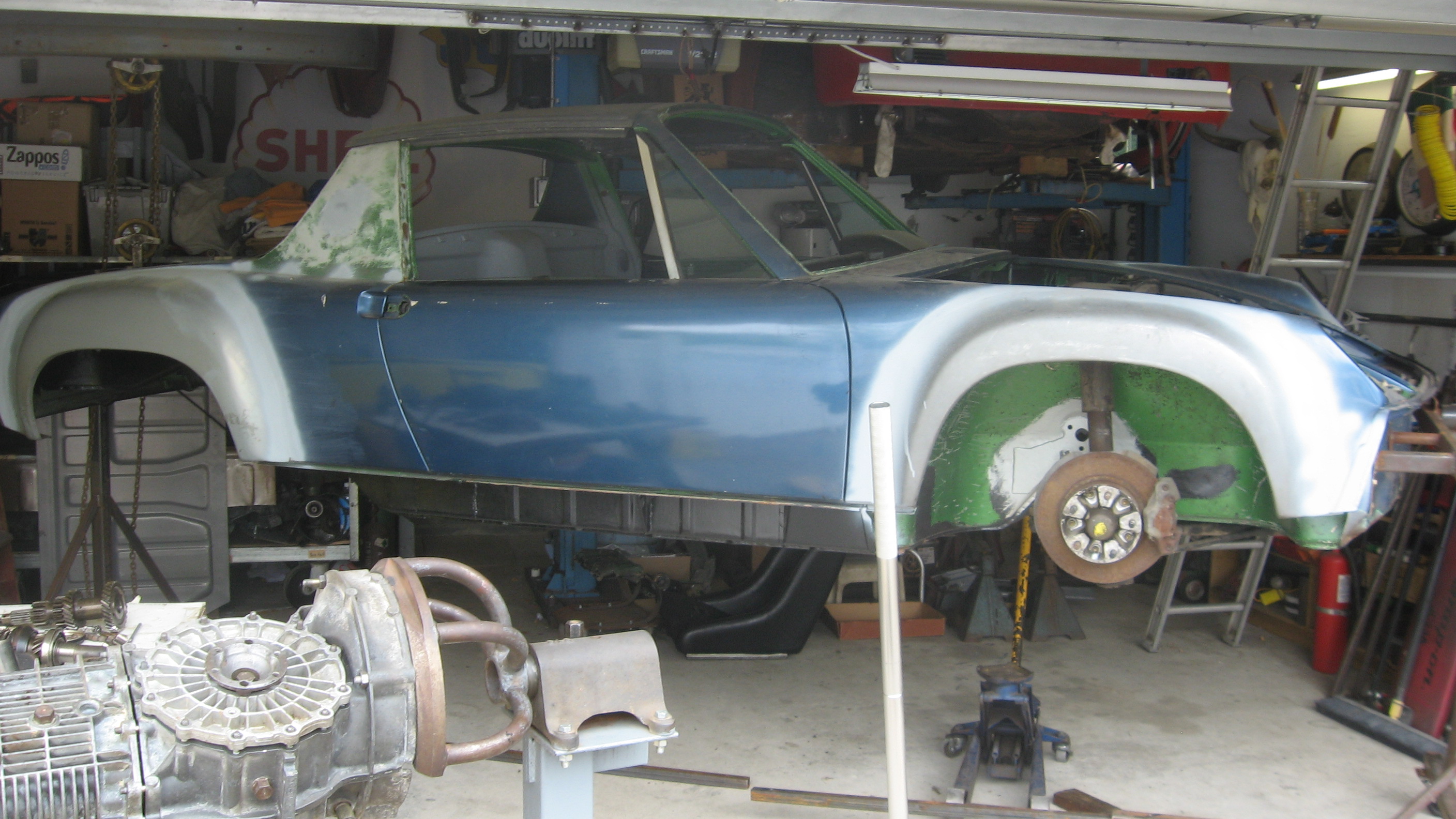

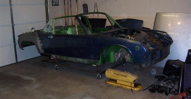

The 914 is looking good. Keep up the great work and post the progress pics.
Here's a few pics of your 914 from 2006.
It defiantly has come along nicely.

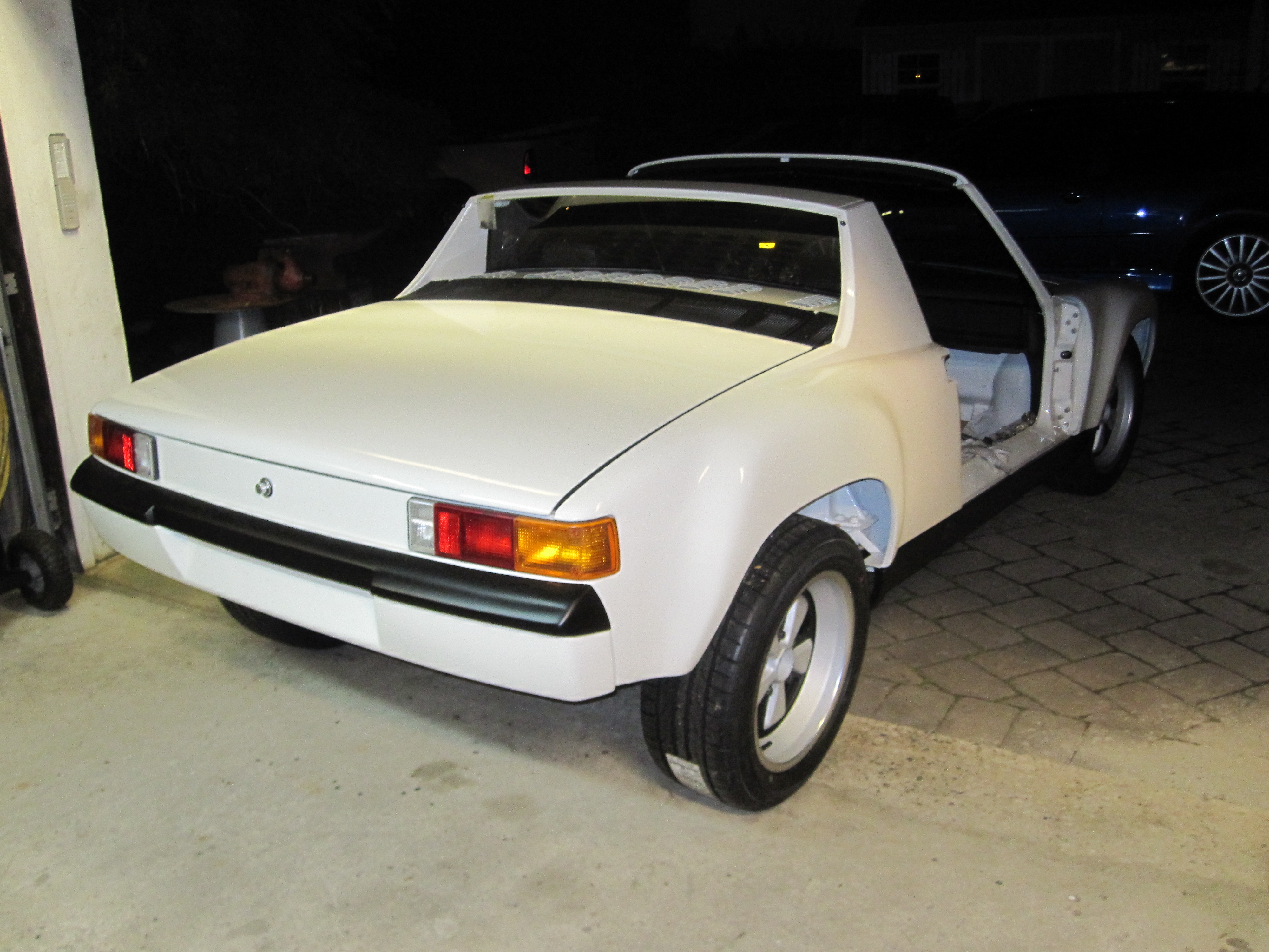

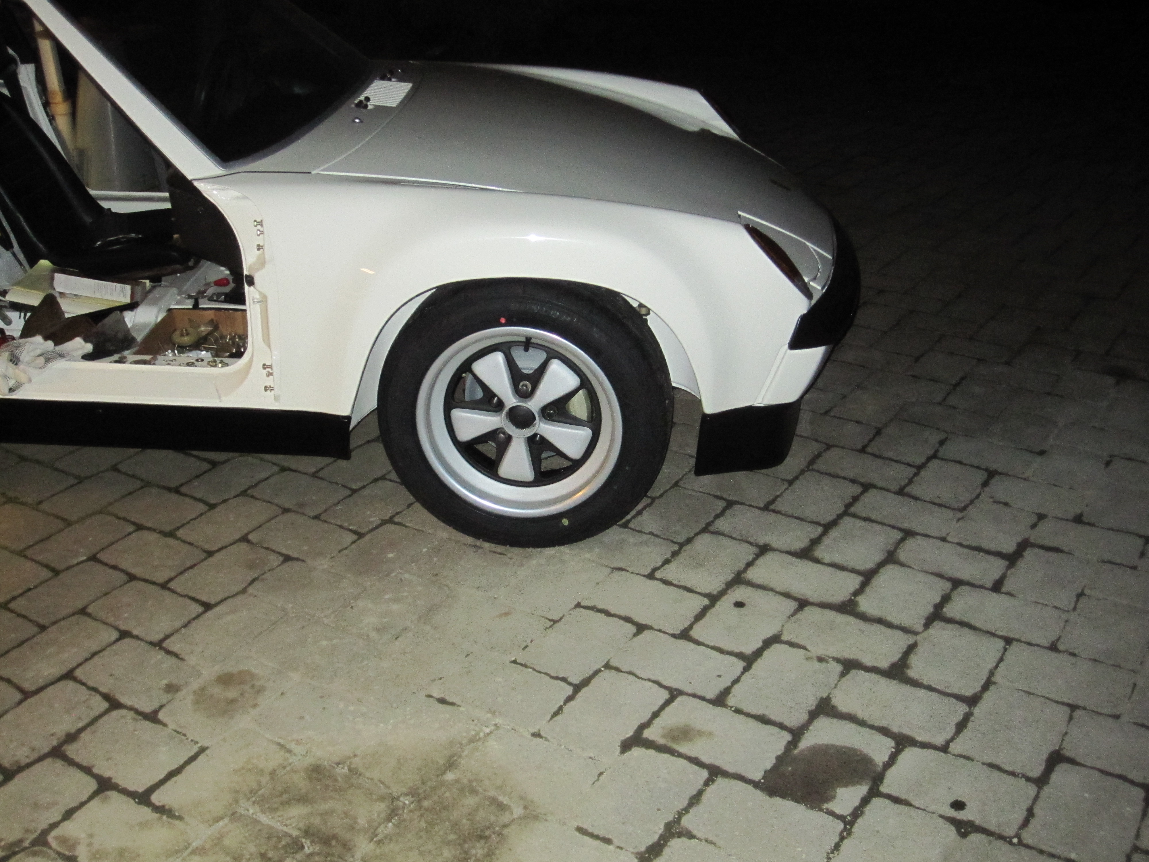

It's now on the ground with the refinished wheels and new tires.
Beautiful job on the wheels by Rick at Fuchs Restoration Service.
Done on time ...no delay...no BS
Project still going strong but way too slow.

more

Wow, that looks fantastic. I sure do like the GT's in white.

Nice and clean!!
Bob B (IMG:style_emoticons/default/smilie_pokal.gif)
post Oct 18 2018, 09:15 AM
Post #120
914-6 GT in waiting
Posts: 20,857
Joined: 19-September 09
Member No.: 10,825
Rory, you are making me like white. Looking great. What size tires?
