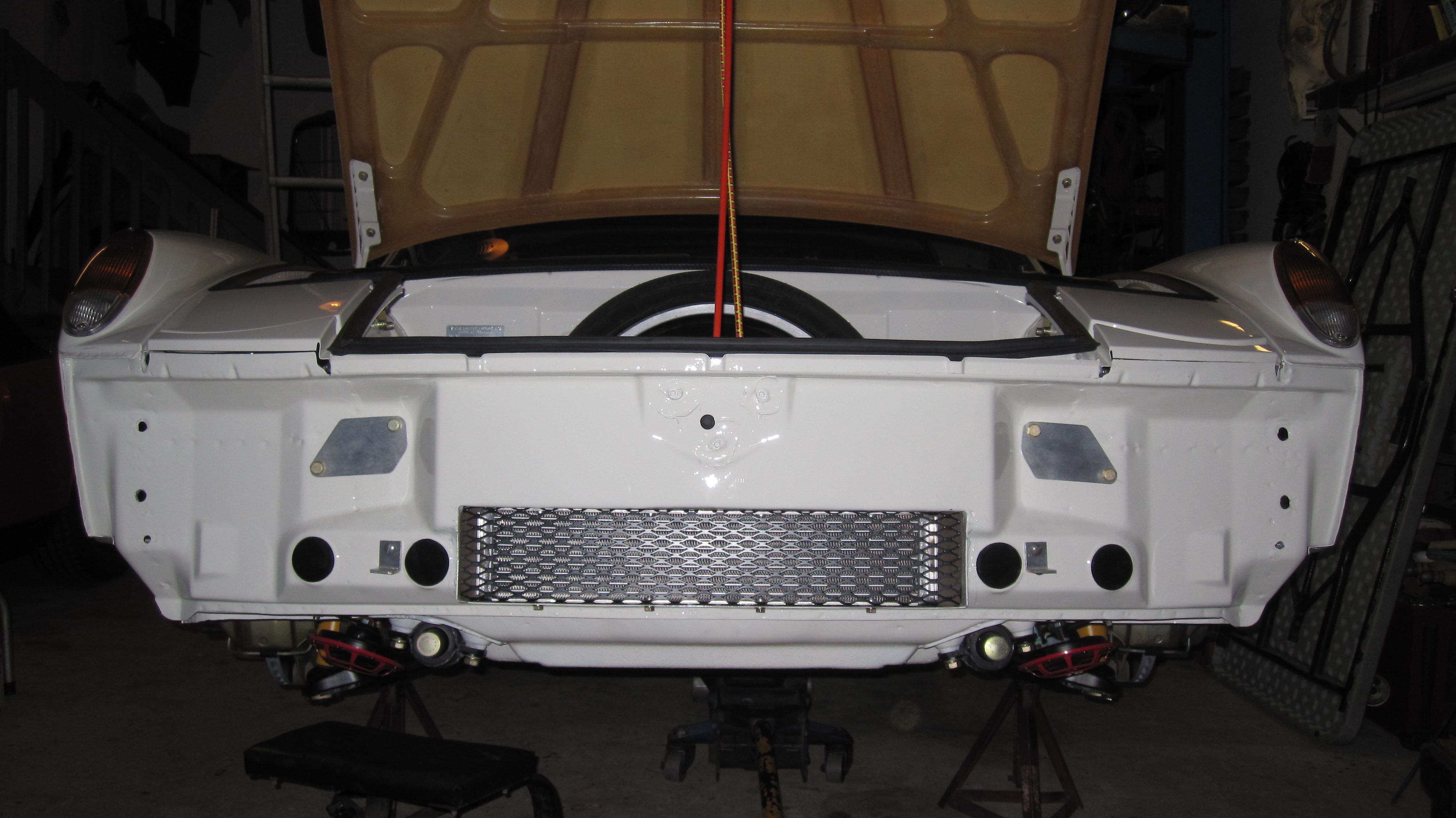

Had to remove front bumper and spoiler to complete some details.
A couple pics.
Looks like I'll be refinishing my jack soon.

Grillwork looks great! Clean install in and out! This is great inspiration!

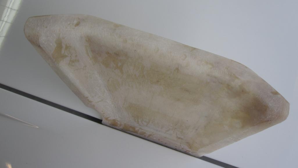

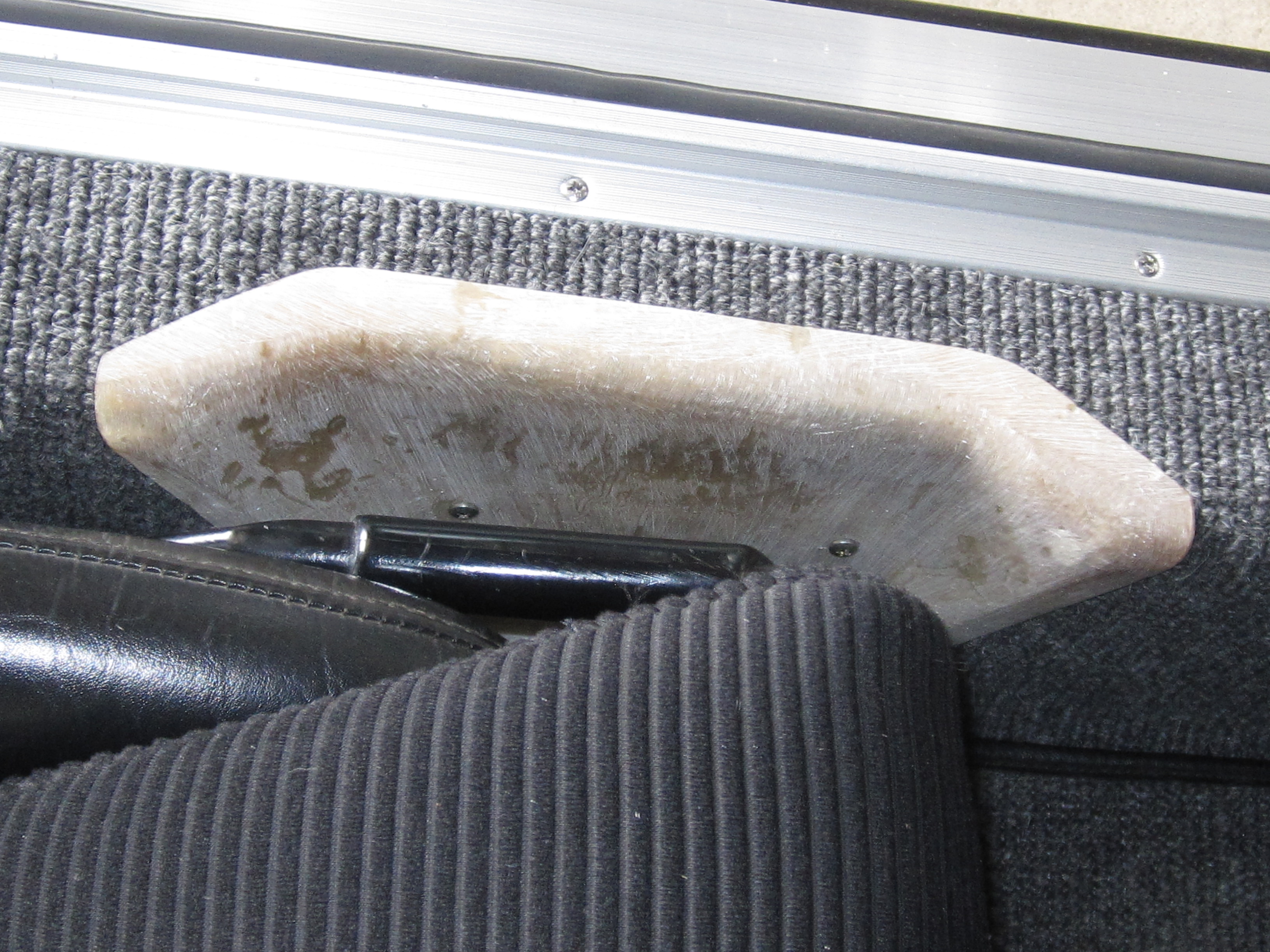

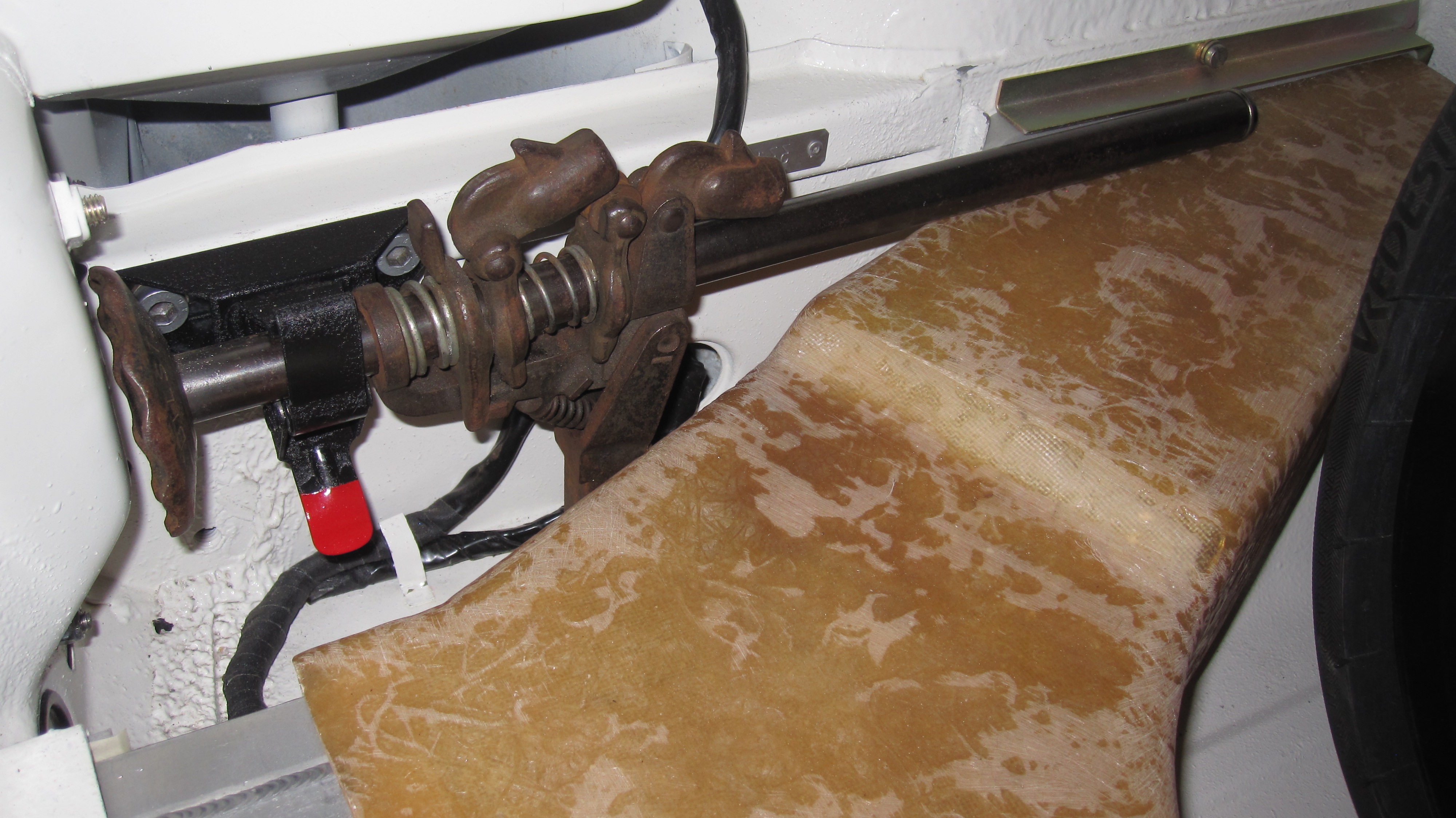

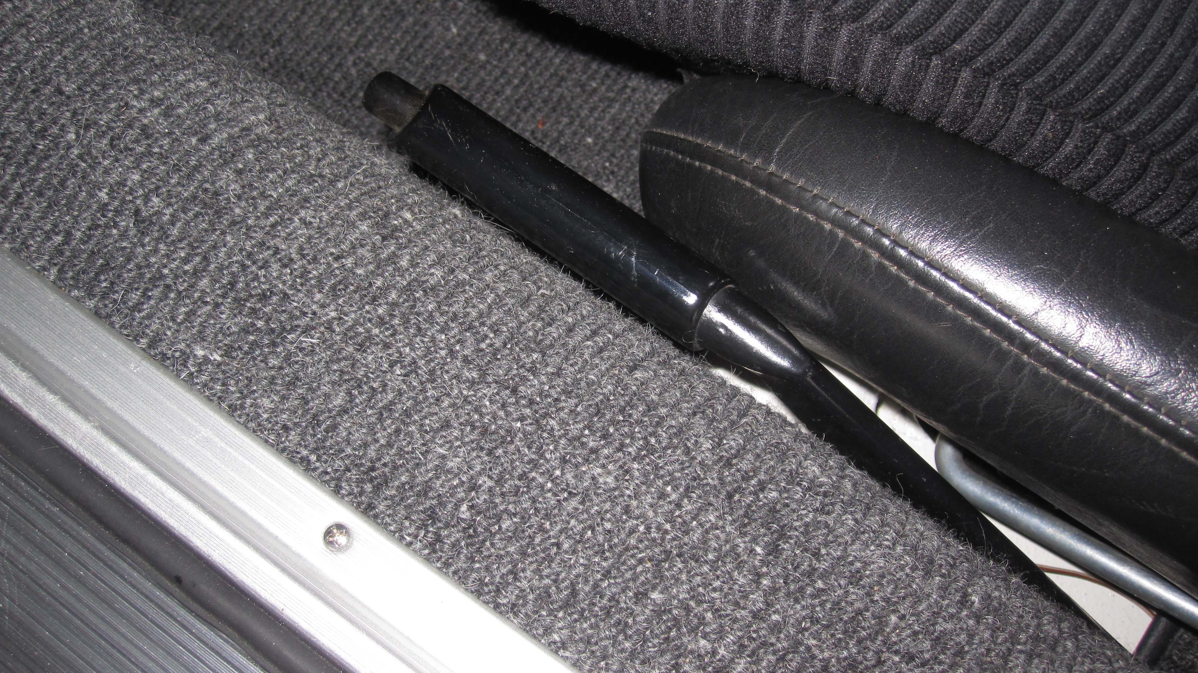

Interior and carpet details.
My new carpets had no formed recess for the hand brake.
My seats ?....same issue.
I did not want to make cuts and just hope for a clean result.
Here's what I came up with.

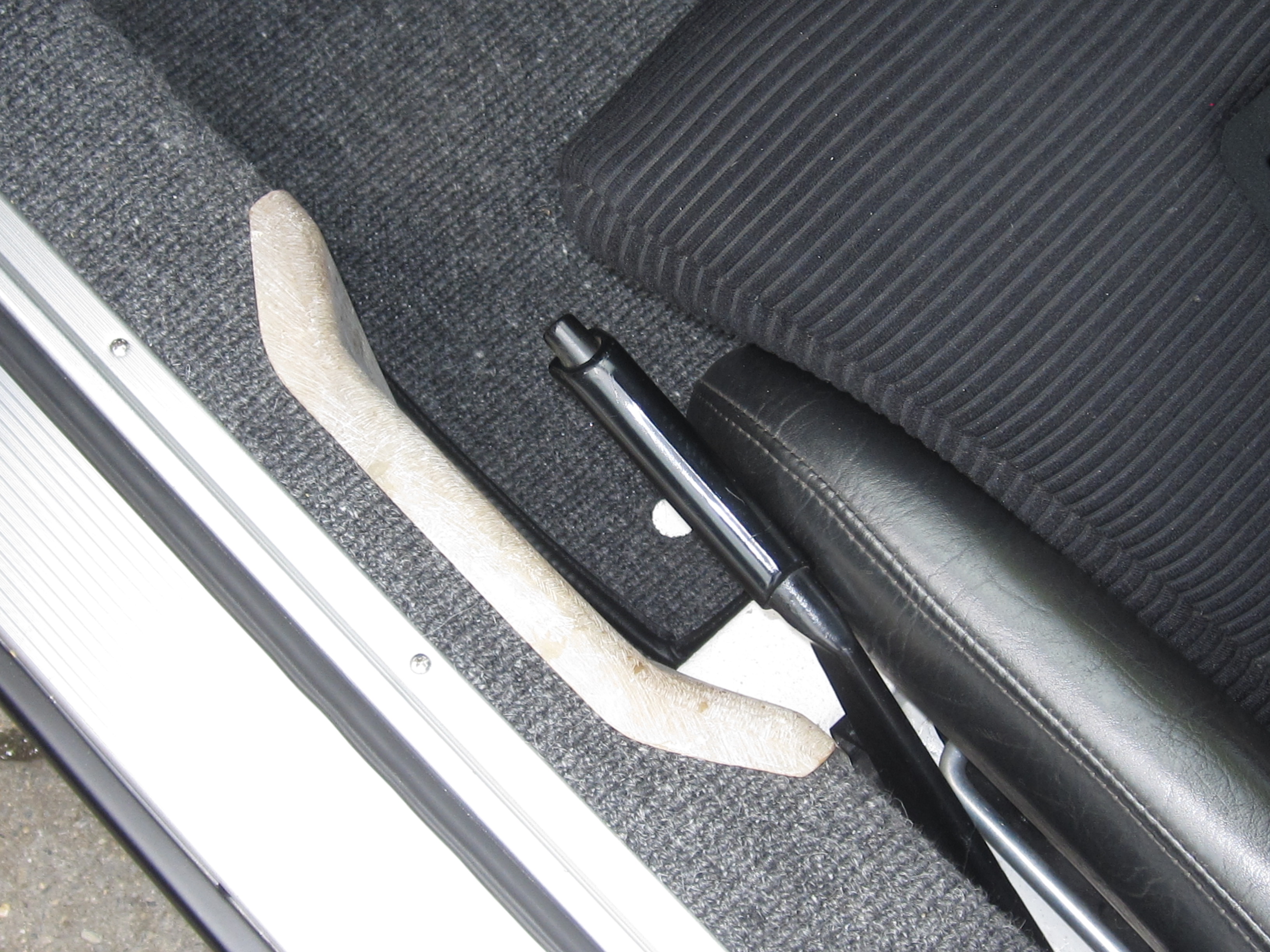

fiberglass

And the result.
A little more work and some paint....Voila !
And find some truss head screws too.

From: Paramus NJ
Member No.: 5,176
better pic

I thought the carpet was recessed with heat, rubber mallet, contact cement.

Mark and Bruce
The carpet does have a 'plastic' backing and the supplier said to heat and hammer it into shape.
I didn't like the idea of gluing the material only to have wrinkles and be
unable to fix it. The square weave carpet was big consideration.
Also the car has a longitudinal kit that made the recess very irregular.

I really like the fiberglass piece you made.

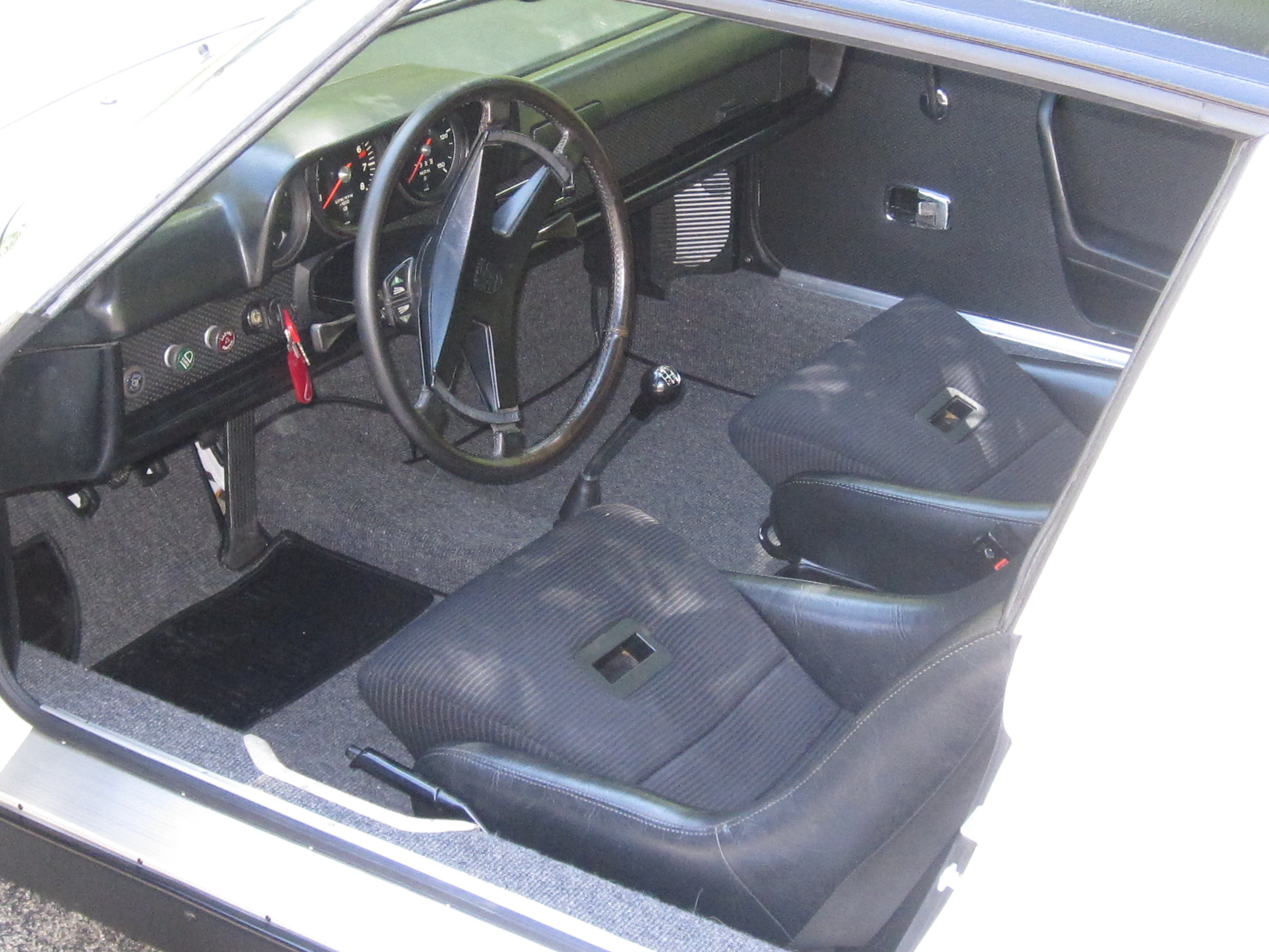

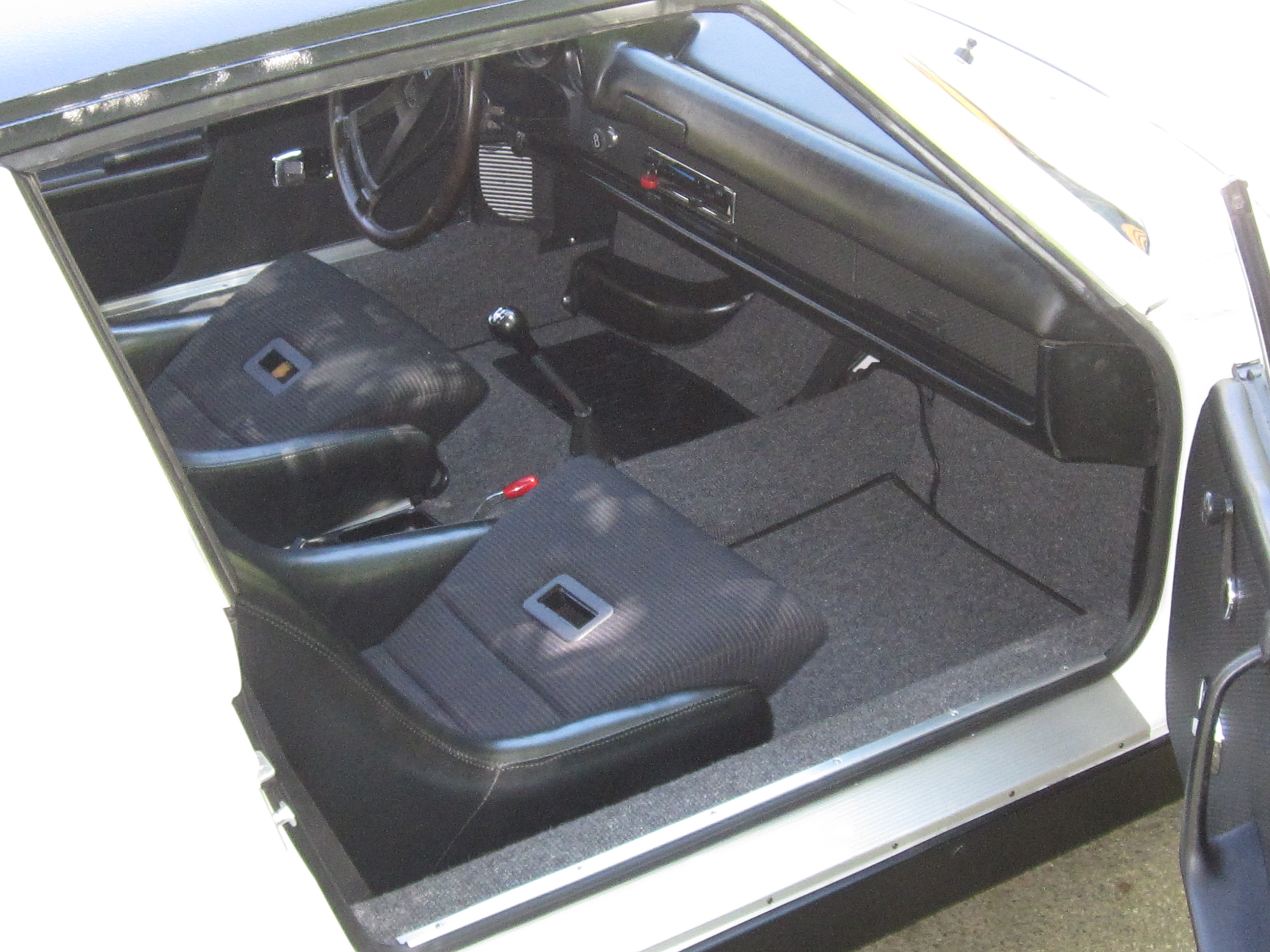

some interior pics

Do you notice the oil line cover when you are driving

QUOTE(mepstein @ May 2 2019, 01:40 PM) *
Maybe I'll notice it on a long trip.
I've only been on the highway for fifteen minutes or so a couple times.
Doesn't seem intrusive.
I might use it as a base for a dead pedal.

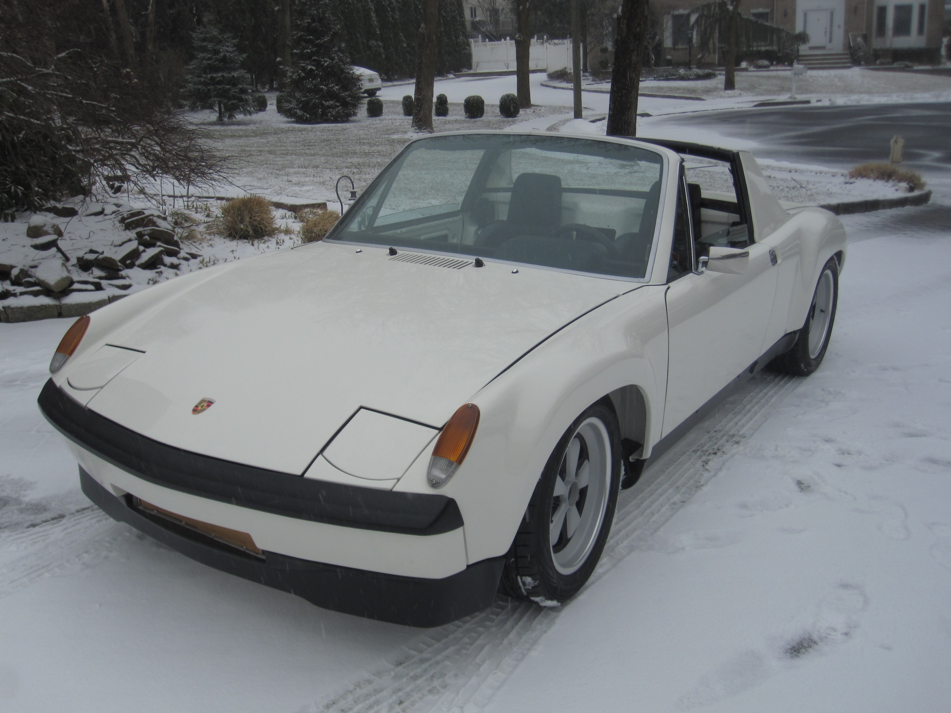

a small picture review
February to May
