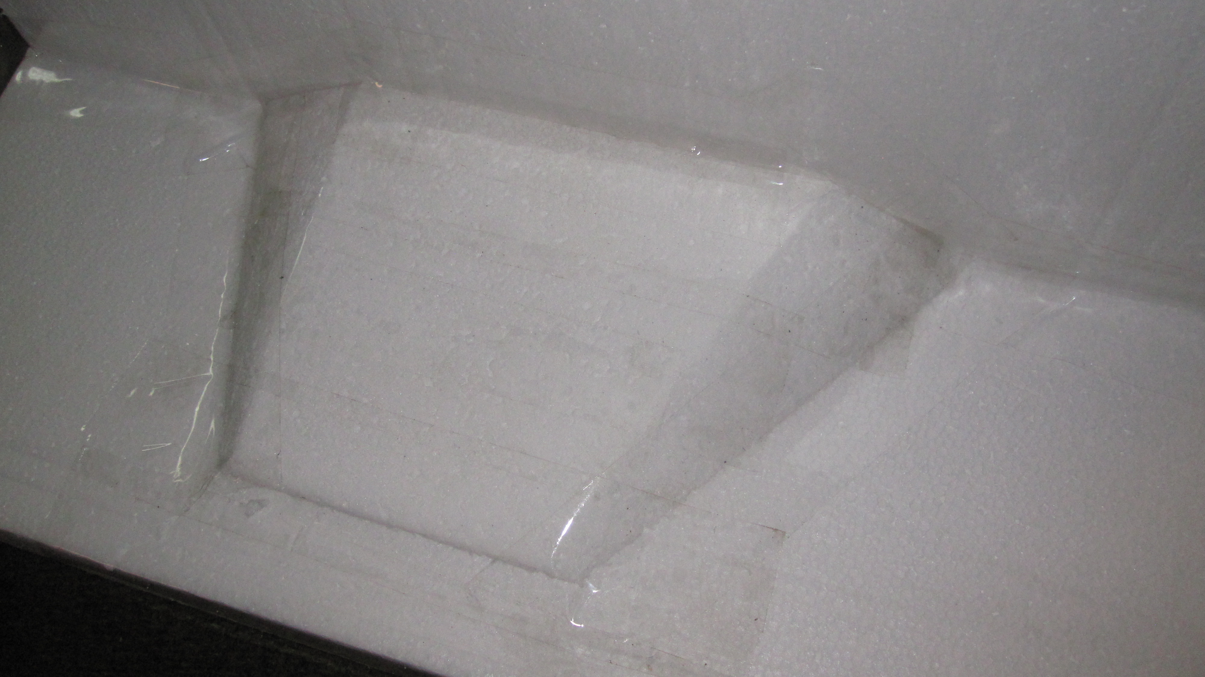

QUOTE(Dion @ Apr 17 2020, 10:20 PM) *
QUOTE(rgalla9146 @ Apr 17 2020, 08:19 AM) *
Here's a pic of the hand brake recess part after it was finished and installed.
I'm getting to drive the car more now that the roads are free of salt
Also free of traffic due to the virus.
@rgalla9146
Ok Rory, I’ll be glad to pay you to make me one of those! That’s a very cool detail.
Enjoy the drives.

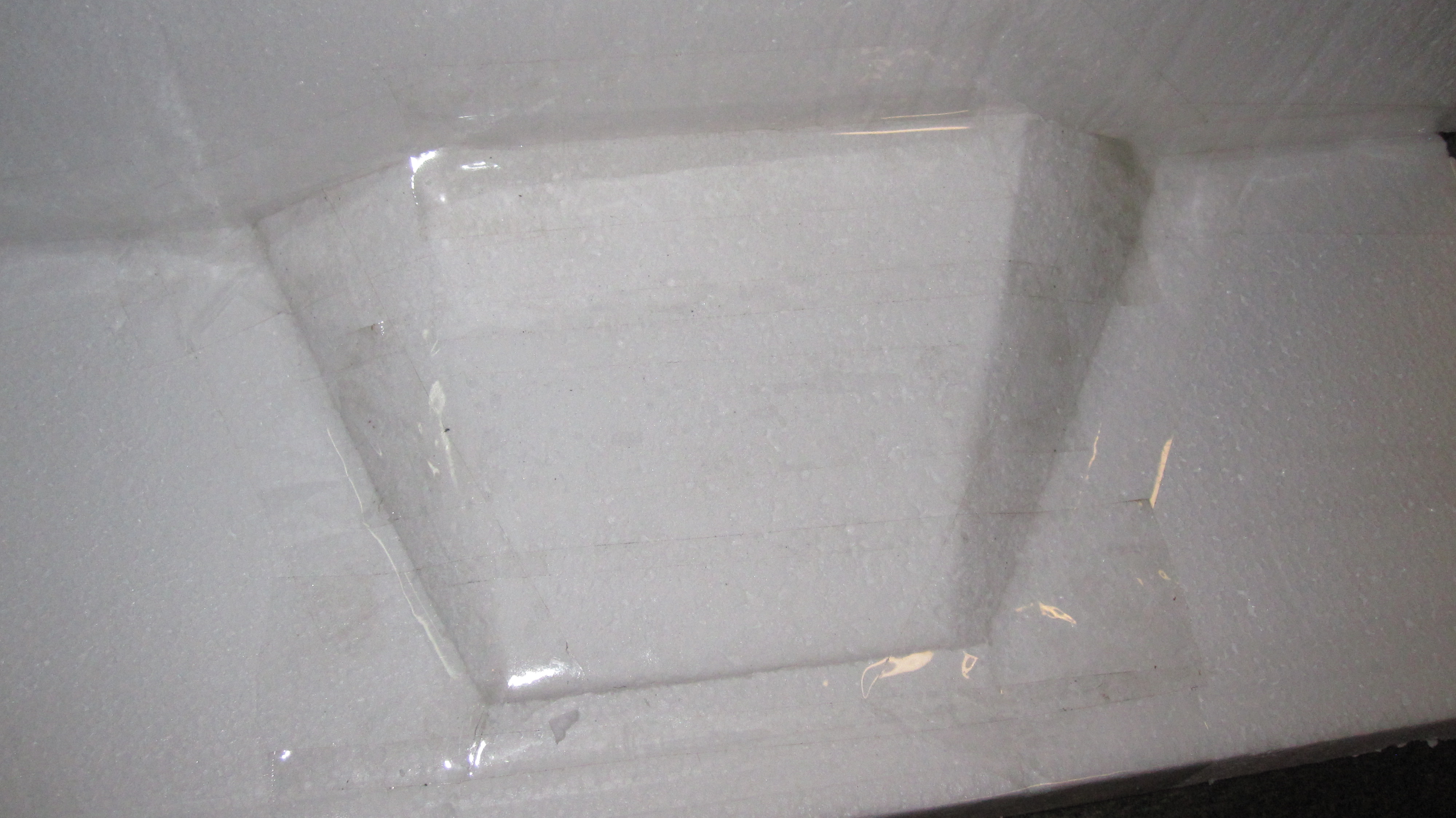

Hey Dion
I just found the only pics I took of the fabrication.
I made a styrofoam wedge that fit into the recess.
Then I glued it into a 90 degree corner and covered it with clear packing
tape to keep the fiberglass resin from eating the styrofoam.
Then covered the pictured piece with saturated chopped glass.
Wait a few hours......sand and shape to fit. Paint.
The texture is a lucky result.

Thanks for sharing that technique Rory. It’s a small detail but practical. Looks factory.
Well done.

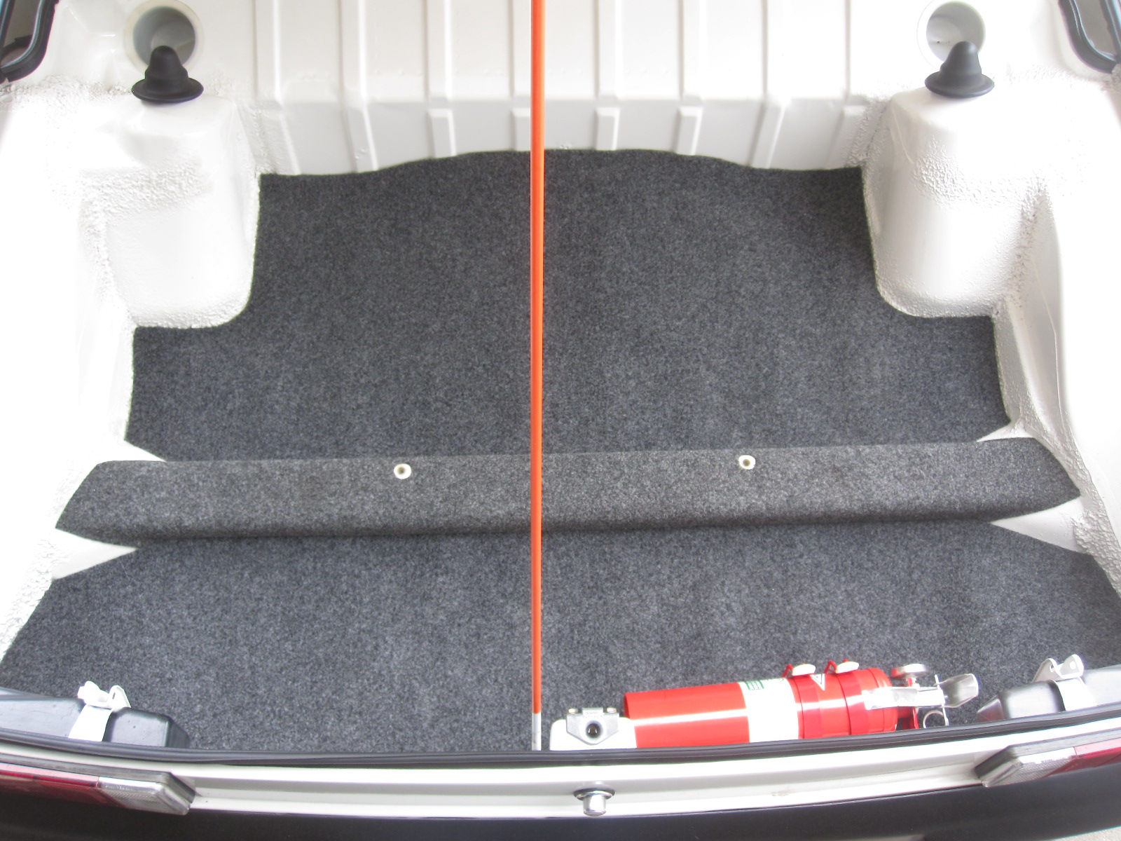

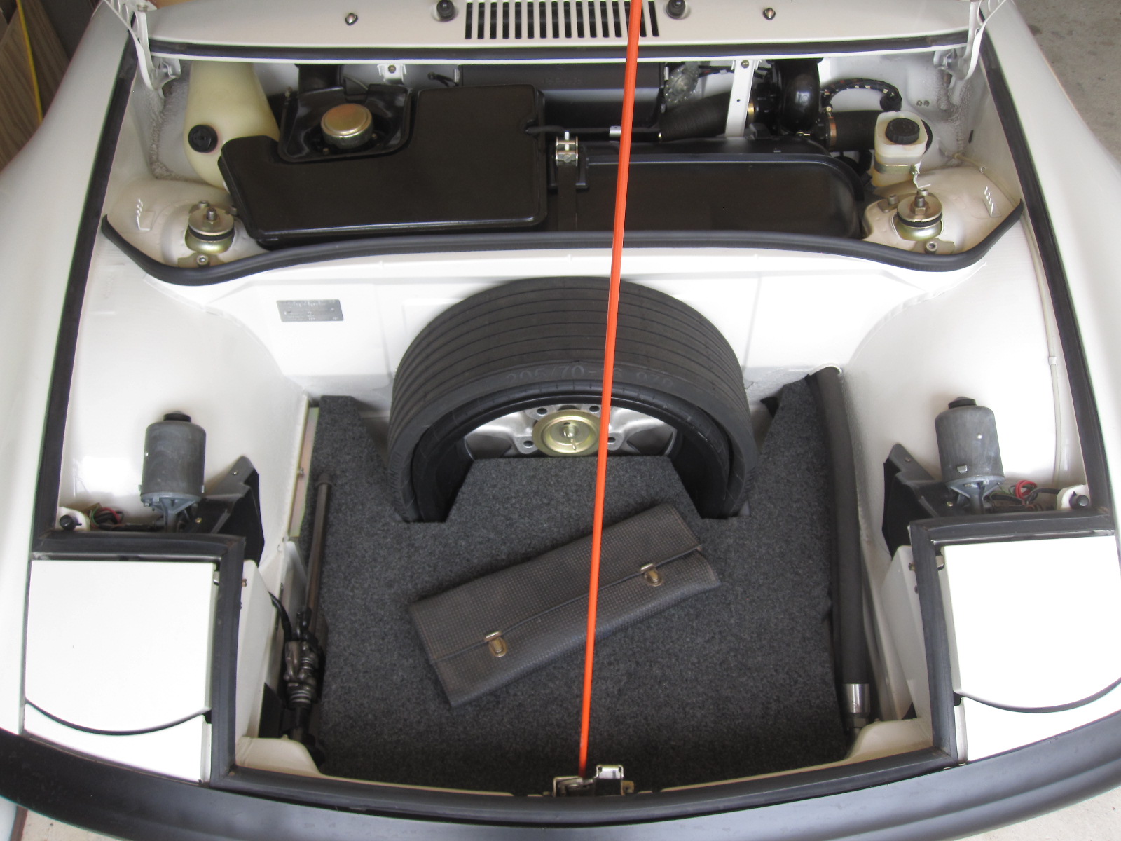

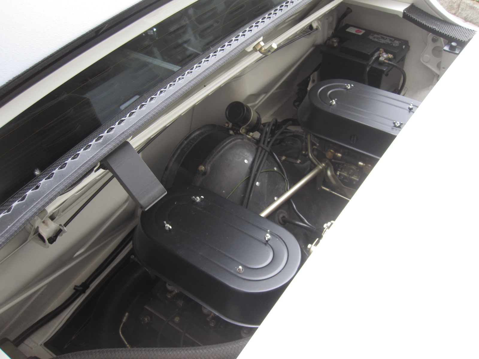

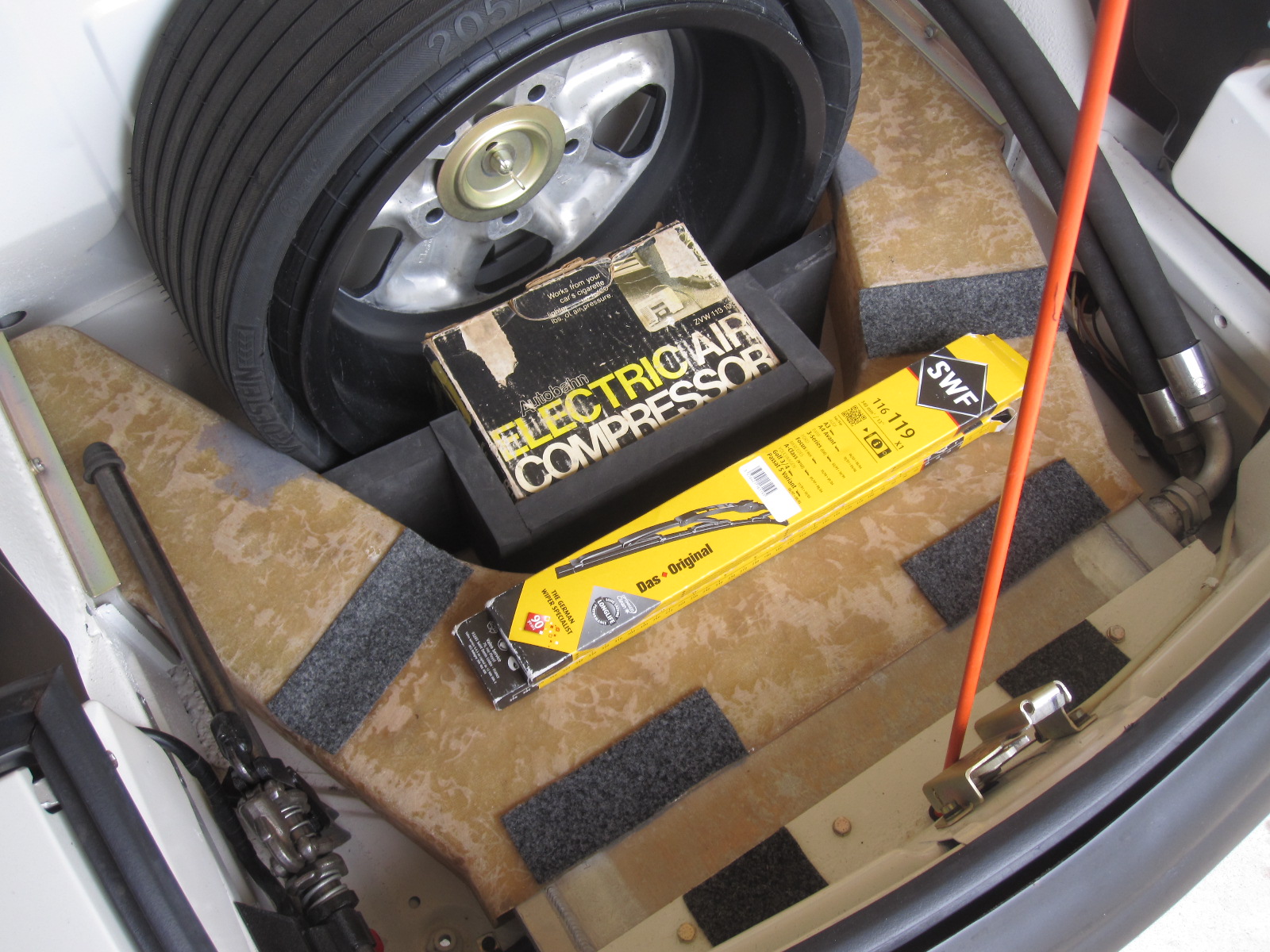

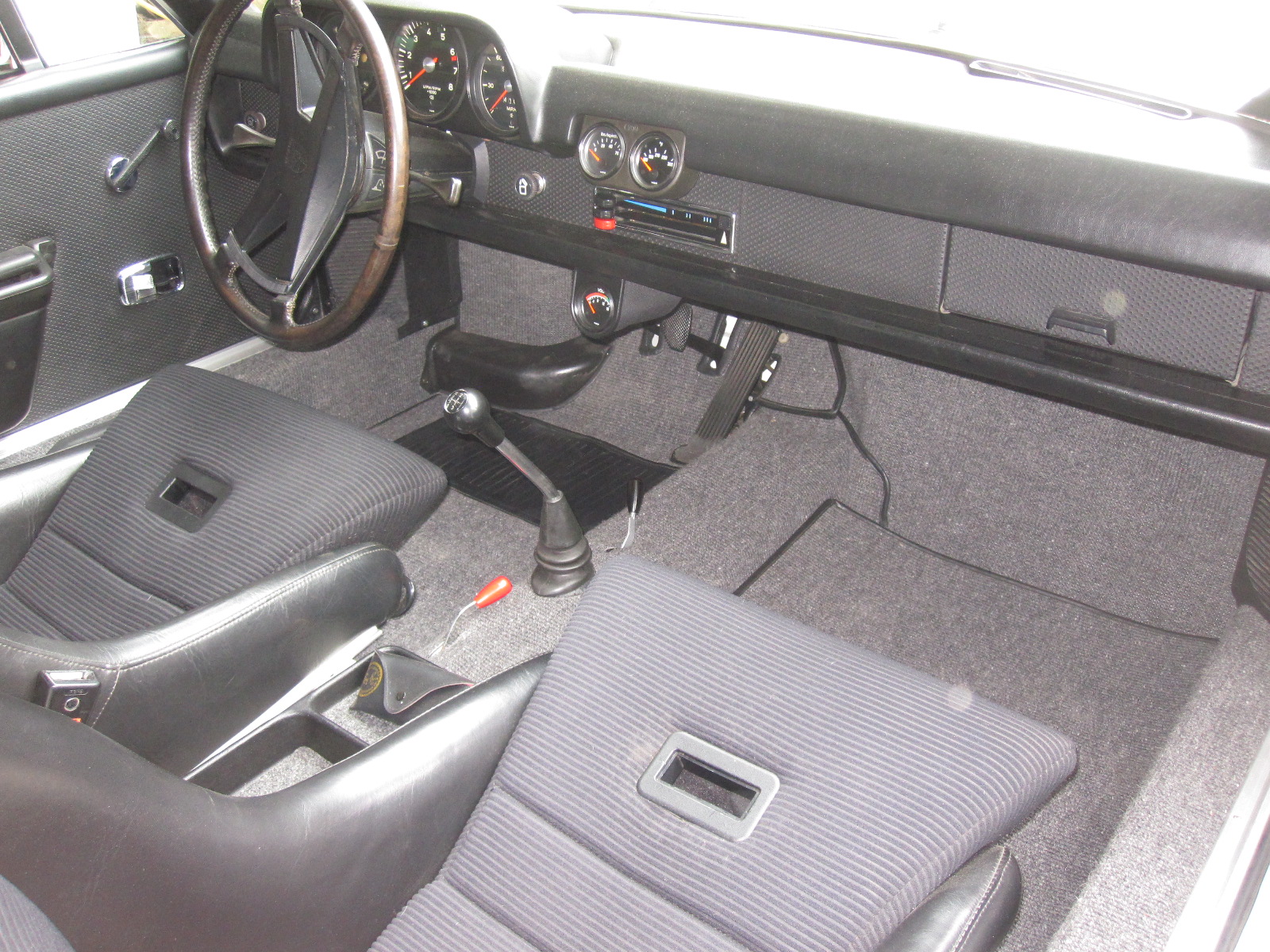

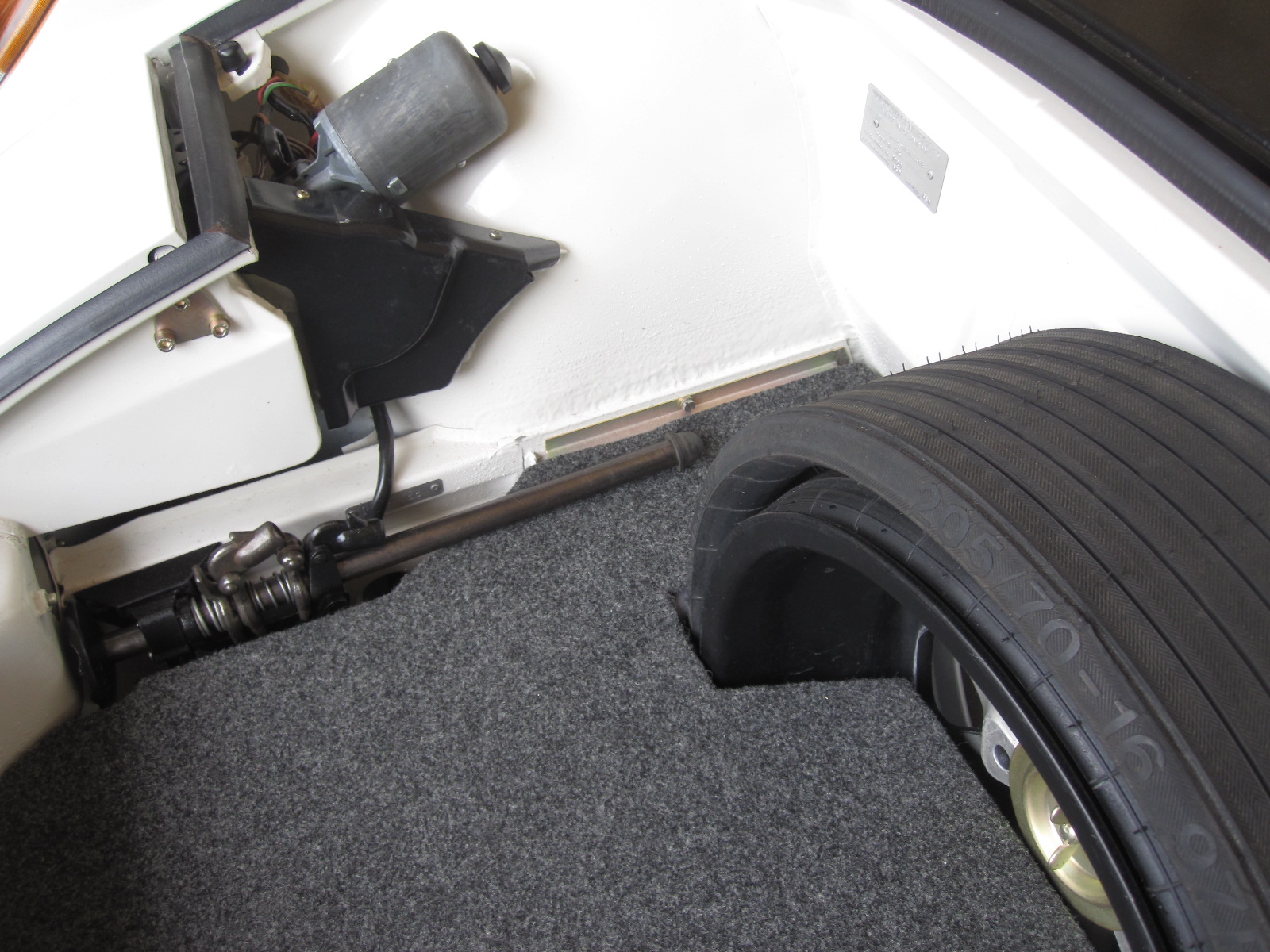

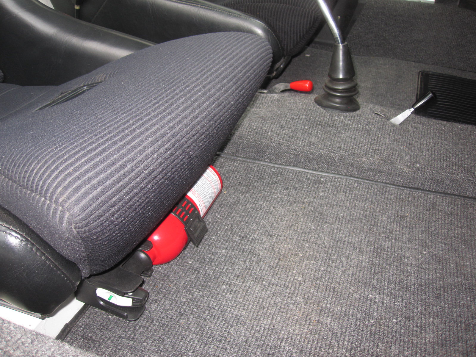

I never posted pics of the complete trunks and interior of my project.
Check my $3.00 fiberglass hood props. And filthy tool kit.

more

Interior and trunks look great.

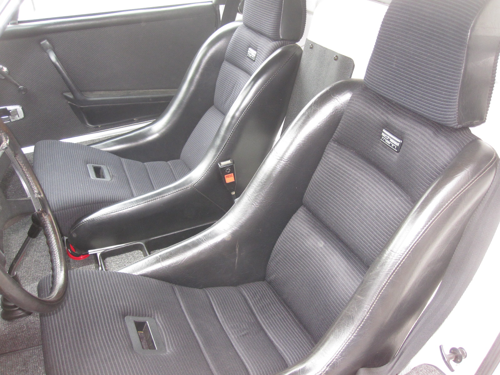

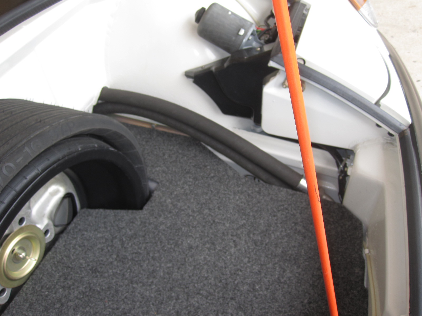

some more

QUOTE(rgalla9146 @ May 28 2020, 03:47 PM) *
some more
Great build! Pardon me if you already said, but where did you score the vintage Scheel seats? Let me guess, was that from Hershey years ago as well? (IMG:style_emoticons/default/smile.gif)

QUOTE(stevesc_us @ May 28 2020, 07:06 PM) *
some more
The seats ...hard to believe but they were either given to me or I paid a couple hundred
for them from a friend who owned the first hot rod 914 I worked on.
For years they were stored in my loft while I dreamed or the car to put them in.
I did have the inserts re-stretched and I made new Scheel/Mann buttons.

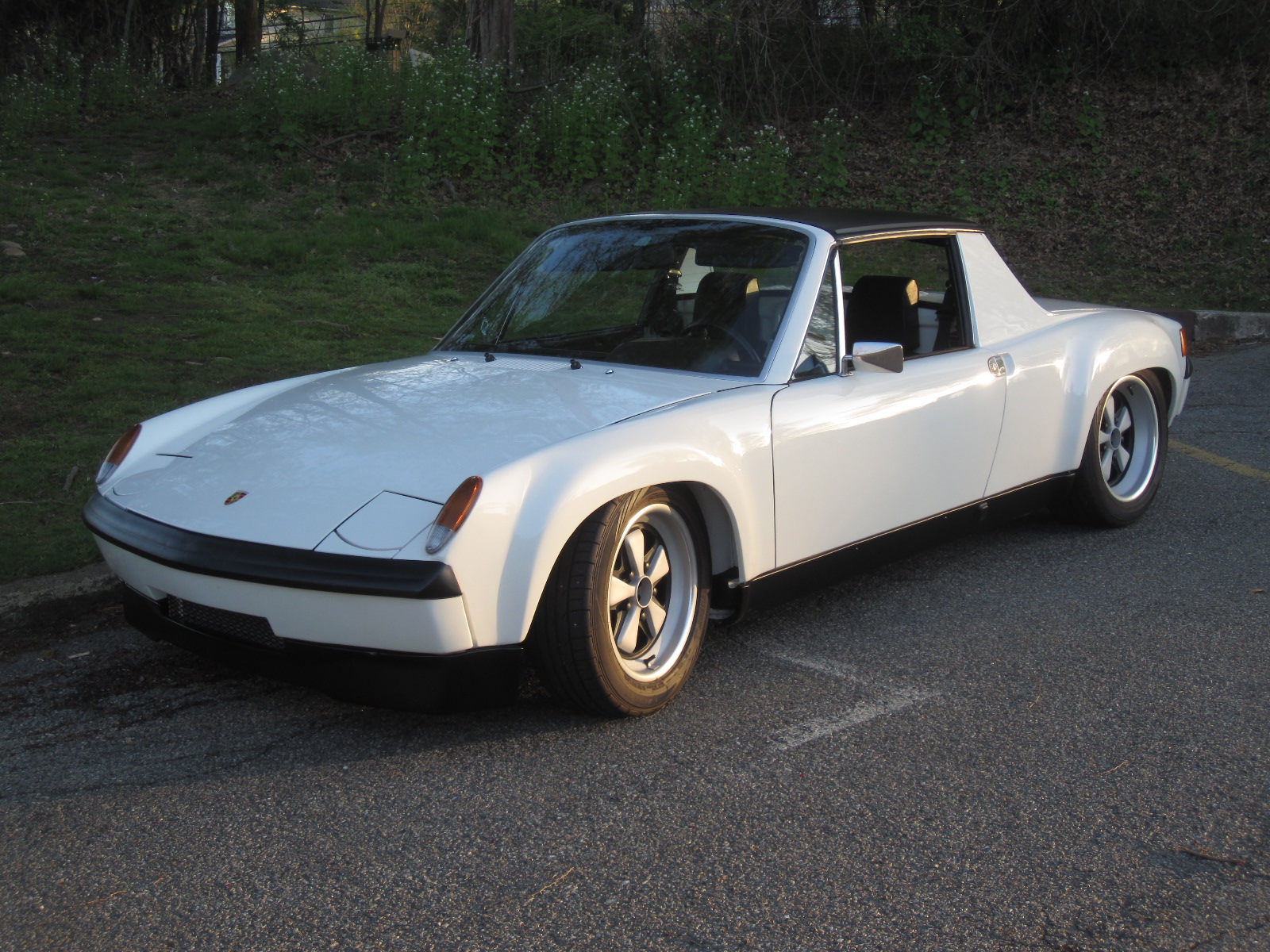

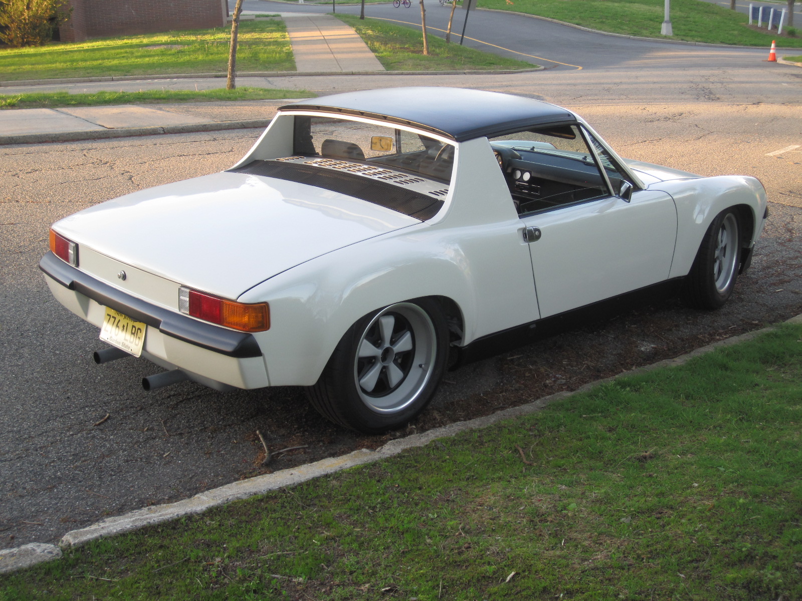

outside too
