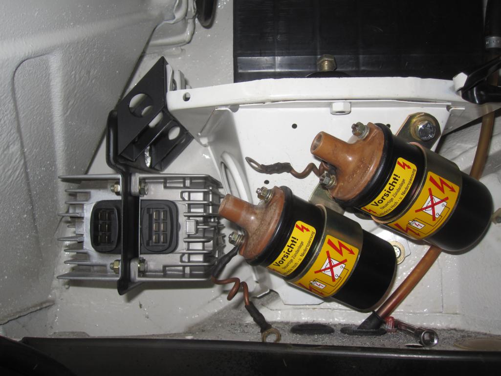

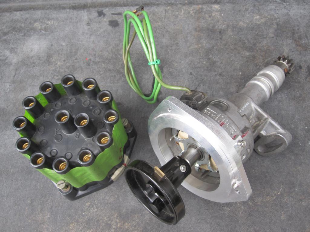

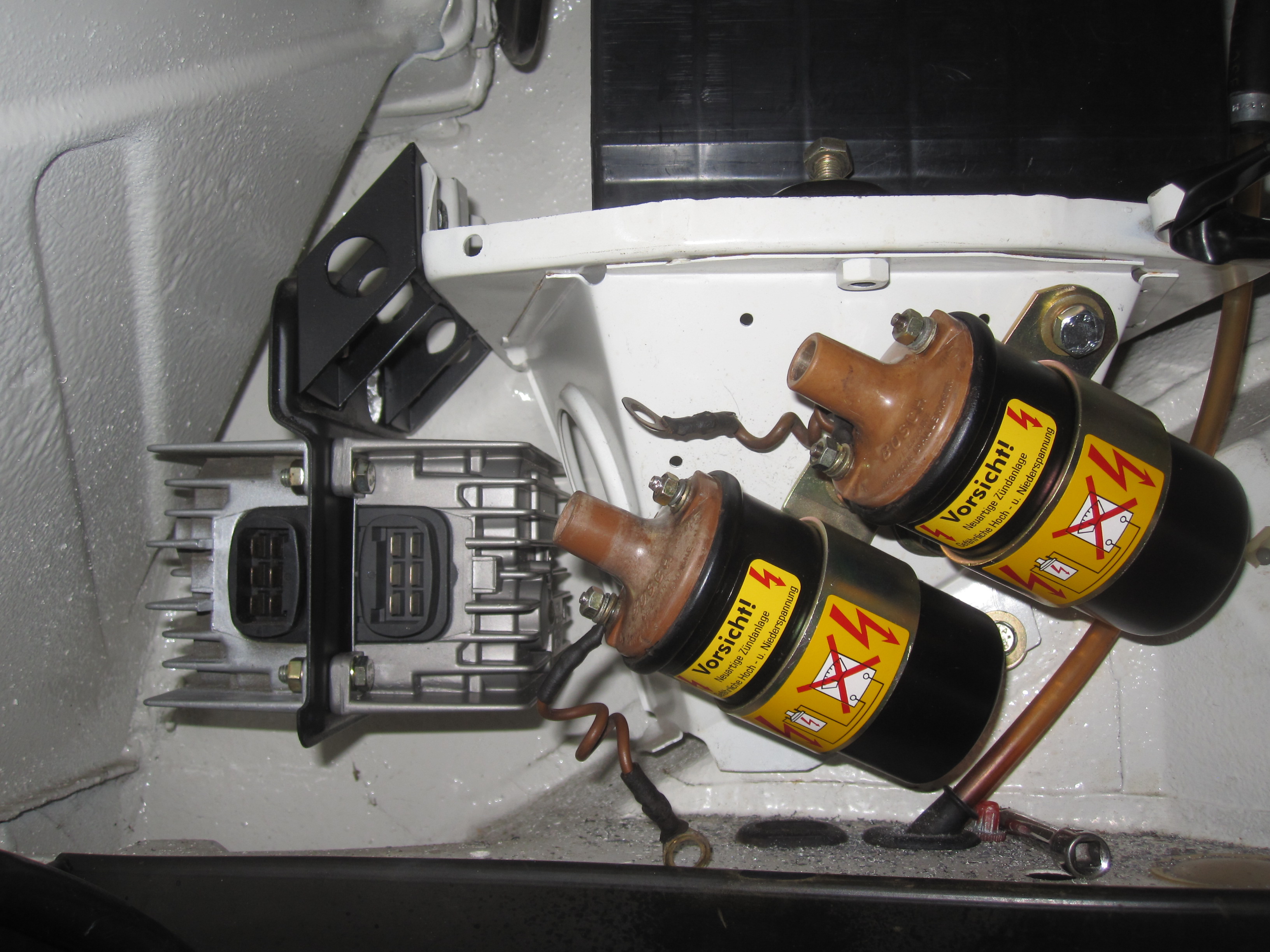

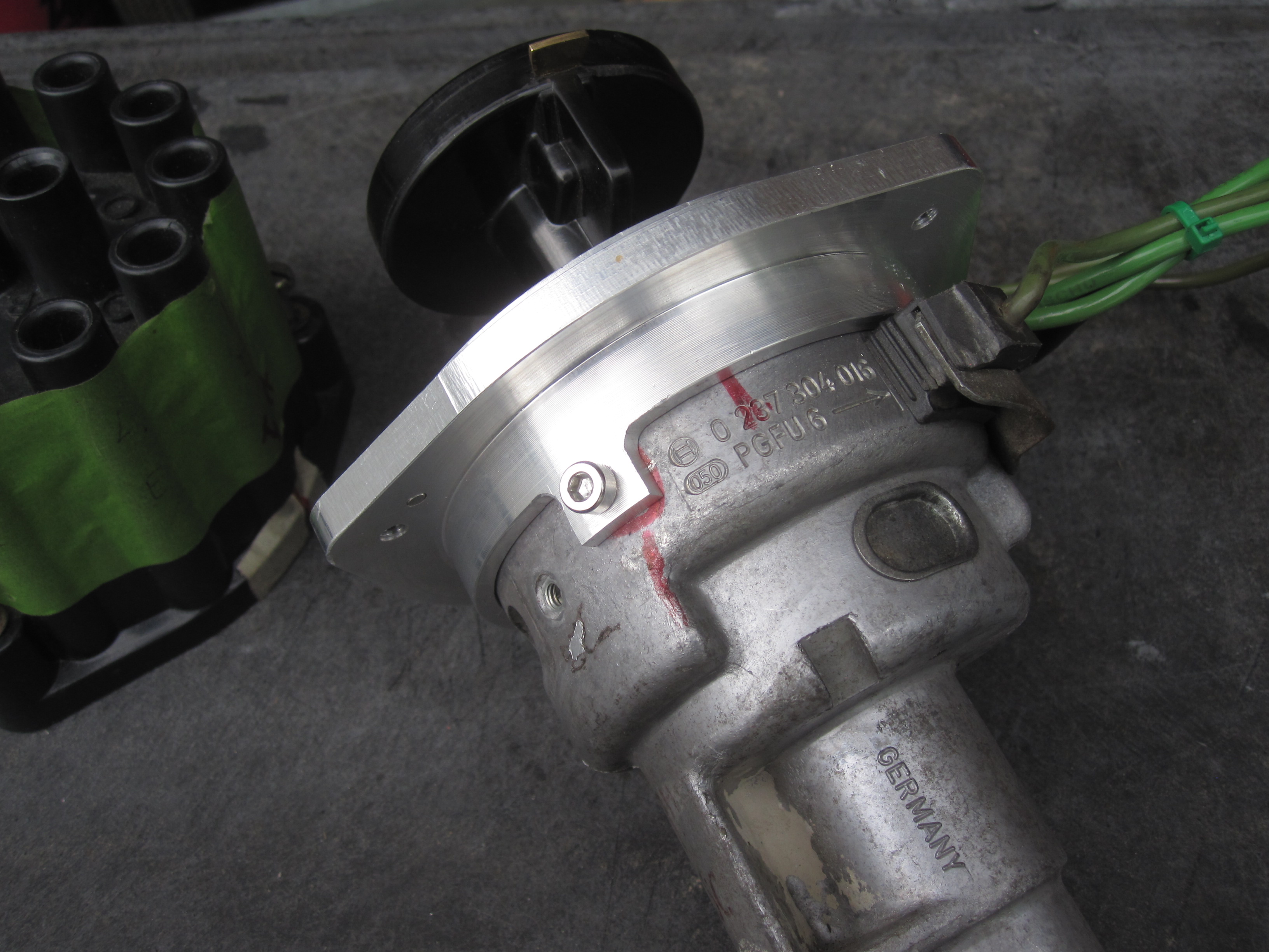

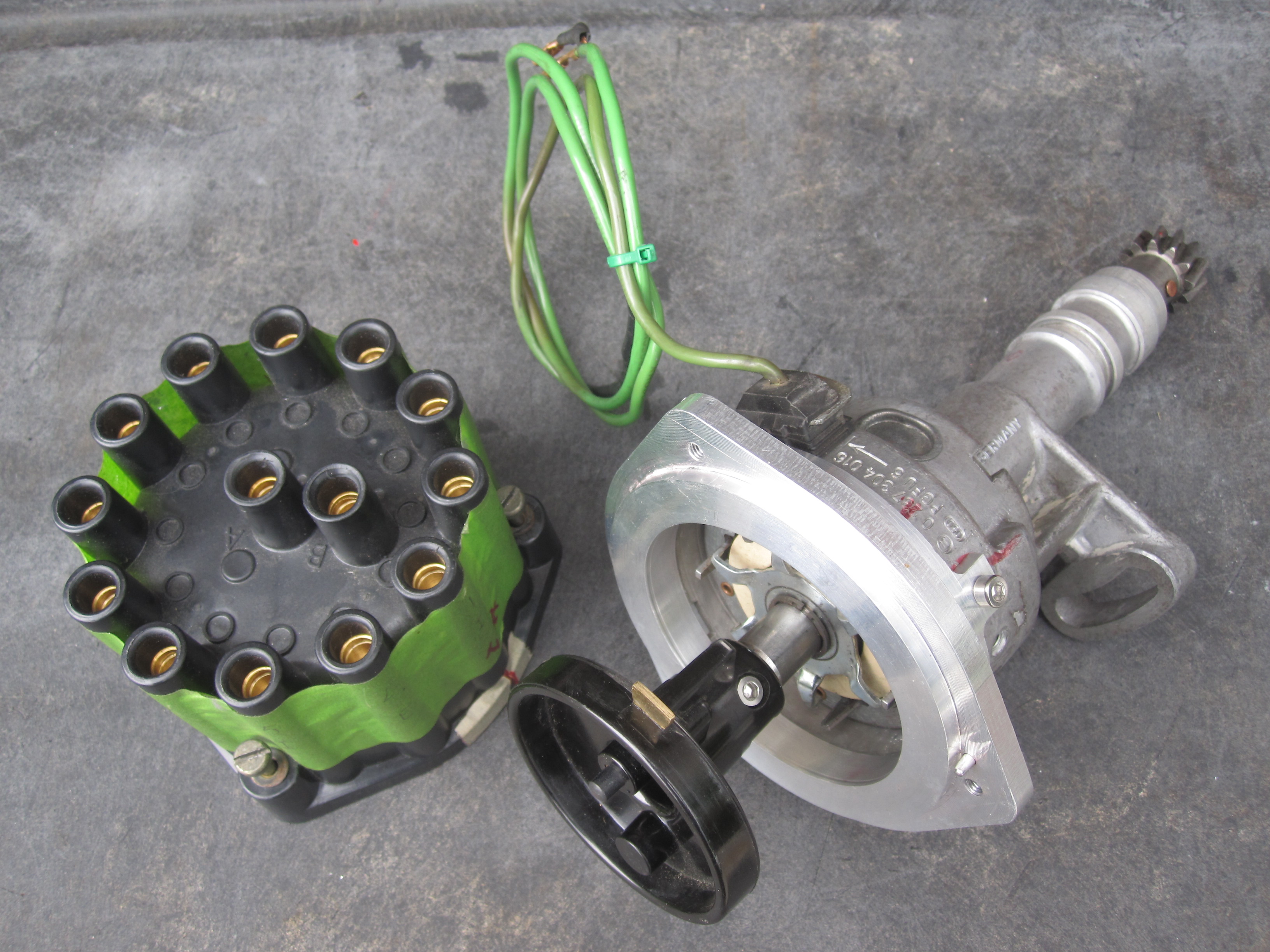

Pictured is the dizzy I dreamt up.
It's a Bosch 911SC unit rebuilt and re-curved by J Woods
I had a machinest whittle up adapters to mount a Maserati cap and rotor.
It will work with two 6 pin Bosch CD units and two 001 Bosch coils

QUOTE(flyer86d @ Aug 27 2022, 03:18 PM) *
Congratulations on getting it running on the engine stand! I had a similar 12 plug cap to SC distributor adapter the was fabricated by Rich Jascik way back when. It worked perfectly.
Charlie
Hey Charlie
I actually started it on the recurved dizzy w 6 plugs only
Had issues with the adapted 12 plug dizzy yesterday so went with plan B
What a great day.
The vid is actually the second start......I had run it out of gas on the first....
DOH !!!
Rory

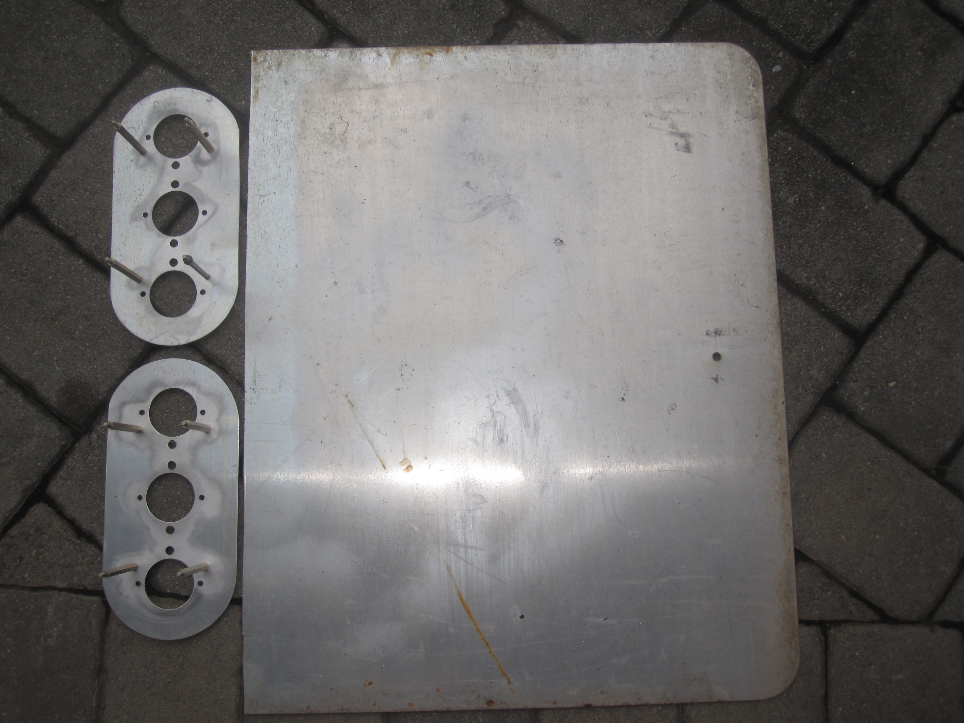

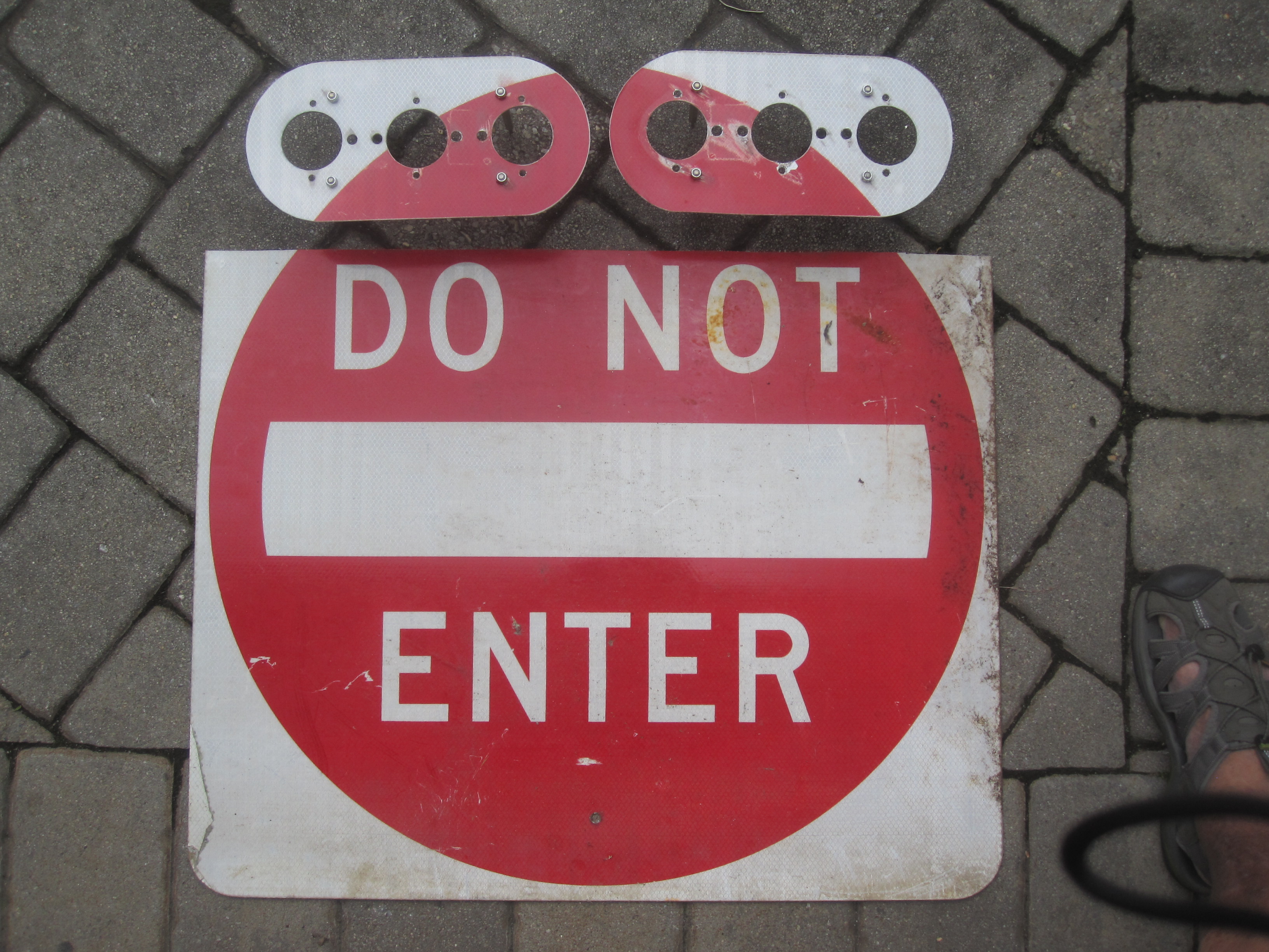

I needed air filter bases for my PMO 46s. They're not the same as for Weber 40s
I just couldn't wait for the proper ones to arrive.
jd74914
post Aug 8 2023, 08:21 AM
Post #312
Its alive
Posts: 4,891
Joined: 16-February 04
From: CT
Member No.: 1,659
Those are even better than the manufactured ones!
I love seeing street signs reused for fabrication-always a good story (unless they are riveted to the floor).

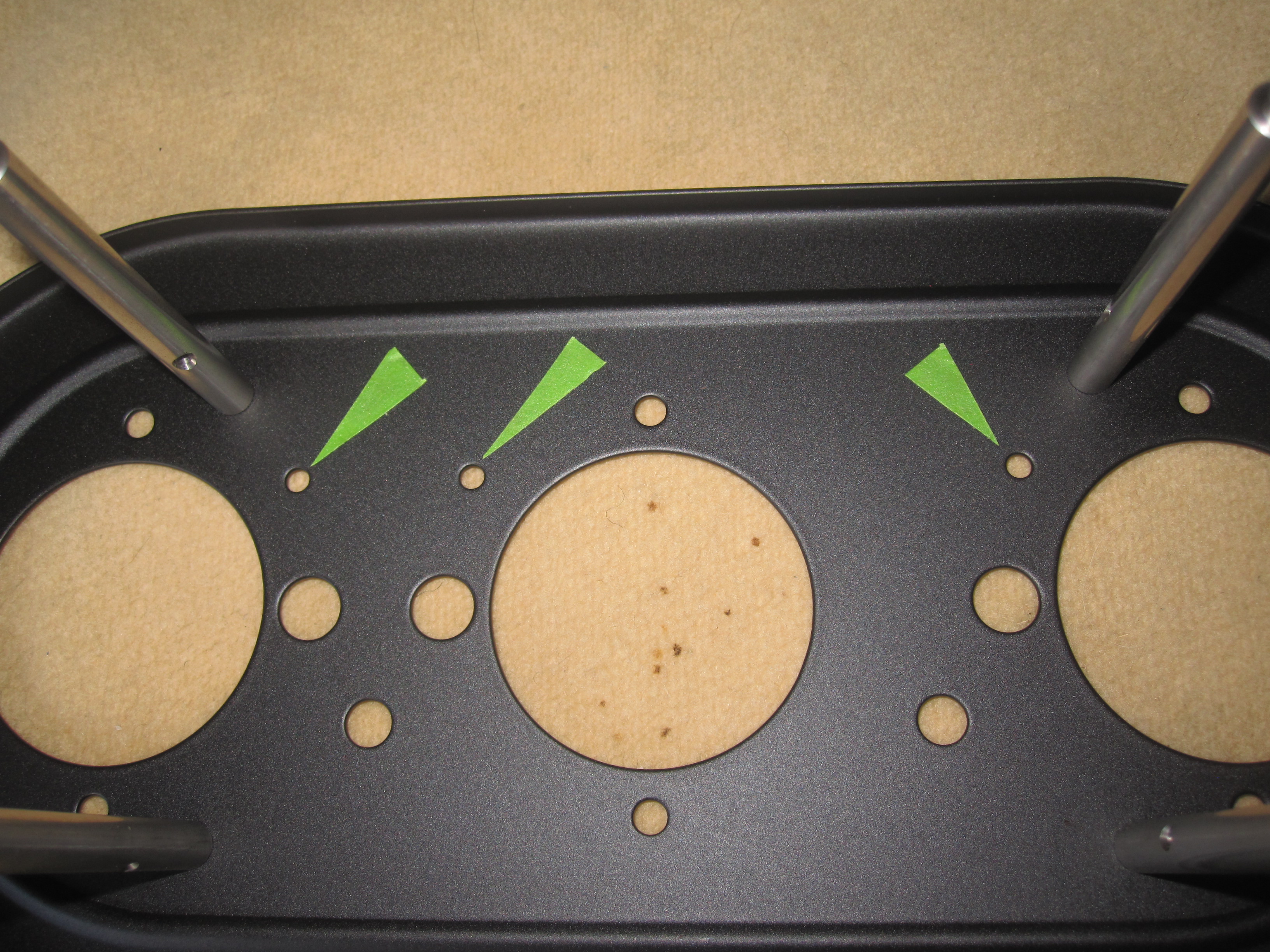

Caution !
My temporary parts have an important omission.
I failed to drill holes that are important vents for the idle circuit.
If you choose to make your own bases be sure to include all the holes that are seen
in the top gasket.
I made these quickly only to avoid driving my car without filters.
I now have the available bases.

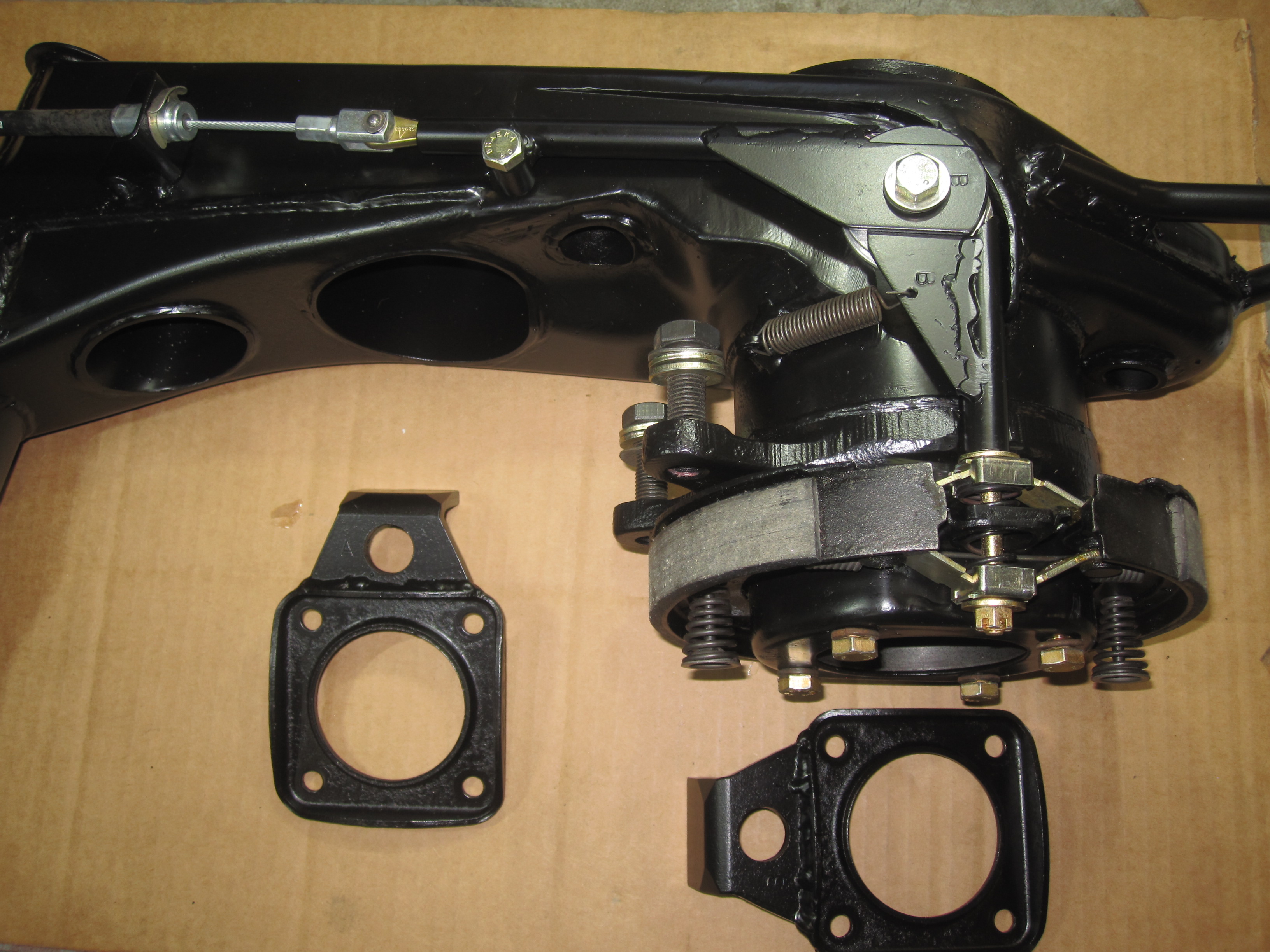

My latest project.
I needed to move my ebrake cables away from the heat exchangers / headers.
As has been known for years, 911 parts provide the answer.
I wanted to make them work as they do on a 911.
The mechanism has to provide a push/pull motion.
My solution is a pivoting arm with a pulley and a shorter 'pusher' arm.
The small spring is to prevent rattle.
The trailing arms were further modified with strengthning features and trailering /towing
loops as I had done on an earlier pair.
Not exactly a KISS answer but I love DIY ideas.

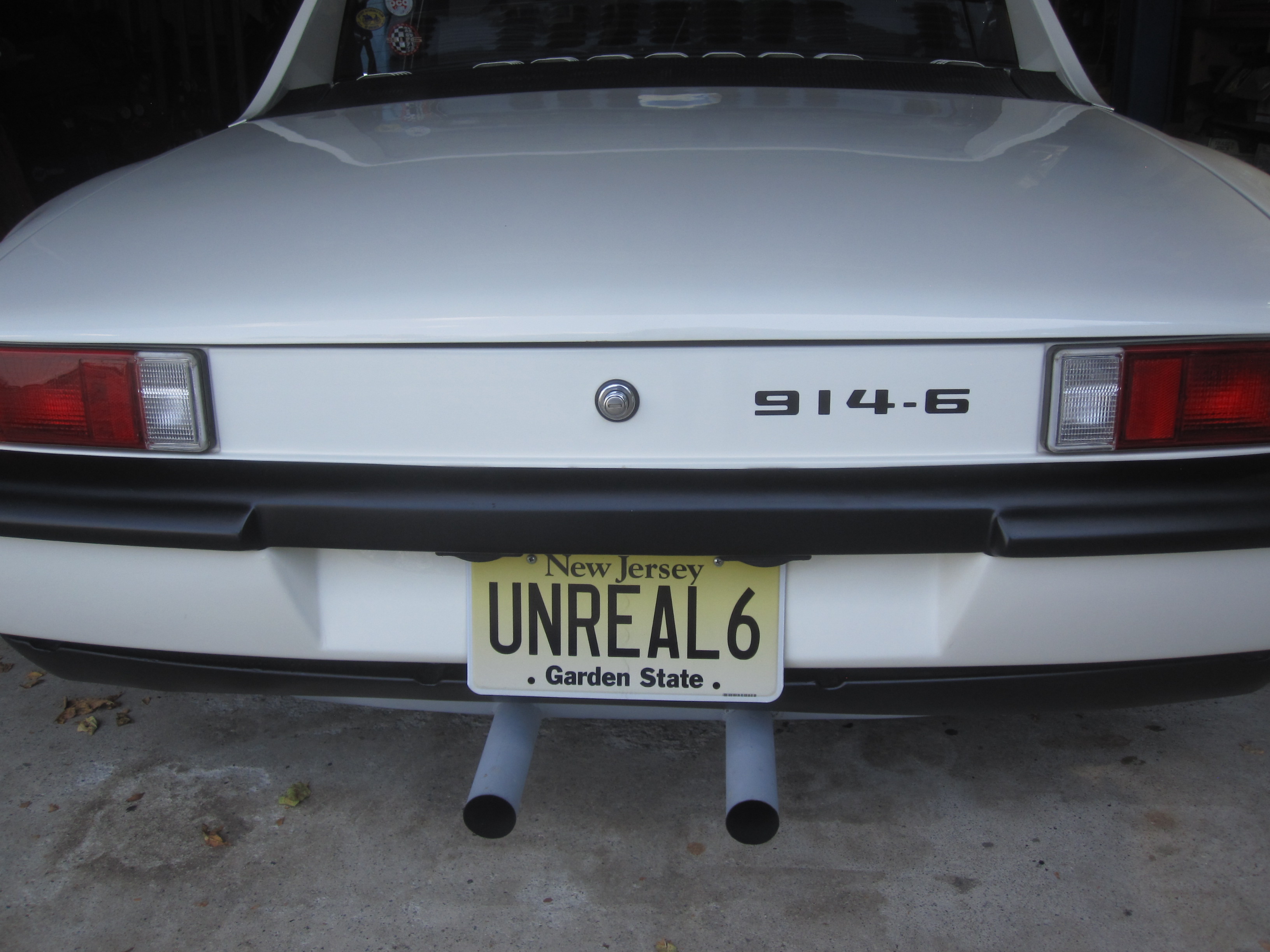

Added a vinyl emblem to the car similar to those seen only on 1976 914's
Nice weight savings compared to OE 914 6 emblem (IMG:style_emoticons/default/biggrin.gif)

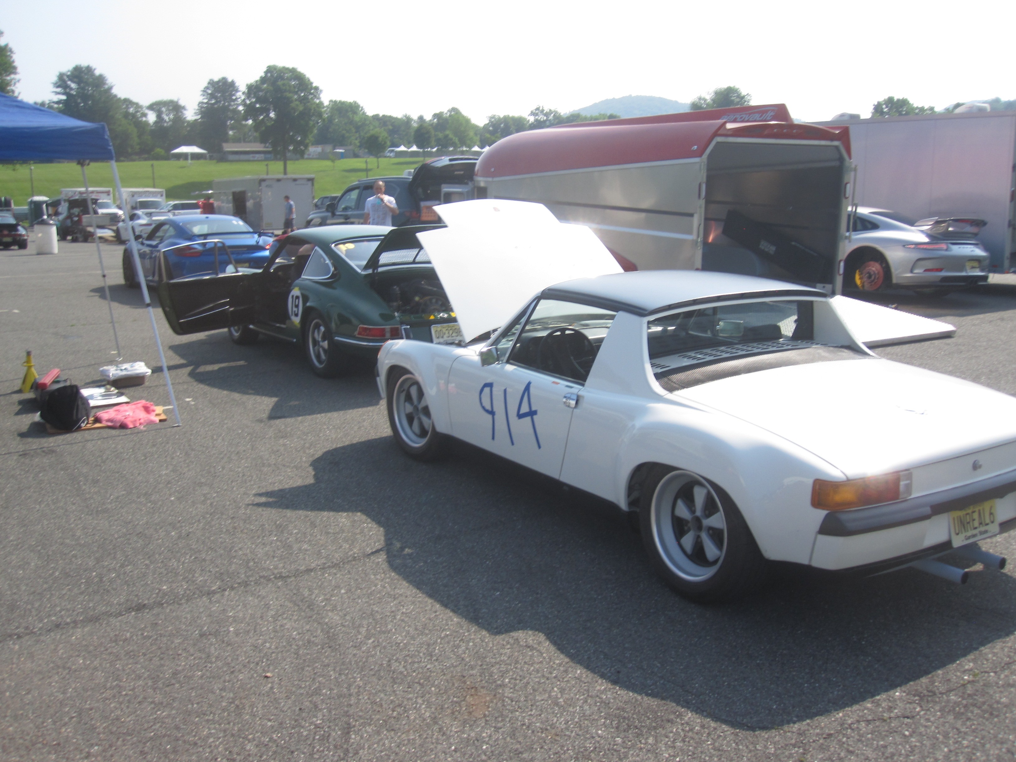

I had to take a break from the 3.2 SS after damaging my Mahles by flooding with gas.
The car has the '68 2.0 back in it with the 916 trans. It runs great and provided the
opportunity to get the gear shift linkage sorted. It was tedious but is quite good now.
I did my second NNJR DE at Lime Rock with it in July and loved it.
My instructor was there with his GT 3 so my car must have been like a lazy afternoon cruise for him.
He was actually very enthusiastic and surprised with the stable handling of the car.
At the end of the day he signed me off to solo and move up to yellow.
Over the winter I'll get the 3.2 back together and probably head back to Ct. for another go at DE
