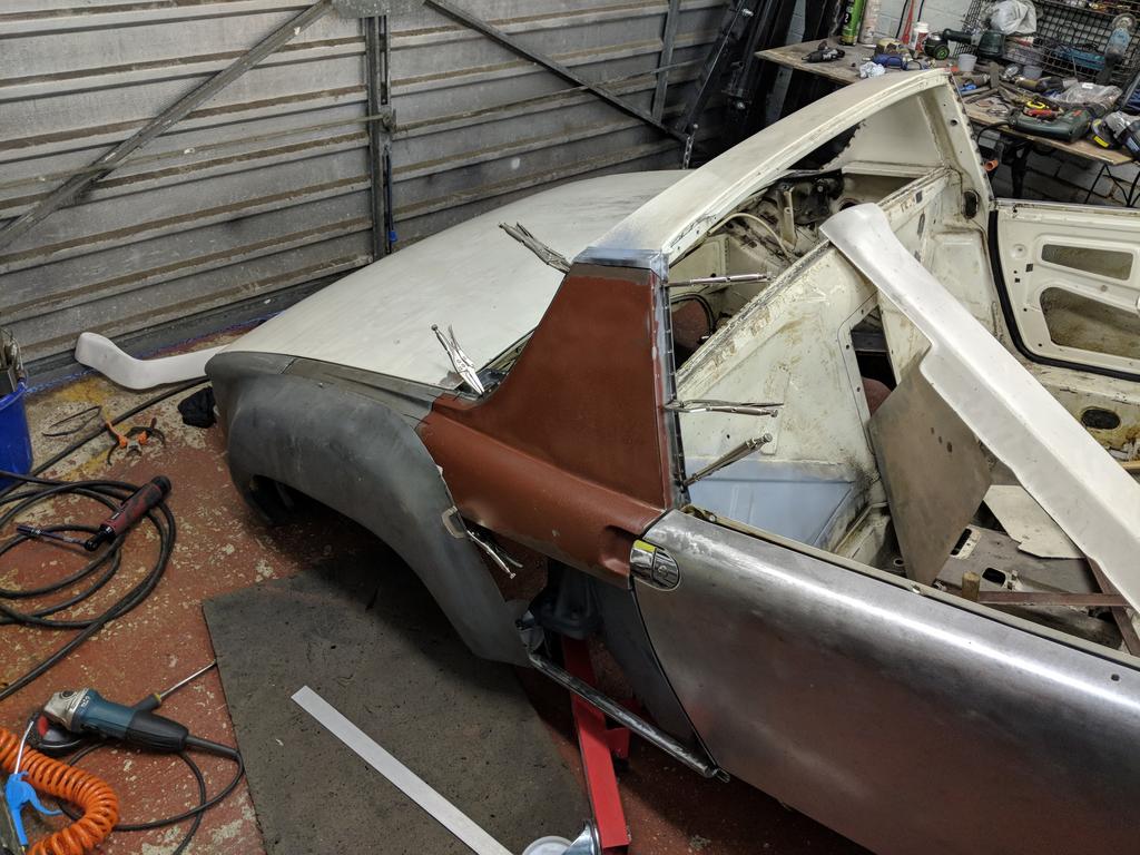

Right let's get back on track, it’s been a while.
Rewinding back a few months you saw that I replaced the lefthand sail panel but didn't finish off that rear quarter. This was supposed to be the easy side, but it turned out to be a bit of a nightmare.
Here's where we were.

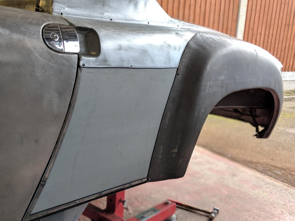

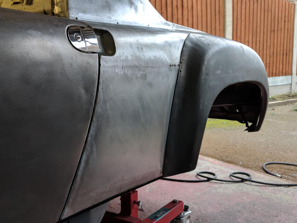

I took my door to a local metal fabricator and asked them if they could bend me a sheet of metal to the same profile. I would then be able to use that to fill in the hole on the rear quarter. Here's what they made for me.
(IMG:http://www.914world.com/bbs2/uploads_offsite/s6.postimg.cc-6621-1525881304.2.jpg)
It fitted perfectly.
(IMG:http://www.914world.com/bbs2/uploads_offsite/s6.postimg.cc-6621-1525881305.3.jpg)
Welded in and very happy with it.

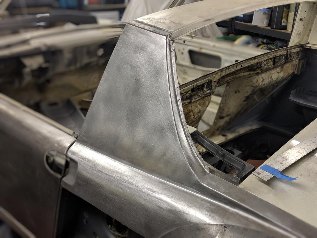

I just had to weld on the flare and I'd be done with the last corner of the car. But when I stood back to look over my work I realised I'd made a big mistake.

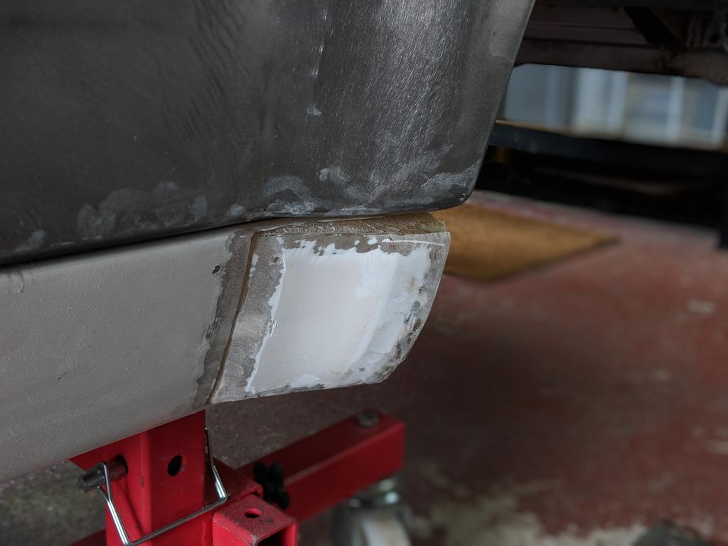

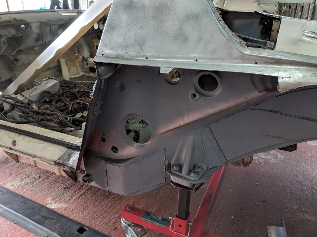

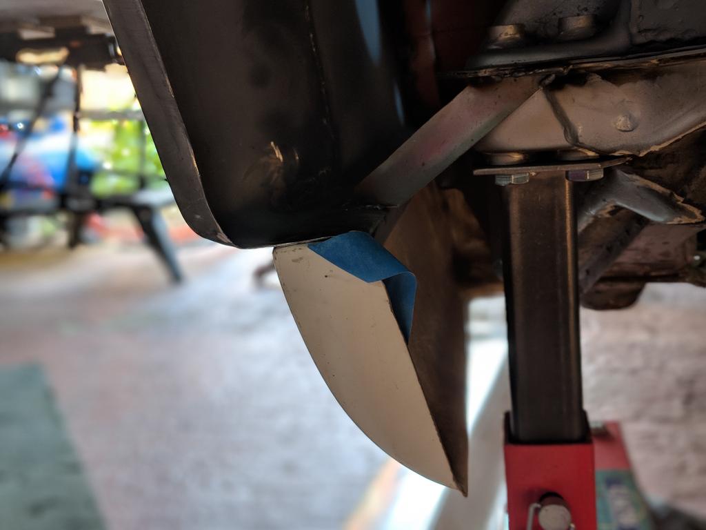

If you saw my post a few months back you'll remember this.
(IMG:http://www.914world.com/bbs2/uploads_offsite/s6.postimg.cc-6621-1525881317.1.jpg)
I remember the bottom of the rear quarter got caught and bent on the axle stand. I thought I'd straightened it, but I obviously didn't do a very good job.
Here's a straight edge up against the bottom of the rear quarter. :shock: Yeah, that won't do.
(IMG:http://www.914world.com/bbs2/uploads_offsite/s6.postimg.cc-6621-1525881318.2.jpg)
Try as I might I just couldn't fix this, I made a section to replace the bent edge but then went and proceeded to totally mess it up welding it in place.
(IMG:http://www.914world.com/bbs2/uploads_offsite/s6.postimg.cc-6621-1525881318.3.jpg)
Frustrated I closed the garage door and left it for a while. Actually that while turned into a few weeks, but during that time I managed to source a used half rear quarter to replace what I'd messed up and I went on holiday.

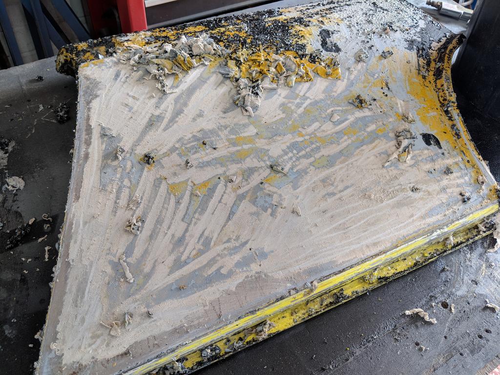

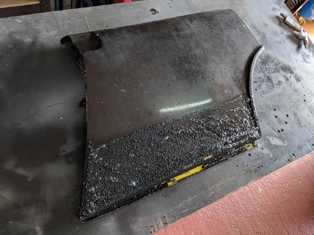

The replacement rear quarter panel had arrived and I intercepted it at the sorting office. Getting home I ripped the box open and lifted out the panel. (IMG:style_emoticons/default/sad.gif) I instantly knew something was wrong. An eighteen inch square piece of metal should not weigh anything near what this piece weighed.
I sprayed it liberally with paint stripper...
(IMG:http://www.914world.com/bbs2/uploads_offsite/s6.postimg.cc-6621-1525881333.1.jpg)
That's not metal (IMG:style_emoticons/default/sad.gif)
(IMG:http://www.914world.com/bbs2/uploads_offsite/s6.postimg.cc-6621-1525881334.2.jpg)
That's metal (IMG:style_emoticons/default/sad.gif)
(IMG:http://www.914world.com/bbs2/uploads_offsite/s6.postimg.cc-6621-1525881335.3.jpg)

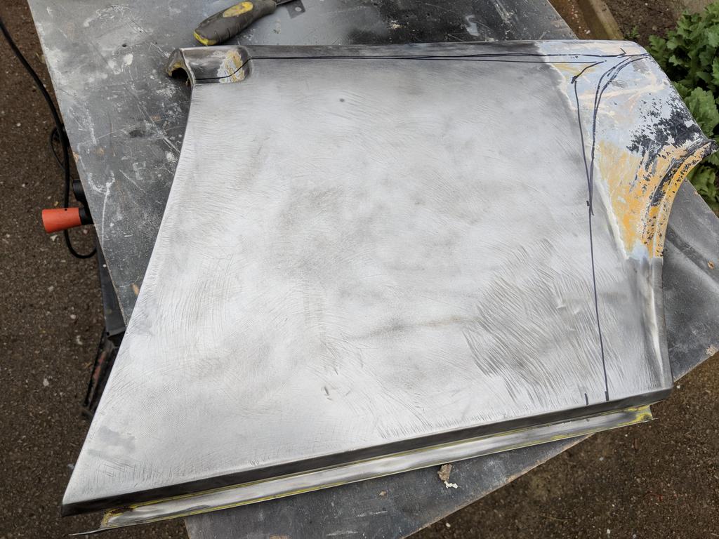

Once all that s*&t was removed I ended up with this.
(IMG:http://www.914world.com/bbs2/uploads_offsite/s6.postimg.cc-6621-1525881336.4.jpg)
Not the prettiest of panels but most importantly rust free. All that filler was hiding just that dent on the bottom right and most of that I'd be cutting off to install the flare. For the first time since opening the box I was starting to think this may just work.

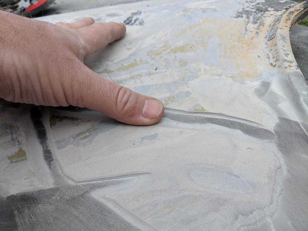

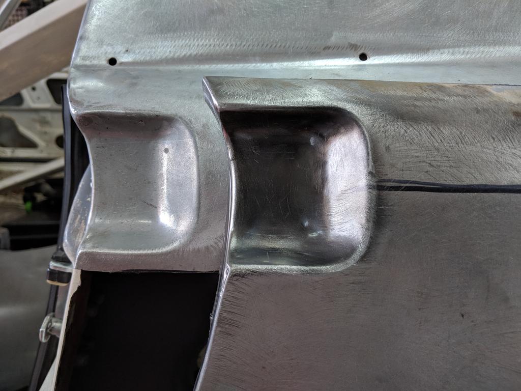

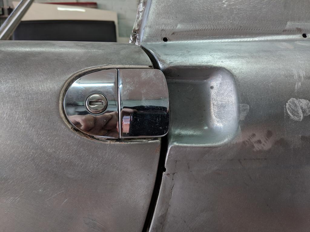

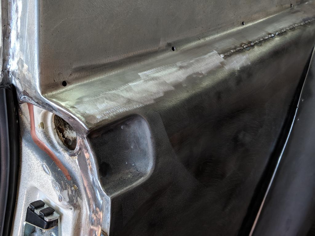

It was only now that I noticed something with my new sail panel I’d installed. The indentation for the door handle wasn’t quite the right shape. The more I looked at it the worse it got.
(IMG:http://www.914world.com/bbs2/uploads_offsite/s6.postimg.cc-6621-1525881353.1.jpg)
Here it is compared to the original on the replacement piece I got.
(IMG:http://www.914world.com/bbs2/uploads_offsite/s6.postimg.cc-6621-1525881354.2.jpg)
Now I know it’s not a million miles off but it’s off enough to warrant replacement. So I cut it out and used all of the used panel I could.
(IMG:http://www.914world.com/bbs2/uploads_offsite/s6.postimg.cc-6621-1525881354.3.jpg)
Already looking better
(IMG:http://www.914world.com/bbs2/uploads_offsite/s6.postimg.cc-6621-1525881355.4.jpg)
(IMG:http://www.914world.com/bbs2/uploads_offsite/s6.postimg.cc-6621-1525881355.5.jpg)
New support fabricated and welded in. Getting this the right shape and size was a little tricky but after measuring multiple times welding in this support made everything measure true to the other side.
(IMG:http://www.914world.com/bbs2/uploads_offsite/s6.postimg.cc-6621-1525881356.6.jpg)

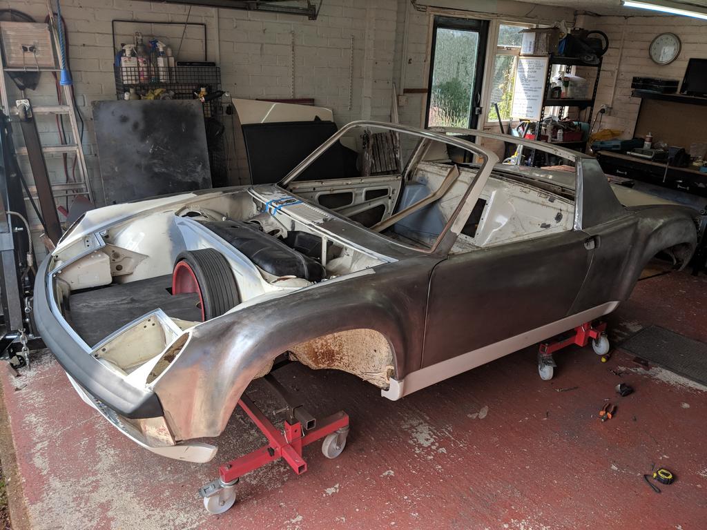

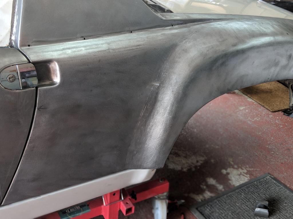

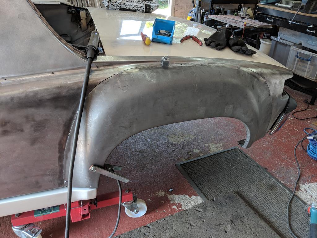

And then finally time to install the last flare.
(IMG:http://www.914world.com/bbs2/uploads_offsite/s6.postimg.cc-6621-1525881370.1.jpg)
(IMG:http://www.914world.com/bbs2/uploads_offsite/s6.postimg.cc-6621-1525881371.2.jpg)
The arrow drawn on is a reminder to adjust the door gap slightly.
Finally back in one piece!
(IMG:http://www.914world.com/bbs2/uploads_offsite/s6.postimg.cc-6621-1525881371.3.jpg)
I’m so pleased to be at this stage now. It’s been way more of a job that I ever imagined. The ‘to do’ list before paint is now finally just a few small things.

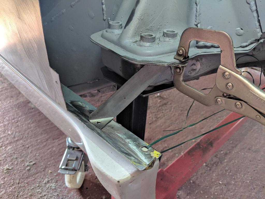

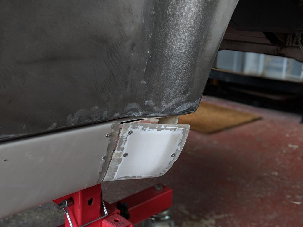

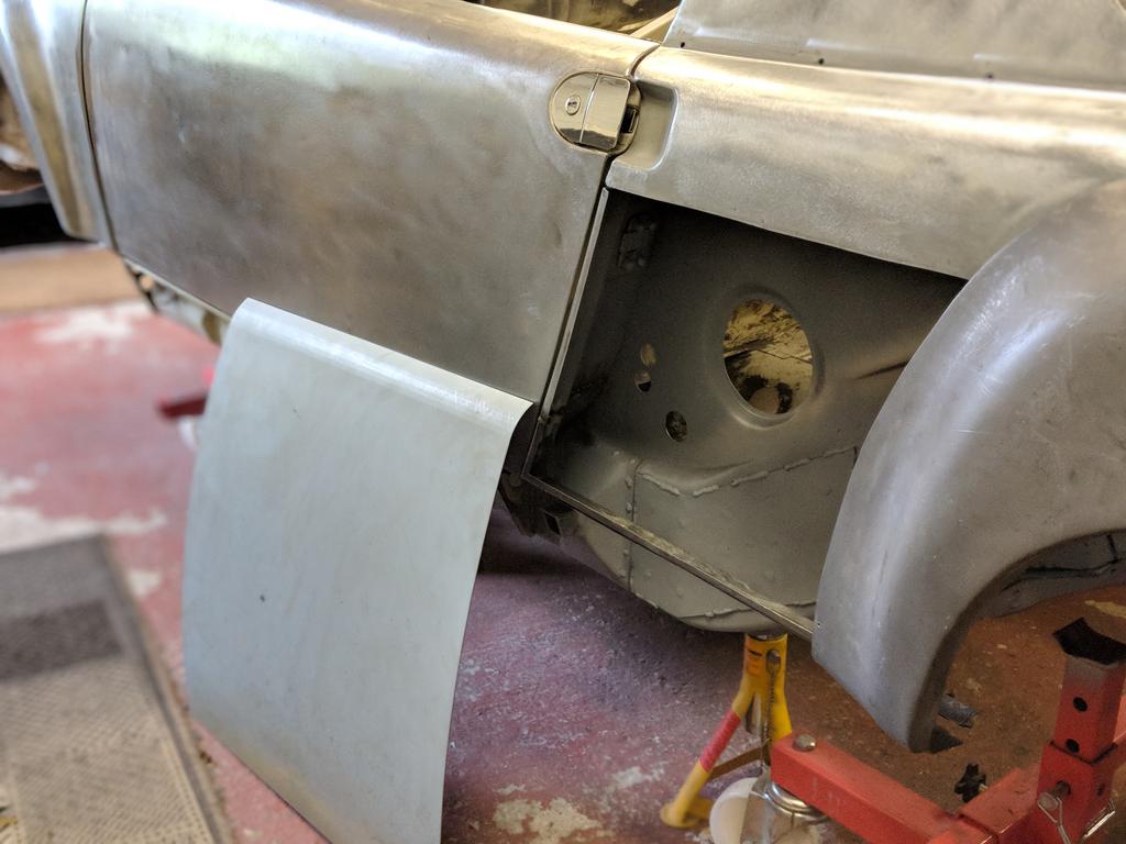

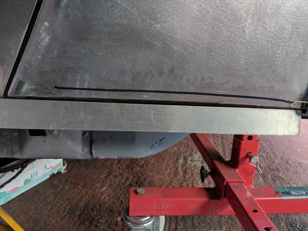

The next stage has been fitting the rocker panels. It was obvious on purchase these would need a fair amount of fettling to fit correctly. I've never fibreglassed anything before so once again I hit up YouTube and sought out a few tutorials. Armed with just about enough knowledge I ordered up the relevant supplies and set to the job.
Whilst the lefthand one fitted well enough to the car the righthand one didn't - the top edge was at the wrong angle and pushed it up into the door. You can see in the pic below, there was no gap at all and bottom of the door scraped on it when opened.
(IMG:http://www.914world.com/bbs2/uploads_offsite/s6.postimg.cc-6621-1526576375.1.jpg)
It's difficult to capture but you can just make out that top part slopes down too much.
(IMG:http://www.914world.com/bbs2/uploads_offsite/s6.postimg.cc-6621-1526576376.2.jpg)
In the end I decided to cut off the top section and then reattach it at the correct angle. I took several measurements along the length before cutting and decided the edge needed to be 5mm higher to be at the correct angle. These struts held everything in place so I could fibreglass under the lip. Once set I then had both sills ready to fit too the arches.
(IMG:http://www.914world.com/bbs2/uploads_offsite/s6.postimg.cc-6621-1526576377.3.jpg)

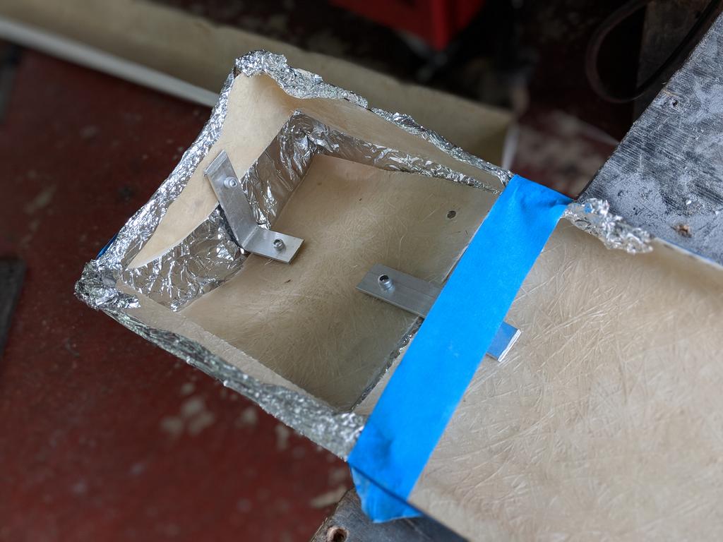

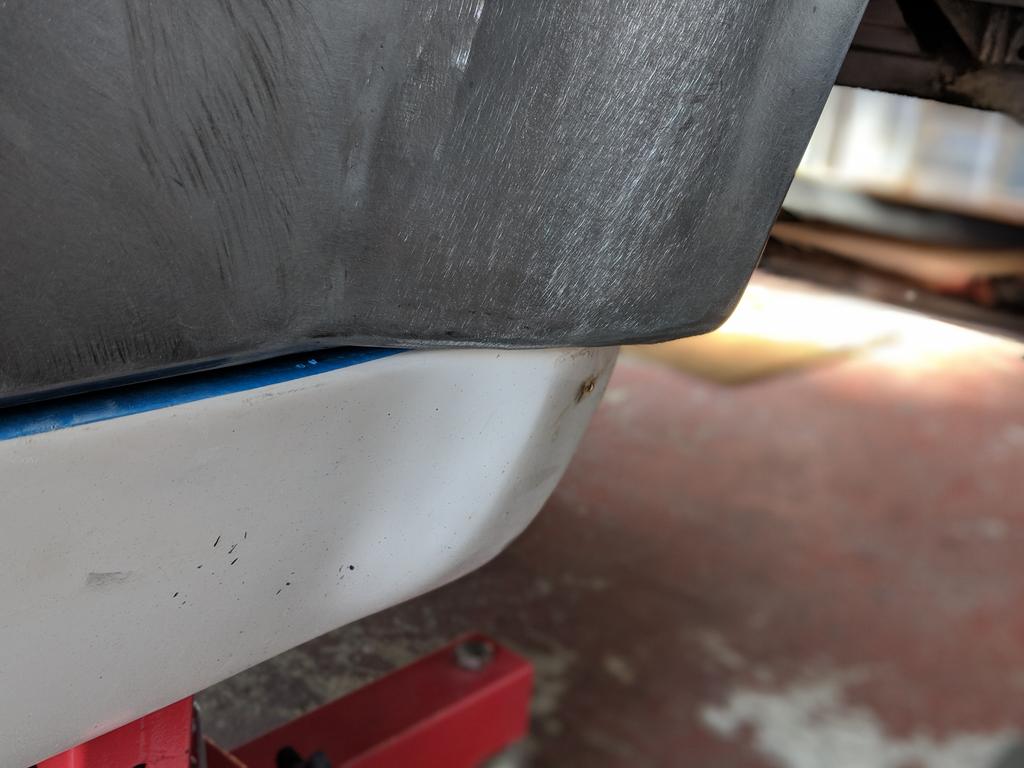

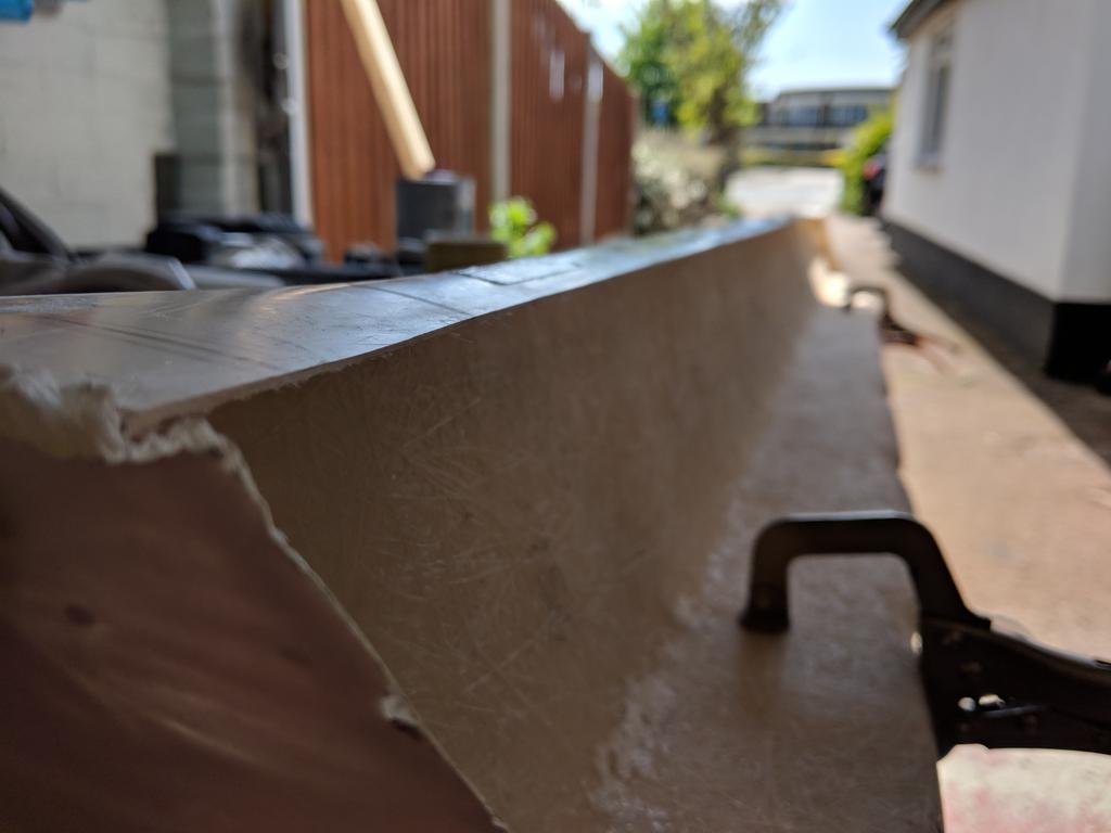

So here’s the fit out of box… I guess you could say, not even close!

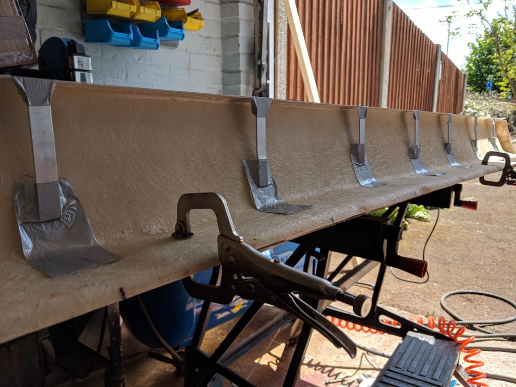

(IMG:http://www.914world.com/bbs2/uploads_offsite/s6.postimg.cc-6621-1526576397.1.jpg)
(IMG:http://www.914world.com/bbs2/uploads_offsite/s6.postimg.cc-6621-1526576398.2.jpg)

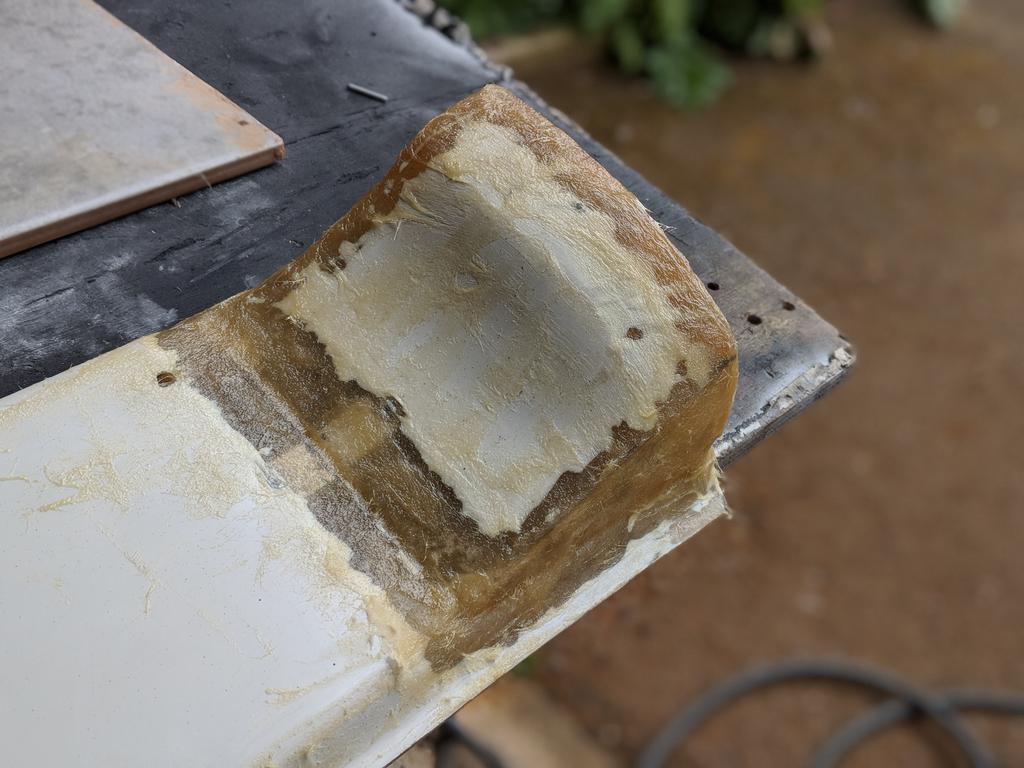

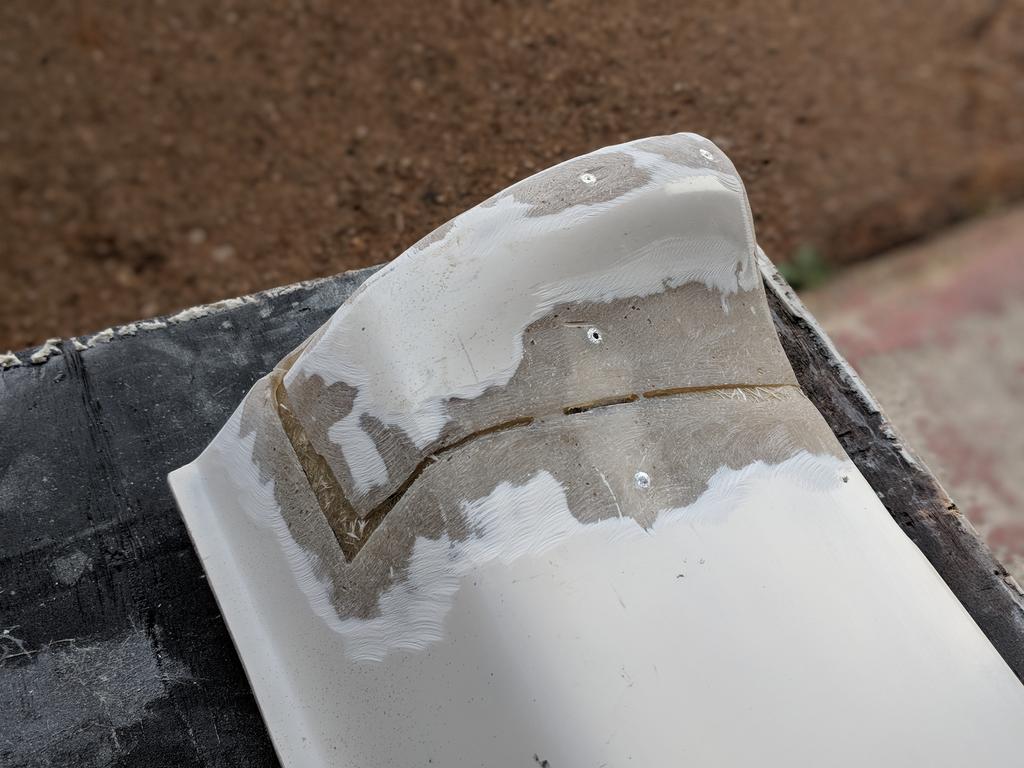

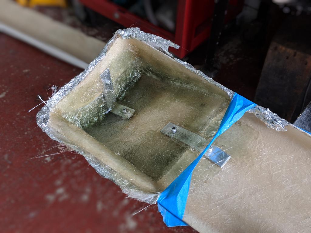

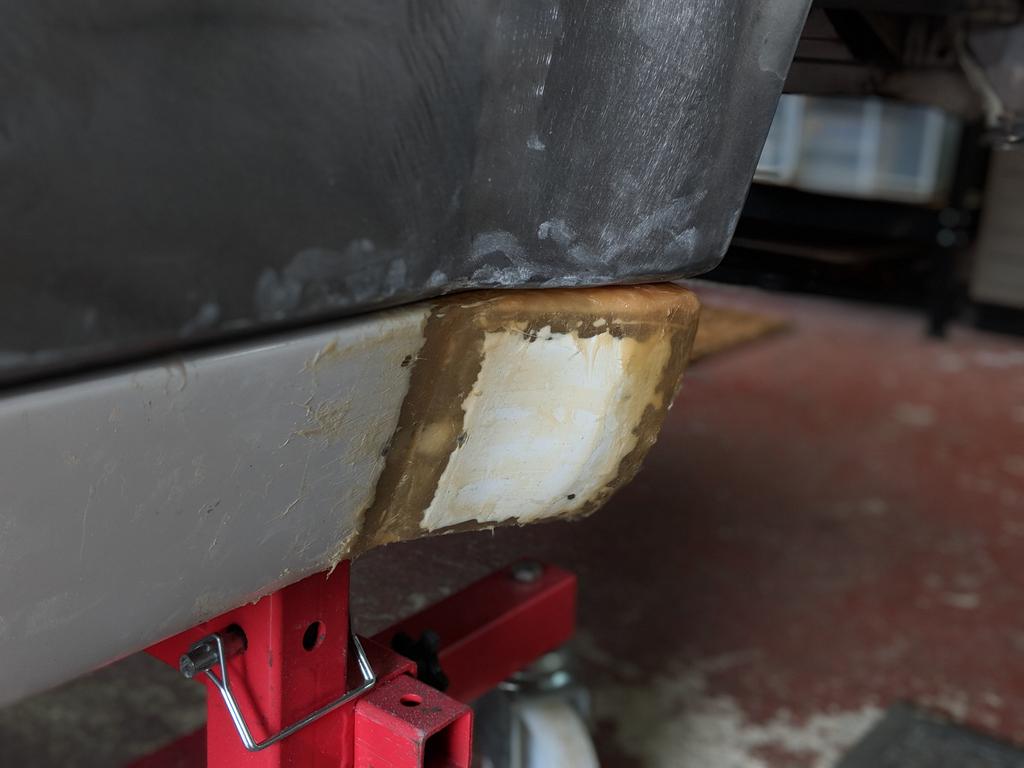

I scratched my head for a while went to work cutting it up. Then with thin aluminium strips for support I could bend everything to the correct shape.
You can see just how far I needed to move them to fit correctly.
(IMG:http://www.914world.com/bbs2/uploads_offsite/s6.postimg.cc-6621-1526576398.3.jpg)
I learnt that fibreglass doesn’t stick to aluminium foil so I used that as a backing in the first instance. I later found using duct tape a stronger method.
(IMG:http://www.914world.com/bbs2/uploads_offsite/s6.postimg.cc-6621-1526576399.4.jpg)
Resin starting to harden
(IMG:http://www.914world.com/bbs2/uploads_offsite/s6.postimg.cc-6621-1526576399.5.jpg)
Foil removed and offered up to the car for a test fit.
(IMG:http://www.914world.com/bbs2/uploads_offsite/s6.postimg.cc-6621-1526576400.6.jpg)

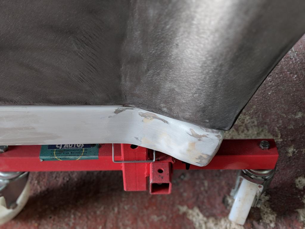

Next stage was bridging filler
(IMG:http://www.914world.com/bbs2/uploads_offsite/s6.postimg.cc-6621-1526576400.7.jpg)
Getting closer

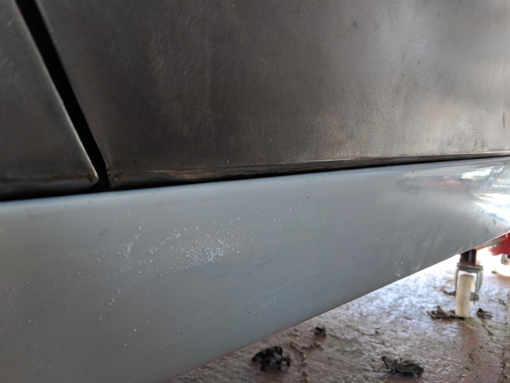

(IMG:http://www.914world.com/bbs2/uploads_offsite/s6.postimg.cc-6621-1526576401.8.jpg)
After sanding to shape and some body filler I was really pleased with the result.
(IMG:http://www.914world.com/bbs2/uploads_offsite/s6.postimg.cc-6621-1526576401.9.jpg)
(IMG:http://www.914world.com/bbs2/uploads_offsite/s6.postimg.cc-6621-1526576402.10.jpg)

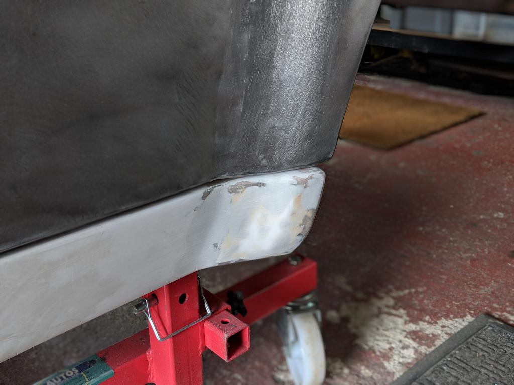

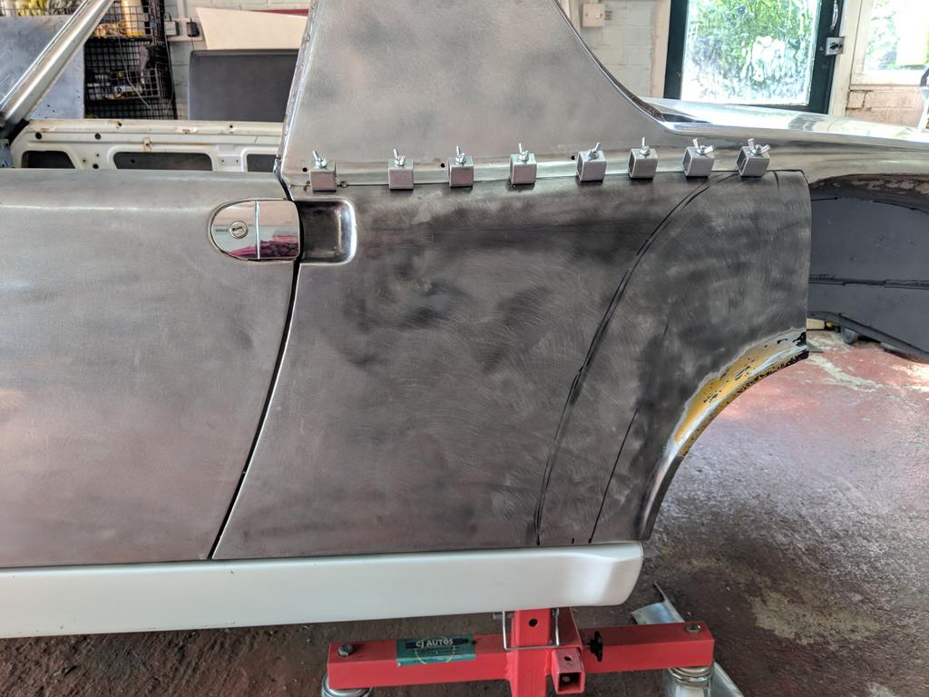

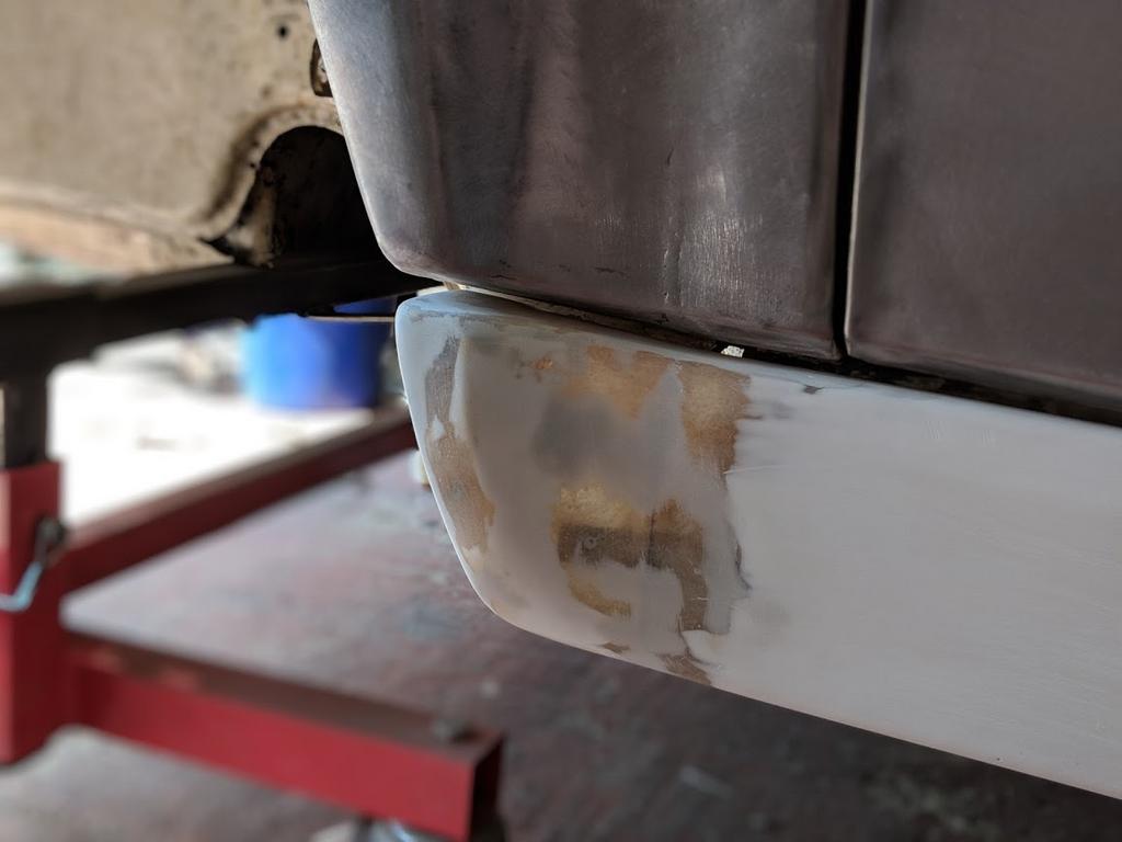

The front didn’t need as much work as the rears. This time though they were both a bit big and the profile wasn’t quite right.
(IMG:http://www.914world.com/bbs2/uploads_offsite/s6.postimg.cc-6621-1526576419.1.jpg)
(IMG:http://www.914world.com/bbs2/uploads_offsite/s6.postimg.cc-6621-1526576420.2.jpg)
Last was to cut the hole for the jack point and test fit the cover.
(IMG:http://www.914world.com/bbs2/uploads_offsite/s6.postimg.cc-6621-1526576420.3.jpg)
Next job is the front and rear valance, they both need an equal amount of work to fit perfectly.
