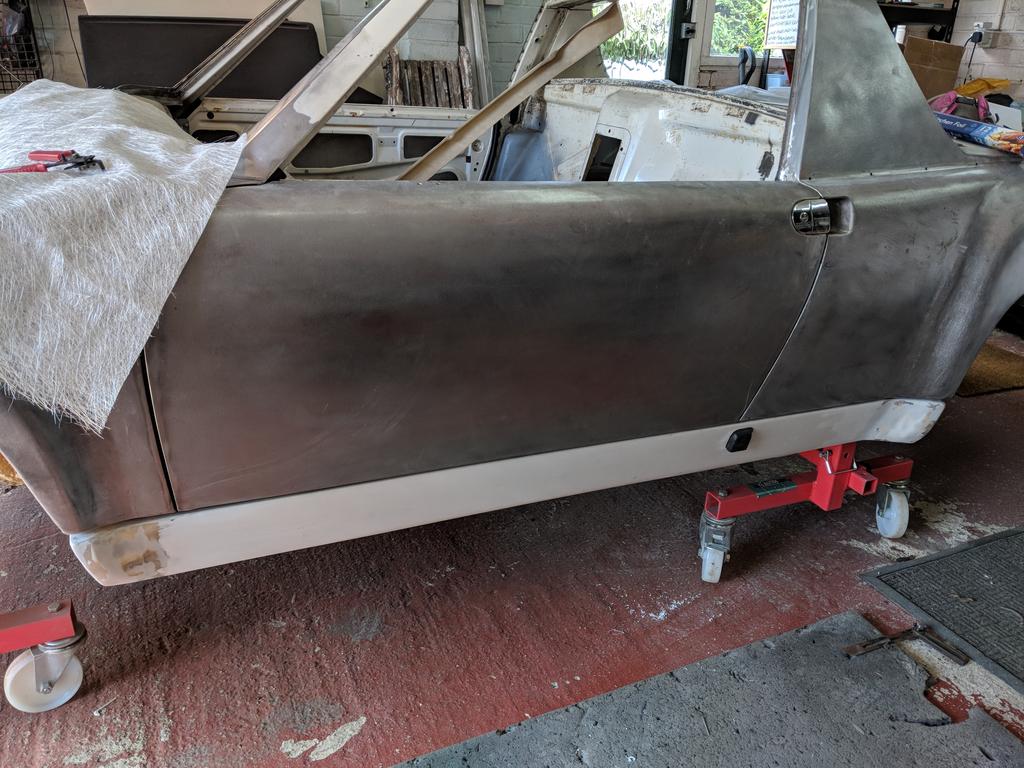

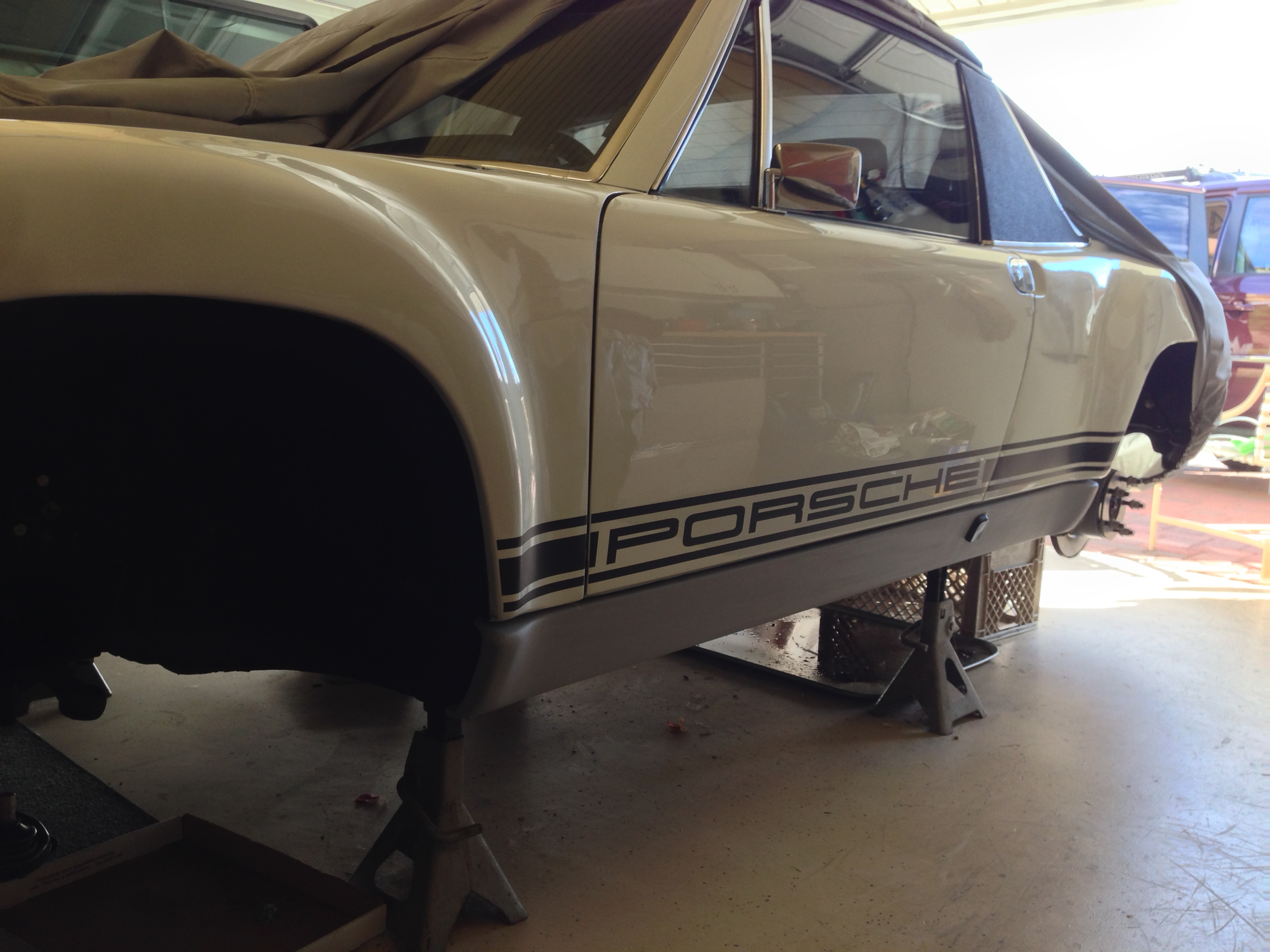

Makes me feel better about the amount of work needed to make the GT rocker panels fit the car. I had to do just as much modifying to mine to get them to fit properly. They are so far off to start with its crazy.

Thanks for posting that pic Pete.

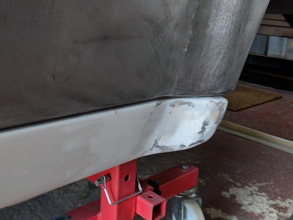

After coming in last night I decided I wasn't happy with the angle of the flare on the rear rocker. So this morning I've decided to revisit it. After seeing Pete's pic I need to shave off the bottom corner and give it a rounder profile. Currently mine is too square. My wife thinks I'm mad to undo my work but I think I've proven before I'm not afraid to redo something if I'm not entirely happy with something. I few hours extra work is nothing compared to that nagging feeling in the back of your mind (IMG:style_emoticons/default/laugh.gif)

So here's the result of this mornings redo on the rear section.
(IMG:http://www.914world.com/bbs2/uploads_offsite/s6.postimg.cc-6621-1526646784.1.jpg)
I'm much happier with that!

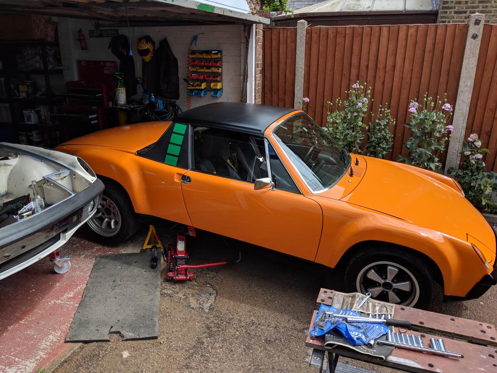

An update with no updates (IMG:style_emoticons/default/laugh.gif)
Since my last post no much has been done to the car. For reasons I decided I wanted to have the car painted by someone else. However the downside to this is he has a waiting list of a few months so the car won't be leaving here until October. The plus side however is the car will be worked on immediately to a schedule that won't drag on.
In the meantime I've had this to play with.
(IMG:http://www.914world.com/bbs2/uploads_offsite/s6.postimg.cc-6621-1529238230.1.jpg)
James dropped the car off to me a few weeks ago with a list as long as your arm of jobs to complete before Le Mans Classic. Being roughly the same spec as my car will be once finished it's been a joy to work on (mostly) (IMG:style_emoticons/default/laugh.gif) and also to drive (IMG:style_emoticons/default/biggrin.gif)

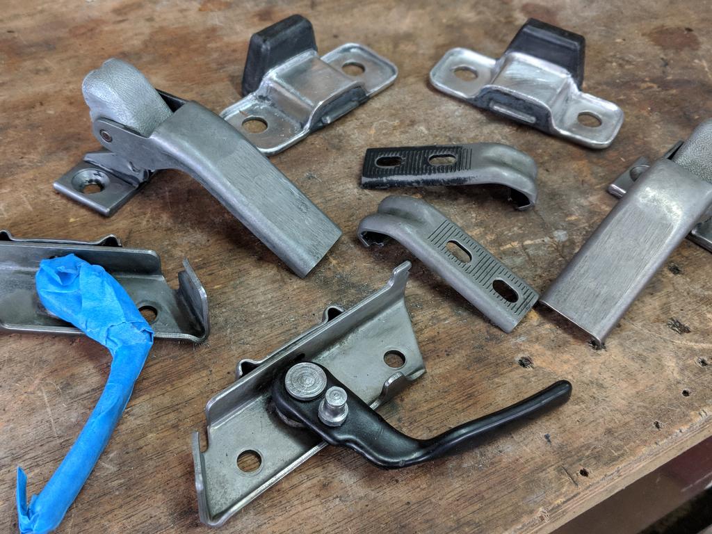

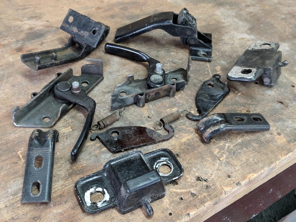

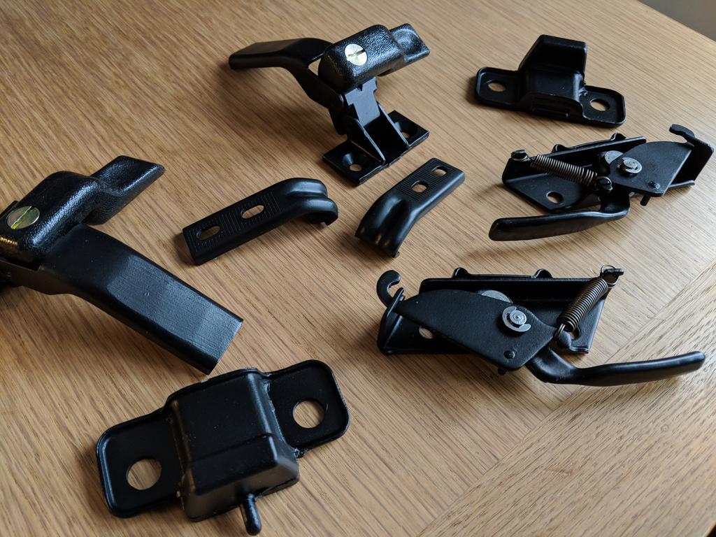

I'm at that point now where there's very little to do until the car is painted. The paint slot I was hoping for won't happen now but I'm close to making other arrangements now. In the meantime below are a few other little bits I've finished off.
Targa latch hardware.
(IMG:http://www.914world.com/bbs2/uploads_offsite/s6.postimg.cc-6621-1532174705.1.jpg)
(IMG:http://www.914world.com/bbs2/uploads_offsite/s6.postimg.cc-6621-1532174707.2.jpg)
(IMG:http://www.914world.com/bbs2/uploads_offsite/s6.postimg.cc-6621-1532174707.3.jpg)

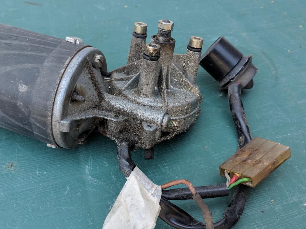

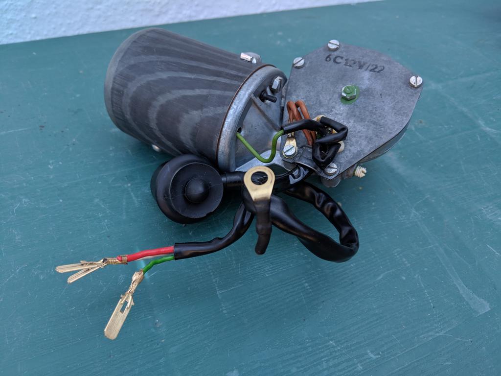

Headlight Motors were fortunately it fairly good condition and the casing both displayed their stripes well. They only really need a deep clean.
(IMG:http://www.914world.com/bbs2/uploads_offsite/s6.postimg.cc-6621-1532174718.1.jpg)
(IMG:http://www.914world.com/bbs2/uploads_offsite/s6.postimg.cc-6621-1532174719.2.jpg)

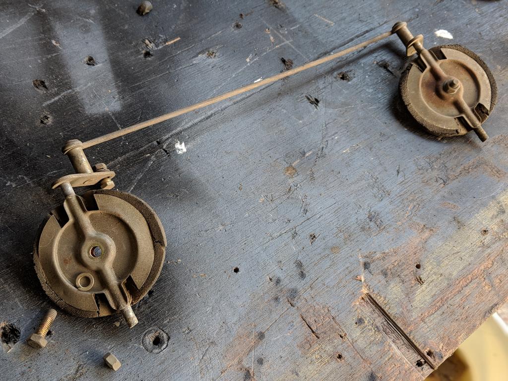

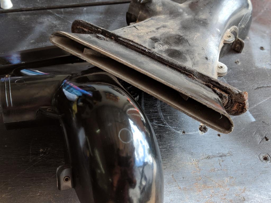

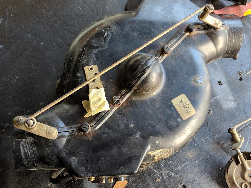

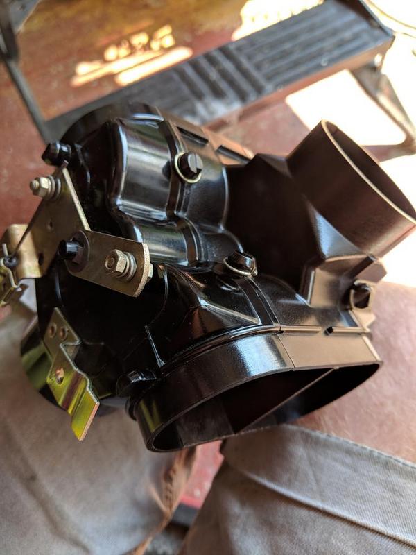

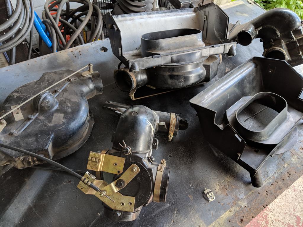

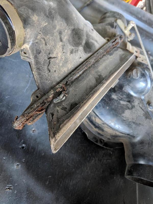

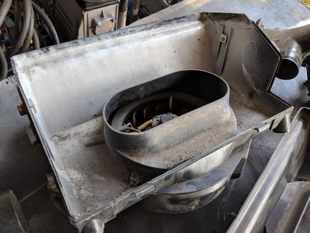

The fresh air system really needed a lot of work to refurb. Like many, mine had been left in situ when the car was resprayed previously so internally it was light ivory! It’s also not uncommon for the drain tubes to snap off and mine had suffered. Mine had also lost a couple of the tabs the retaining clips held on to so some of the pieces needed replacing. If took a while but eventually I had a good enough set to set about making good.
This is what I had to start with…
(IMG:http://www.914world.com/bbs2/uploads_offsite/s6.postimg.cc-6621-1532174732.1.jpg)
Overspray extreme!
(IMG:http://www.914world.com/bbs2/uploads_offsite/s6.postimg.cc-6621-1532174733.2.jpg)
(IMG:http://www.914world.com/bbs2/uploads_offsite/s6.postimg.cc-6621-1532174734.3.jpg)
I don’t think the seals are going to be reusable (IMG:style_emoticons/default/laugh.gif)
(IMG:http://www.914world.com/bbs2/uploads_offsite/s6.postimg.cc-6621-1532174734.4.jpg)
defianty
post Jul 21 2018, 06:05 AM
Post #255
Posts: 659
Joined: 9-August 06
From: Essex, UK
Member No.: 6,621
Starting to clean…
(IMG:http://www.914world.com/bbs2/uploads_offsite/s6.postimg.cc-6621-1532174746.1.jpg)
(IMG:http://www.914world.com/bbs2/uploads_offsite/s6.postimg.cc-6621-1532174748.2.jpg)
(IMG:http://www.914world.com/bbs2/uploads_offsite/s6.postimg.cc-6621-1532174748.3.jpg)

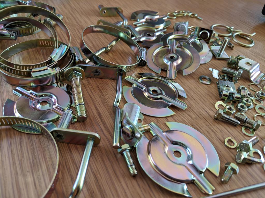

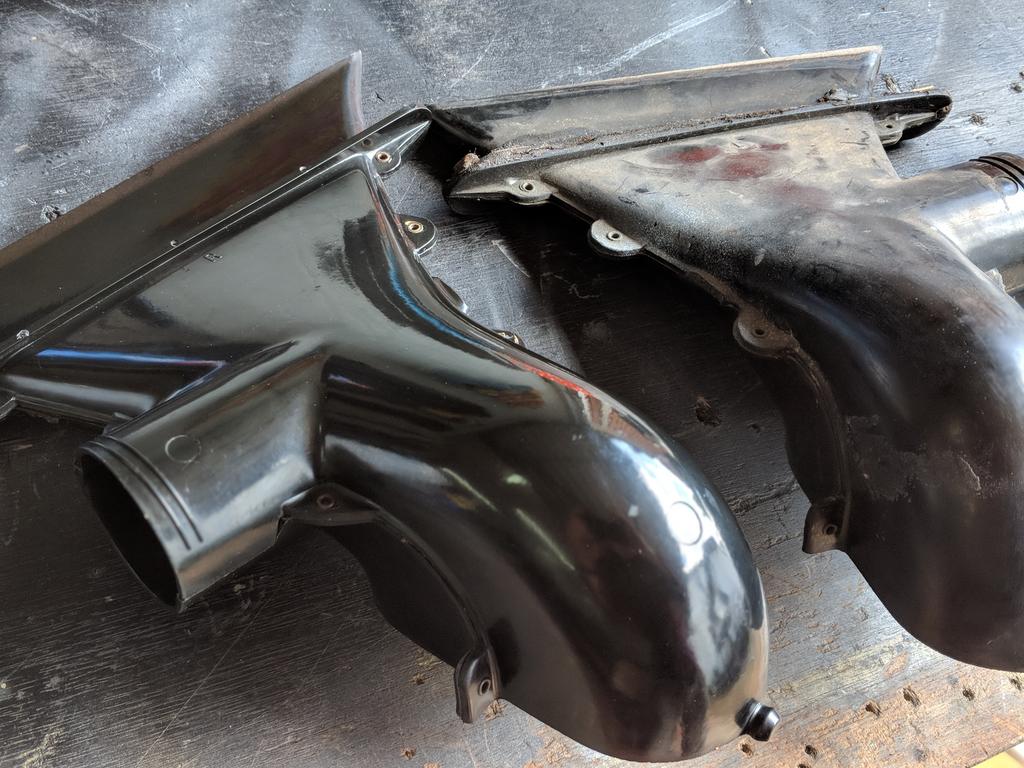

This lot could be better so it was off to the platers.
(IMG:http://www.914world.com/bbs2/uploads_offsite/s6.postimg.cc-6621-1532174759.1.jpg)
(IMG:http://www.914world.com/bbs2/uploads_offsite/s6.postimg.cc-6621-1532174760.2.jpg)
(IMG:http://www.914world.com/bbs2/uploads_offsite/s6.postimg.cc-6621-1532174760.3.jpg)

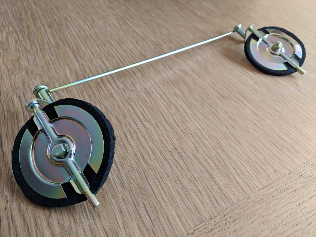

New seal pack from 914Rubber
(IMG:http://www.914world.com/bbs2/uploads_offsite/s6.postimg.cc-6621-1532174761.4.jpg)

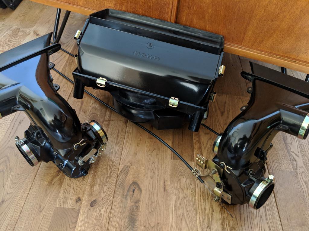

All back together and ready to install. Quite a difference from the beginning. Another stupid amount of time spent cleaning parts no one will ever see (IMG:style_emoticons/default/laugh.gif)
(IMG:http://www.914world.com/bbs2/uploads_offsite/s6.postimg.cc-6621-1532174769.1.jpg)

Stephen,
While your cleaning these up, why not list how your doing it.
Take a great thread that I love to watch and make it one that elevates the others knowledge. Mainly me as I have to do these soon also, and want to save some time.
Cheers,
Stephen
defianty
post Jul 21 2018, 10:19 AM
Post #259
Posts: 659
Joined: 9-August 06
From: Essex, UK
Member No.: 6,621
QUOTE(914forme @ Jul 21 2018, 04:50 PM) *
Stephen,
Cheers,
Stephen
I think I've ben lazy with this write sorry. Everything here was cleaned using the basic things I think we all have in our garages. A degreaser, methylated spirits, white spirit and paint thinners.
The black plastic parts were polished with Autosol metal polish. However the actual top of the airbox I had to paint as it was very scratched.
The only other cleaning I did was to the electrical connectors on the headlight motors. They were soaked in a solution of distilled vinegar and bicarbonate of soda. You can either make a paste or I prefer to add more vinegar and dip the terminals in. In only a few minutes they look like new. Hope this helps.
Lucky9146
