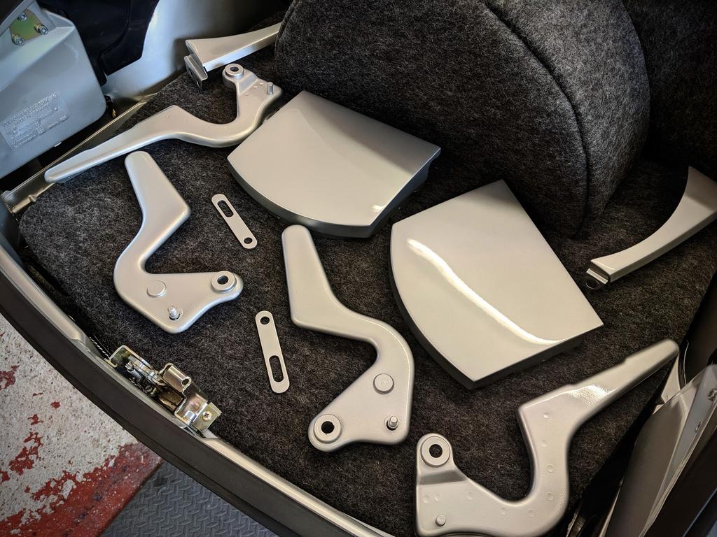

Haven't got much done this week other than trying to wire my alternator (IMG:style_emoticons/default/laugh.gif)

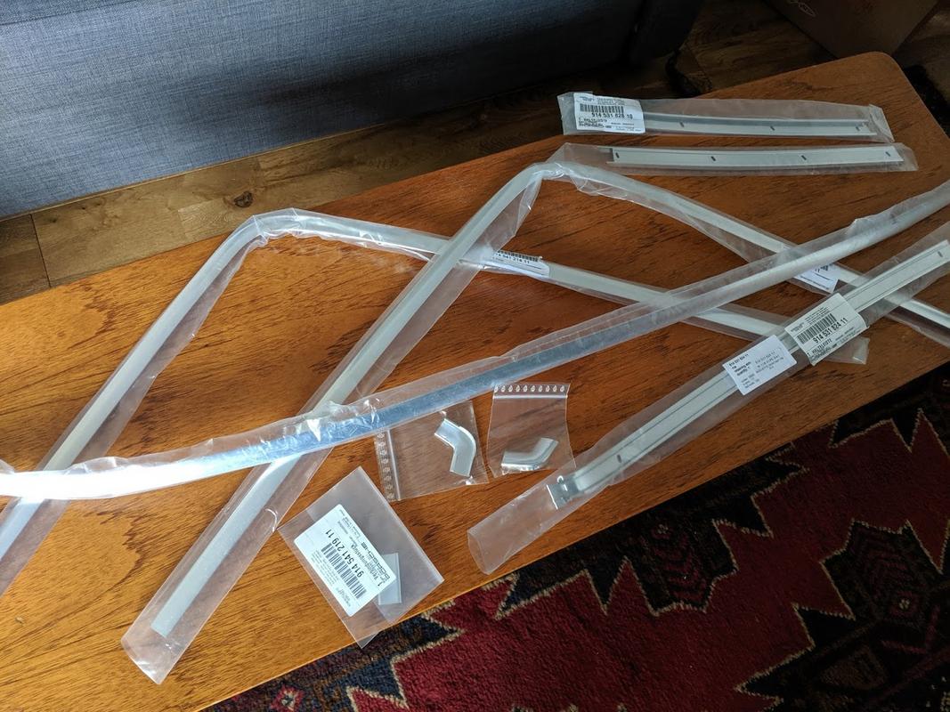

But I did take delivery of this load of shiny bits. I would have loved to use my original trim but they just weren't in quite good enough condition. So I bent over and paid for a new set. (IMG:style_emoticons/default/wacko.gif) It'll be a while before I stop walking like John Wayne that's for sure!! Even the heavily discounted price I told the wife they were she still thought I was mad (IMG:style_emoticons/default/laugh.gif)
Unfortunately the large piece that goes along the bottom of the windscreen didn't travel well and was bent on arrival so that will have to go back.

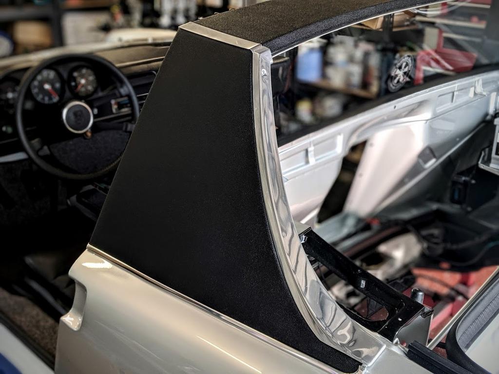

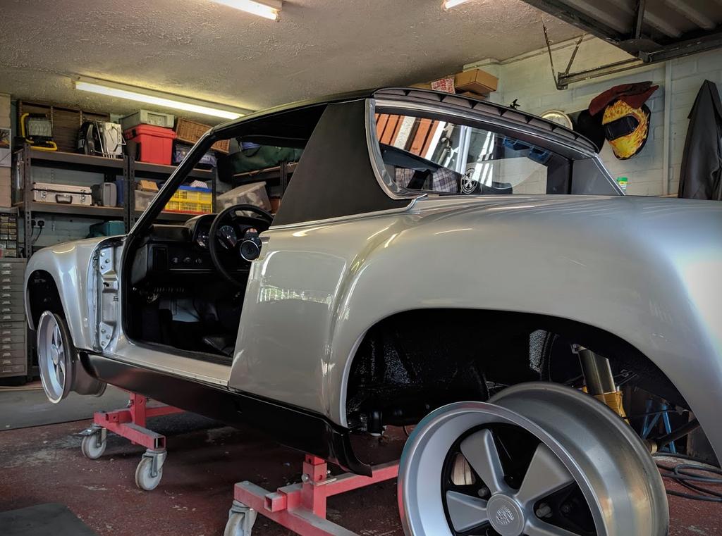

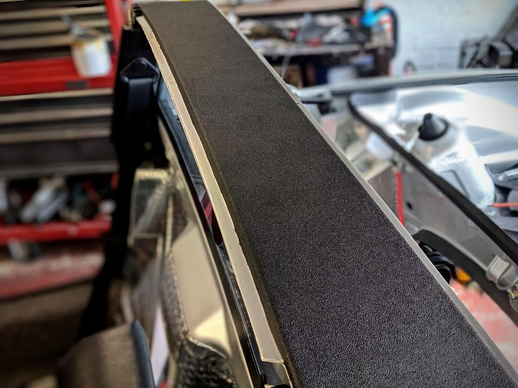

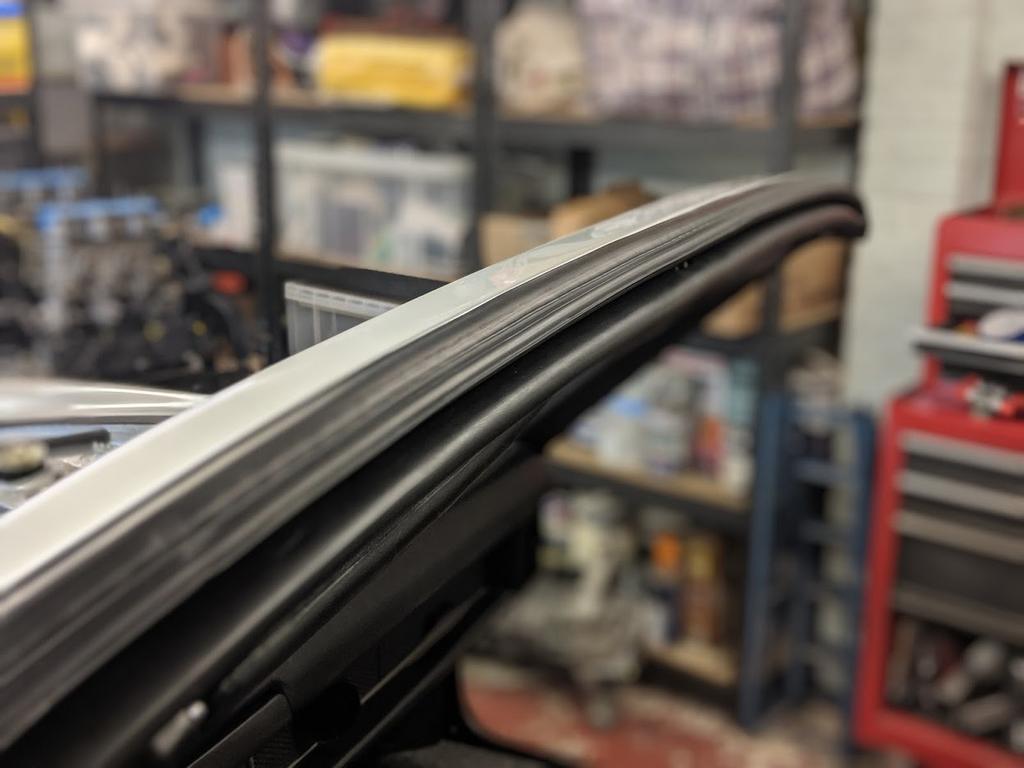

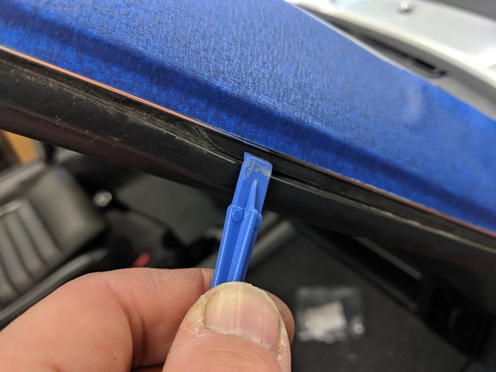

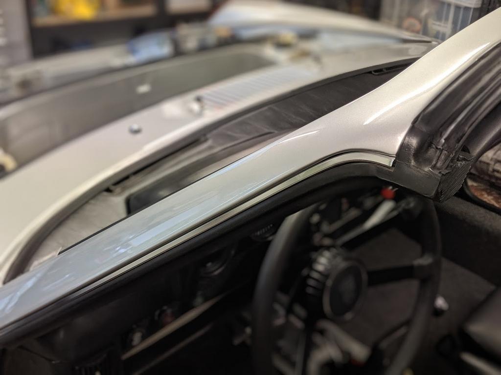

With that delivery I did manage to get the front targa seal installed which was much easier that I thought it would be but I did use a different technique to how I was told to install in.
I fitted the top part of the seal and the corners and then pushed the downward part of the seal into the rear section of the gutter. Then with a plastic mobile phone case opening tool to pushed the front of the seal into place. The whole thing was done in 20 minutes and far far easier than trying to slide the side part all the way down the gutter!
(IMG:http://www.914world.com/bbs2/uploads_offsite/i.postimg.cc-6621-1558173241.2.jpg)
(IMG:http://www.914world.com/bbs2/uploads_offsite/i.postimg.cc-6621-1558173241.3.jpg)
(IMG:http://www.914world.com/bbs2/uploads_offsite/i.postimg.cc-6621-1558173242.4.jpg)

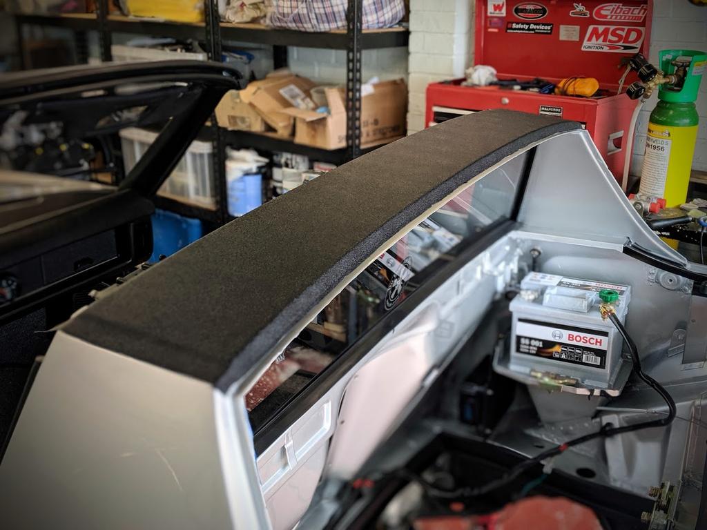

With the rest of the trim pieces I'll get to fitting the vinyl sail panels over the weekend as the painter has agreed the paint is dry enough now.

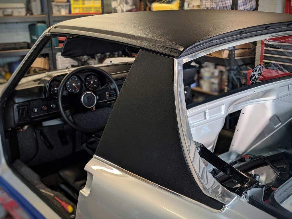

Got the vinyl fitted today and trim, really transforms the look of the car.
(IMG:http://www.914world.com/bbs2/uploads_offsite/i.postimg.cc-6621-1558282669.1.jpg)
(IMG:http://www.914world.com/bbs2/uploads_offsite/i.postimg.cc-6621-1558282670.2.jpg)
(IMG:http://www.914world.com/bbs2/uploads_offsite/i.postimg.cc-6621-1558282671.3.jpg)
(IMG:http://www.914world.com/bbs2/uploads_offsite/i.postimg.cc-6621-1558282671.4.jpg)

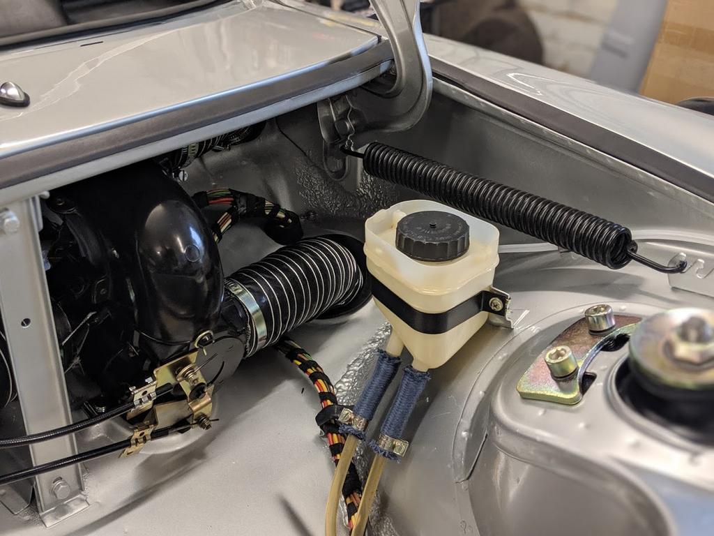

QUOTE(defianty @ May 10 2019, 09:12 AM) *

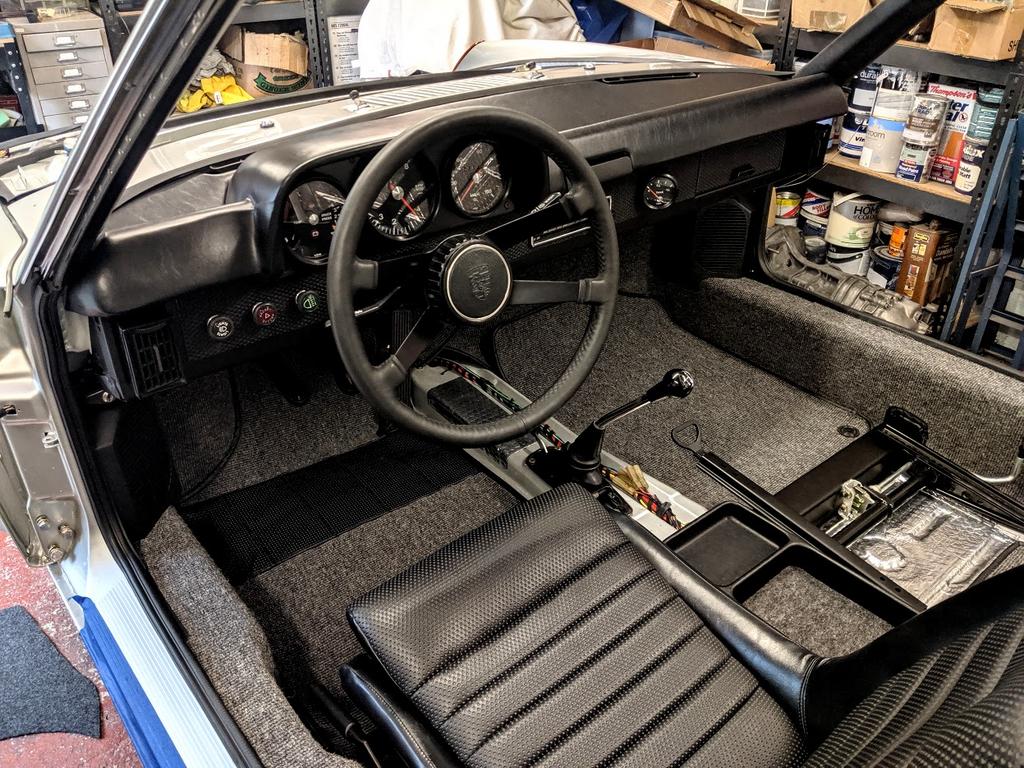

I made a start on the interior this week as I finally had all the wiring complete. First with the vinyl installation and then the carpet. With a bit of luck doing it now will give the glue time enough to gas off so I'm not smashed when I come to drive it :drunken: . Still got fuel lines to run hence the centre carpet missing and I'll keep the lower dash pad off for now to make getting under the dash easier should I need to.
(IMG:http://www.914world.com/bbs2/uploads_offsite/i.postimg.cc-6621-1557504751.1.jpg)
(IMG:http://www.914world.com/bbs2/uploads_offsite/i.postimg.cc-6621-1557504752.2.jpg)
Yes I did sit in it and yes I did go broom broom! (IMG:style_emoticons/default/laugh.gif)

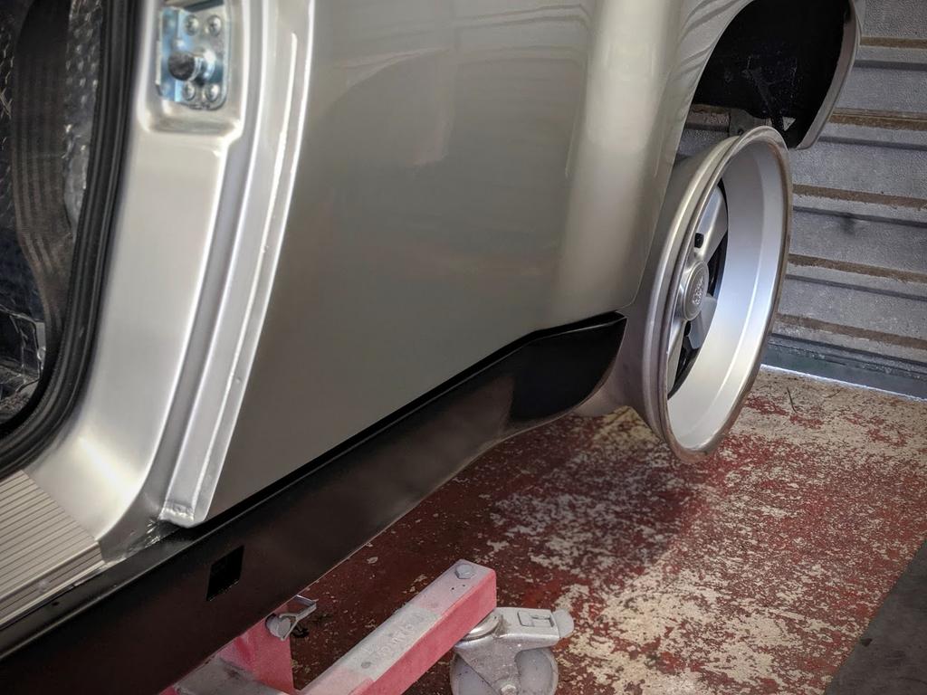

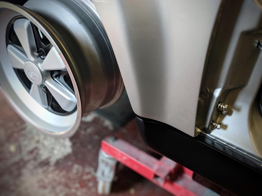

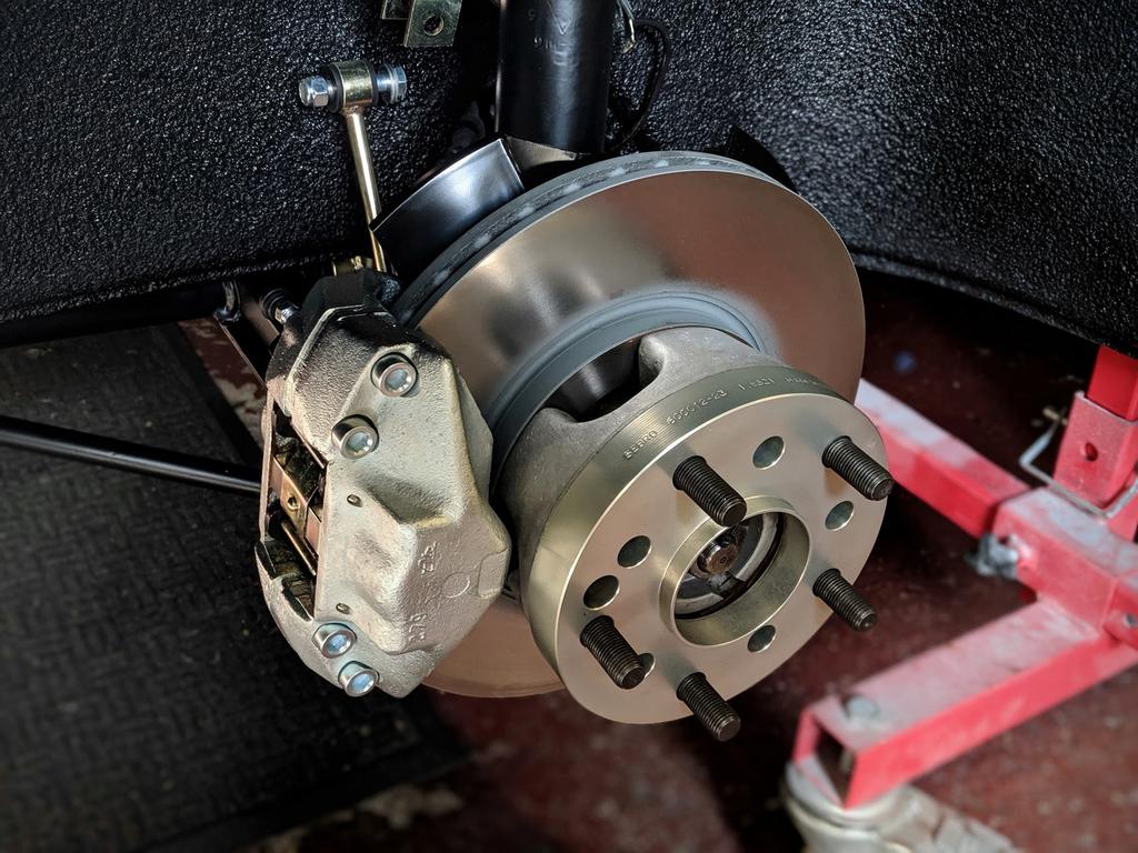

It became apparent that the 7 inch wheels on the front would need spacers but to accommodate those I'd also need longer studs. So I needed to dismantle the front hubs again and press in the new studs. Not the easiest of tasks but I got there in the end.
(IMG:http://www.914world.com/bbs2/uploads_offsite/i.postimg.cc-6621-1558630908.1.jpg)
The wheels fill the arches much better now.

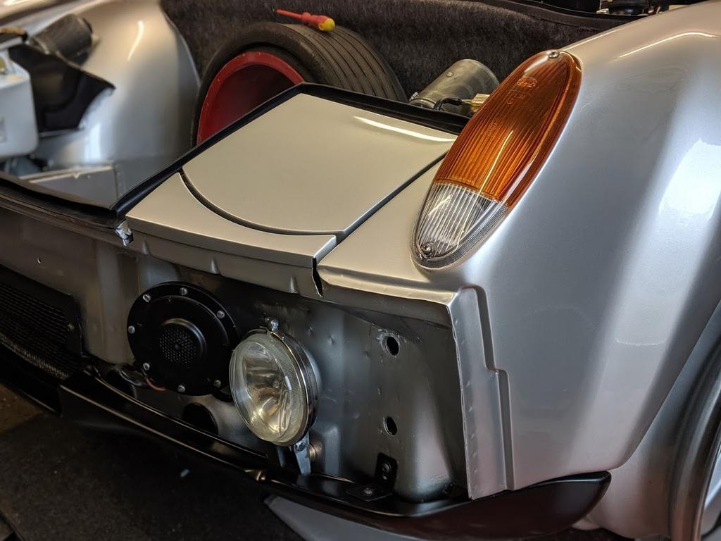

I also picked up all of the GT fibreglass panels.
(IMG:http://www.914world.com/bbs2/uploads_offsite/i.postimg.cc-6621-1558630910.3.jpg)
Really pleased I put in the time getting these to fit perfectly.
(IMG:http://www.914world.com/bbs2/uploads_offsite/i.postimg.cc-6621-1558630910.4.jpg)
(IMG:http://www.914world.com/bbs2/uploads_offsite/i.postimg.cc-6621-1558630911.5.jpg)

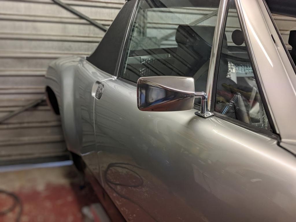

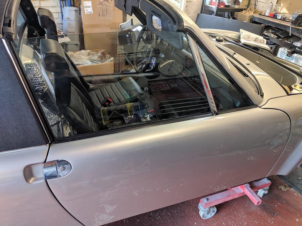

The car is really taking shape now. Last week I collected the doors from storage and got them fitted.
(IMG:http://www.914world.com/bbs2/uploads_offsite/i.postimg.cc-6621-1559376291.1.jpg)
Had a terrible time fitting the widow regulator and getting everything lined up correctly. I'm still not 100% happy with it but after four days of messing around I'm finished with it for a while.
What I didn't notice when I was fitting the passenger door is the painter had unfortunately filled in the wing mirror holes. As if this door hadn't already caused me enough problems I then had to deal with trying to drill though from the inside to be able to fit the mirror again, all with the window regulator in place. :shock:
(IMG:http://www.914world.com/bbs2/uploads_offsite/i.postimg.cc-6621-1559376292.2.jpg)
