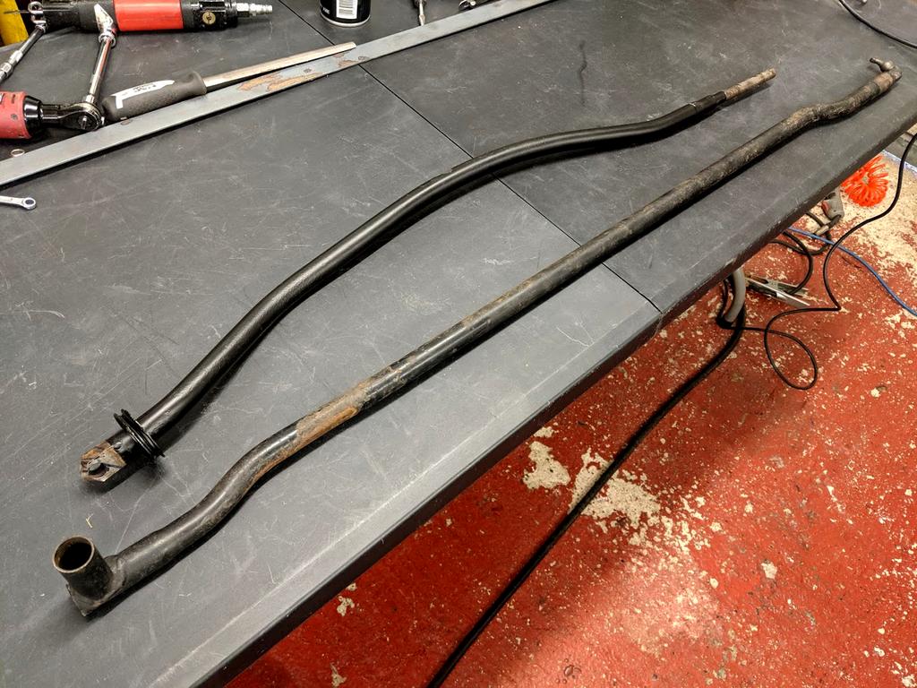

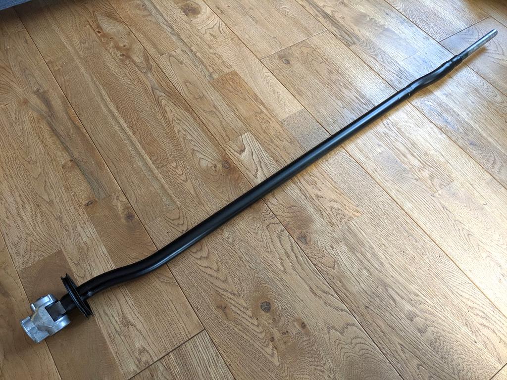

To start with I had a lot of trouble setting up the throttle linkage. At this point I've got around it with a makeshift solution, that to be honest works perfectly, but it's far from the factory setup so that's something I'll revisit at a later stage.
With the engine in the last piece I needed to fabricate was a new rear shift rod. I got lucky a few month ago and swapped a part for tailshift straight rod. Along with my original 4-cylinder bent rod I set about cutting them up and making a compatible straight rod that wouldn't fail the block and heat exchangers.
Original 4-cylinder bent sideshift rod top, early tailshift rear rod bottom.
(IMG:http://www.914world.com/bbs2/uploads_offsite/i.postimg.cc-6621-1572181753.1.jpg)
I won't document the process as it's been done many times before and partly because I forgot to take any photos (IMG:style_emoticons/default/laugh.gif)
Here's the finished article.
(IMG:http://www.914world.com/bbs2/uploads_offsite/i.postimg.cc-6621-1572181754.2.jpg)

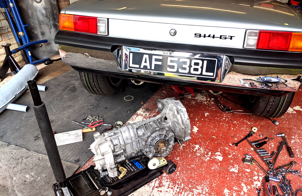

With the rod completed it should have just been a case adjusting the shifter and go out for a test drive. Sadly it didn't end up that way and after hours of trying to find all the gears I came to the conclusion that I need to adjust the clutch more. However that wasn't going to happen as there was no adjustment left.
So it's time to add a washer under the pivot ball of the clutch arm. Hopefully a simple fix, but it obviously means removing the gearbox.
This is where I am now as of this morning. I managed to rip both cv gaskets so I need to pick up a couple before I get it all back together which should hopefully be later next week.
That's not a tiny gearbox, it's just a stupidly larger jack! (IMG:style_emoticons/default/laugh.gif)
(IMG:http://www.914world.com/bbs2/uploads_offsite/i.postimg.cc-6621-1572181754.3.png)

Stephen,
You are not alone. I had to remove my gearbox after the install too! My removal was because the ring gear had to be flipped. (IMG:style_emoticons/default/headbang.gif)
I was fortunate enough to have been told about the washer under the pivot ball early on.
It is all worth it in the end. Buy extra sets of CV gaskets they are cheap. (IMG:style_emoticons/default/smile.gif)
You are almost there! (IMG:style_emoticons/default/beerchug.gif)

Member No.: 6,621
Thanks chaps.
I can't believe that after a few hours of searching I can't find any CV gaskets in the UK. I even called Porsche (IMG:style_emoticons/default/headbang.gif)
Closest I found was France but I didn't fancy spending $20 for shipping for a few gaskets. In the end I popped into my local motor spares shop and bought some gasket paper and carefully cut out my own.
Hoping to get the gearbox back in tomorrow with the help of a friend.
