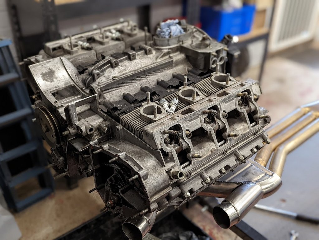

The journey is never over and it's time for a well overdue update. Although not an update I wanted to do.
Since hitting the road with the finished car it hasn't all been good. In fact, I've had very little enjoyment out of it since completion and sadly I've only covered just over 1000 miles. Most of those were spent wondering if the engine was going to get me home due the rattling sounds it was making and the ever decreasing oil pressure. (IMG:style_emoticons/default/headbang.gif)
During the summer last year after heading back from a local car and coffee meet things took a turn for the worse and the car was seriously down on power. Having exhausted every option available to me I pulled the engine out of the car, stuck two fingers up at it, closed the garage door and walked away.
It was months until I got back stuck back in after I'd gained some enthusiasm and rapidly running out of time to get the car to Le Man for the Classic.
After many hours of research I encouraged to do a DIY rebuild of the engine. It still scares the hell out of me saying that but the more I get stuck in the more my confidence builds.
I'm just on the strip down and investigative stage at the moment, but I'm enjoying the process and learning lots along the way.

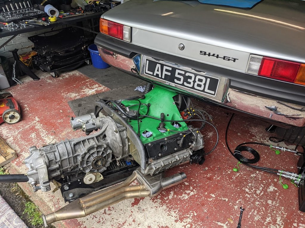

That day about eight months ago when I decided enough was enough!
(IMG:http://www.914world.com/bbs2/uploads_offsite/i.postimg.cc-6621-1647537093.1.jpg)
Ancillaries off and getting down to it.
(IMG:http://www.914world.com/bbs2/uploads_offsite/i.postimg.cc-6621-1647537094.2.jpg)
(IMG:http://www.914world.com/bbs2/uploads_offsite/i.postimg.cc-6621-1647537094.3.jpg)

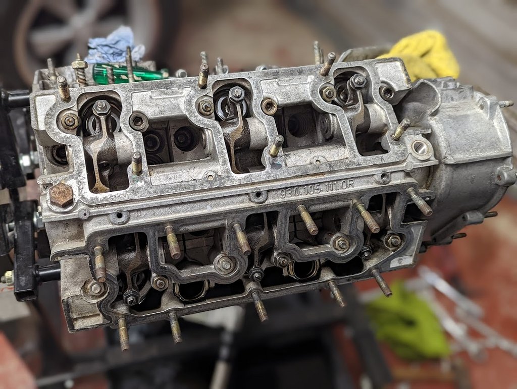

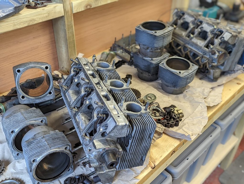

The first unexpected surprise! - 3.2L heads
(IMG:http://www.914world.com/bbs2/uploads_offsite/i.postimg.cc-6621-1647537095.4.jpg)
(IMG:http://www.914world.com/bbs2/uploads_offsite/i.postimg.cc-6621-1647537095.5.jpg)
New workbench with little space left already!
(IMG:http://www.914world.com/bbs2/uploads_offsite/i.postimg.cc-6621-1647537096.6.jpg)

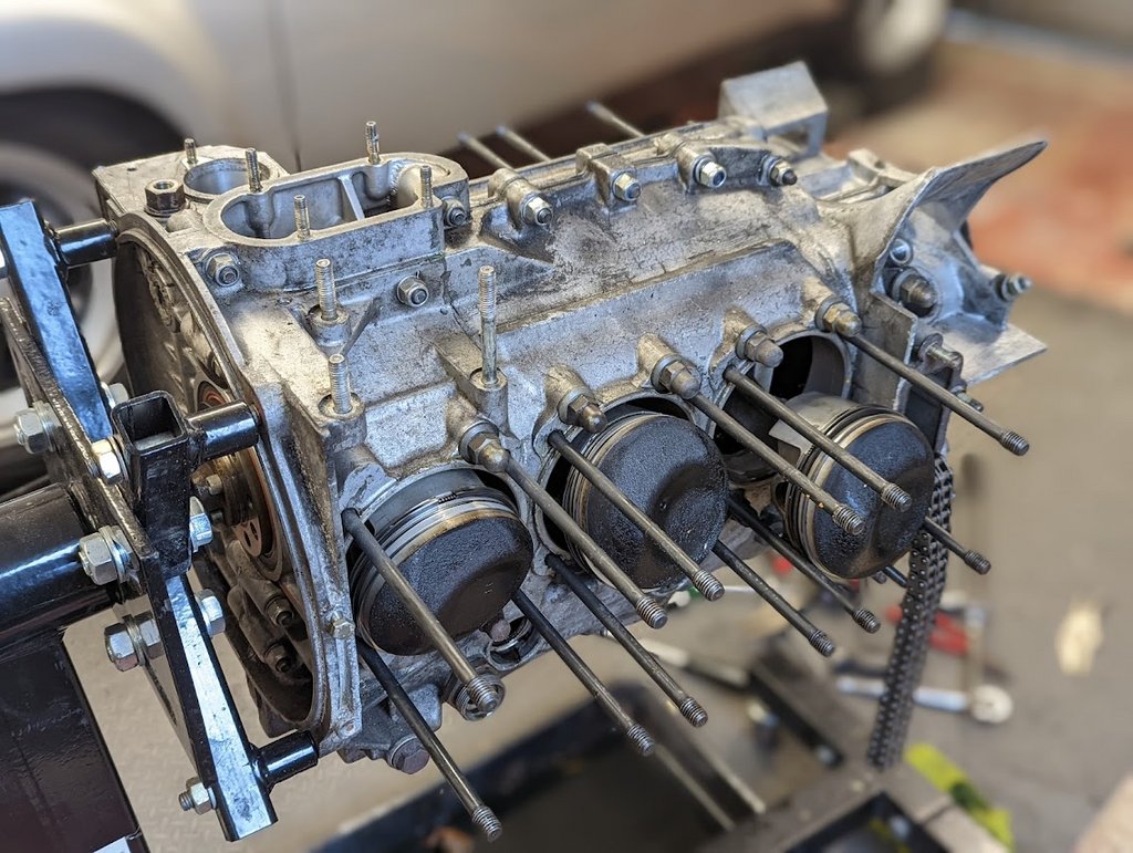

Next step is to split the case - this shot was taken before I got a new engine yoke.
(IMG:http://www.914world.com/bbs2/uploads_offsite/i.postimg.cc-6621-1647537096.7.jpg)
More updates soon as we get inside this thing!

Son of a B$!@#%, really sucks to have to pull an engine.
Not seeing any smoking guns yet which means it could be rod or main bearing?

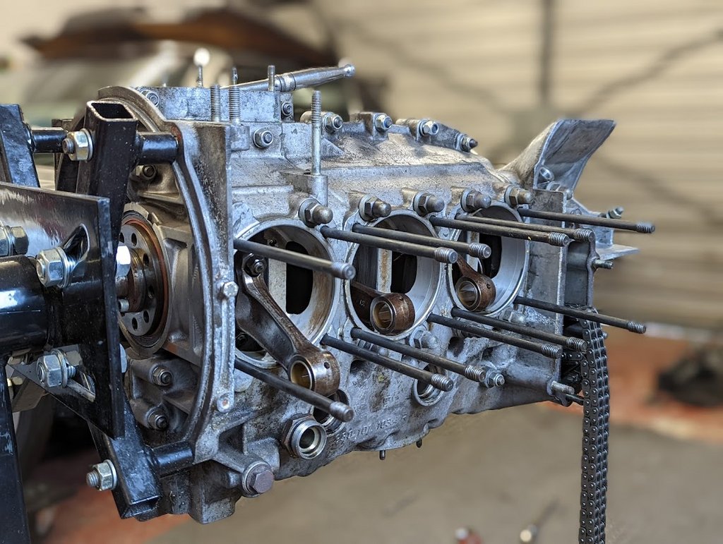

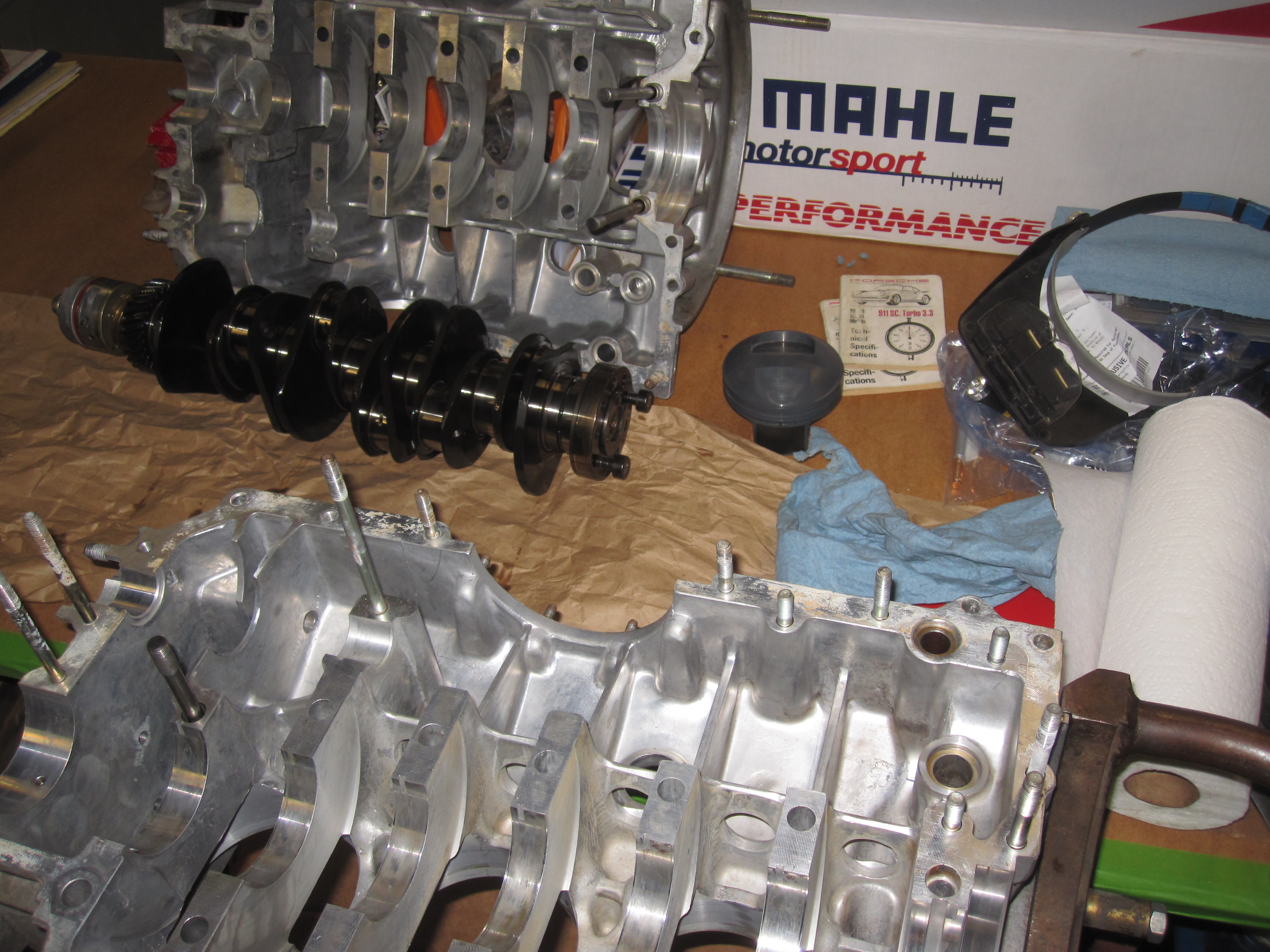

With help we split the case last night and essentially found an engine in very good condition. I'll post photos later. No evidence of any wear to the crank or any bearings just a few very light marks. We'd already inspected the pistons and cylinders to see no issues.
The worst wear was founds on all the timing gears on the intermediate shaft which is what I expected as it was a timing chain like noise that was driving me mad, they will all be replaced with new Porsche parts.
All in all, I think I got away lightly and the shopping list, although lengthy, could have been a lot worse and more expensive.
Next step is to clean everything and get some parts to the machine shop for polishing etc.
We're certain the loss of power is not attributed to the condition of the engine, which is great news. We do have other thoughts and will address those as we put everything back together again.
