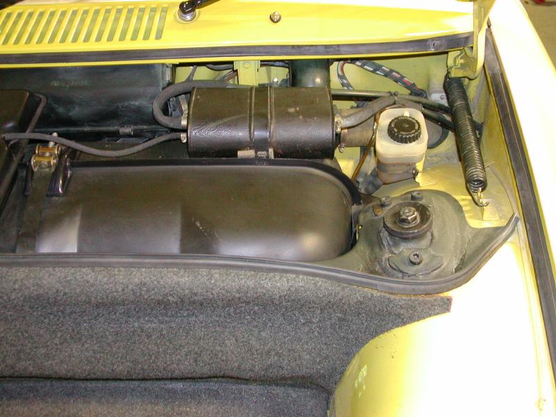

So one of the parts I got with my 2.7L engine is the charcoal canister and I was wondering just where and how it should be installed? This was in a 914 before, anyone have a picture?

It goes on top of the fuel tank, driver's side. If your 2.7 has carbs, there's no point, so just leave it off. If it has CIS, there will be a large-ish fitting on the airbox for it.

Yes, it has a CIS system..so mount it on top of the fuel tank then a rubber hose runs back to the airbox and I guess the other side of the canister connects to the fuel tank some how? I don't have an expansion tank on top of the fuel-tank, does that matter?

My -6 had it installed on the tank top. Picture below. Gint's six had the line holes welded up at the factory and no filter... very interesting.

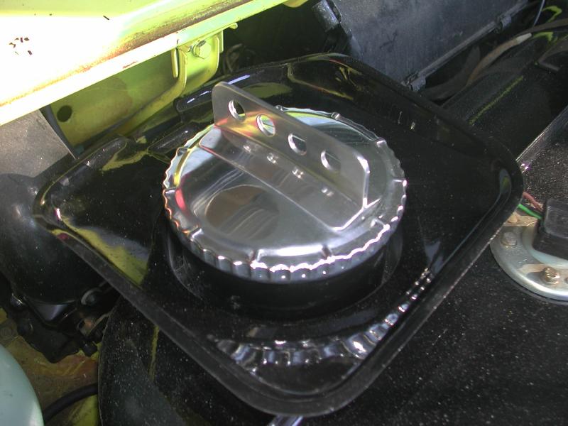

Beats me... I don't see the need. Mine's not getting one. I put the GT cap and 100mm filler neck on and left the expansion tank off.
