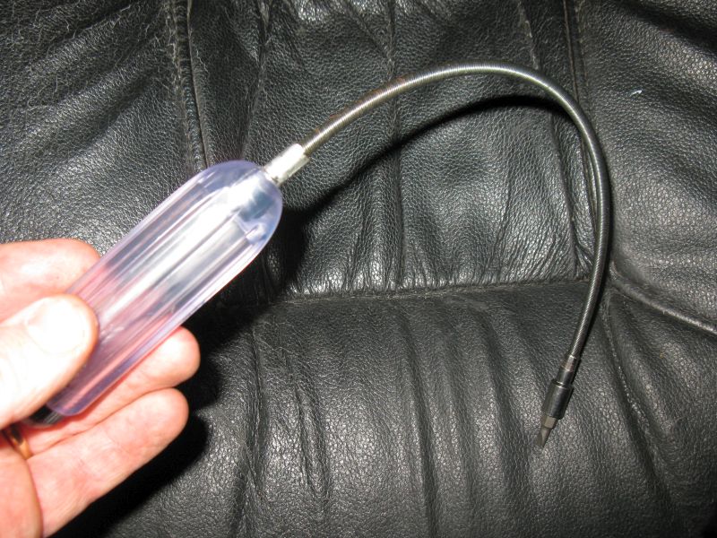

mskala
post Jun 3 2017, 07:56 PM
R
Posts: 1,935
Joined: 2-January 03
From: Massachusetts
Member No.: 79
Also without one of these flexi-drivers you're toast getting at the top screw.
