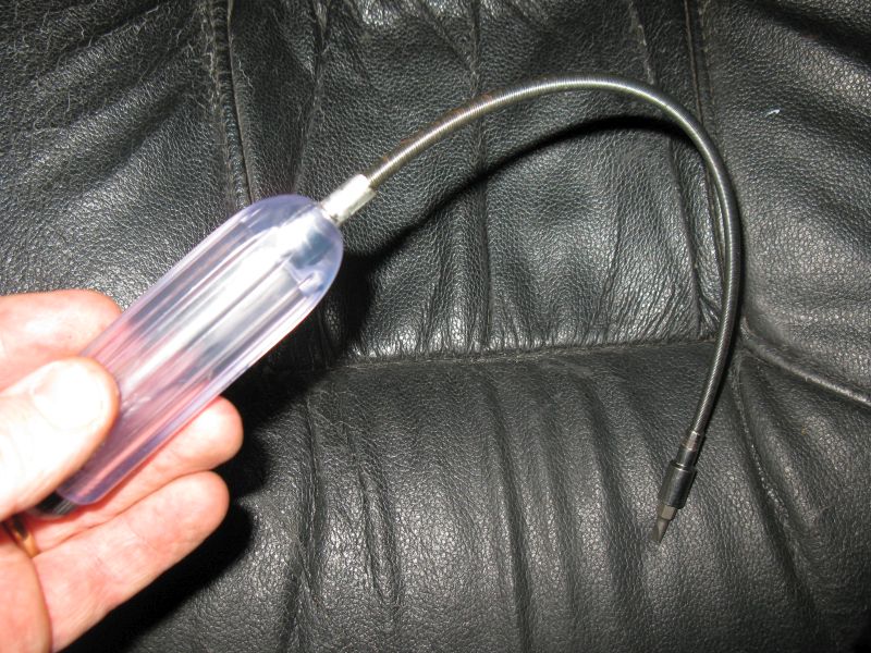

mskala
Also without one of these flexi-drivers you're toast getting at the top screw.
