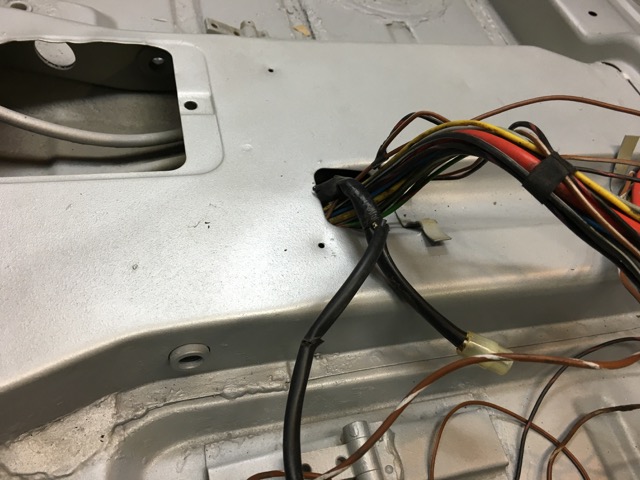

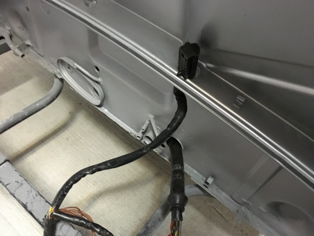

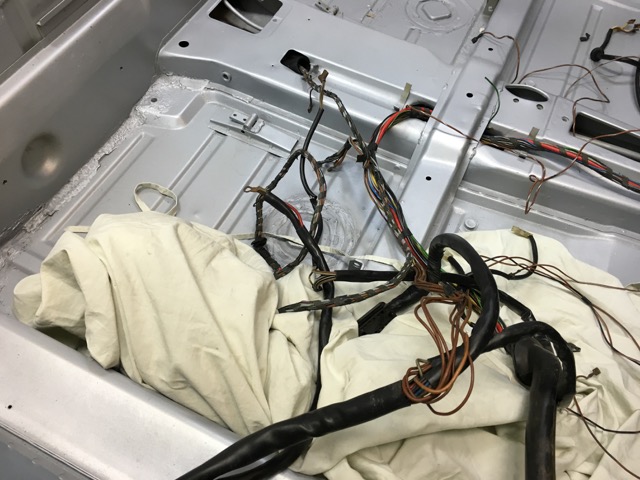

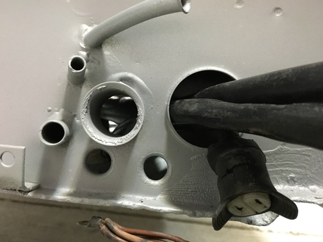

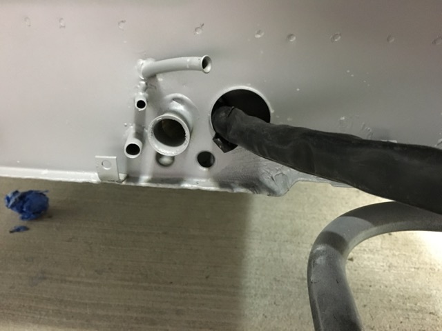

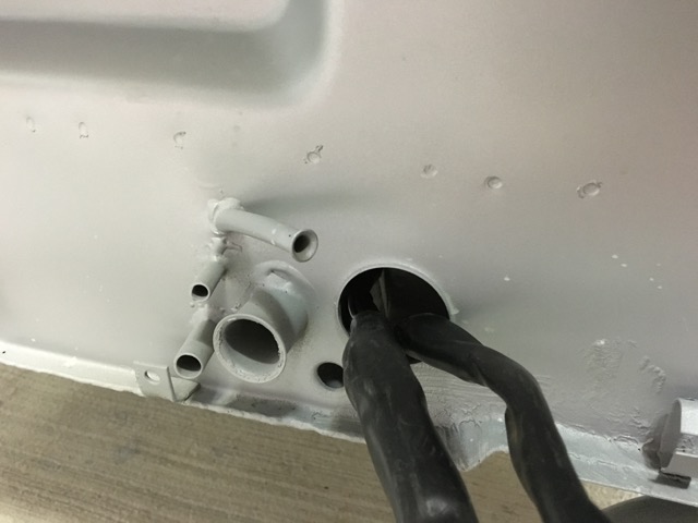

This is from my 72 restoration project.

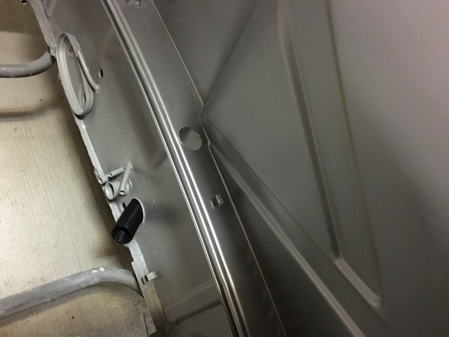

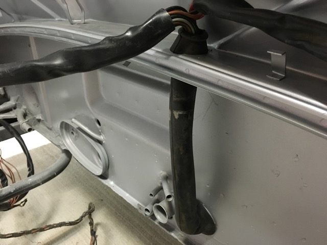

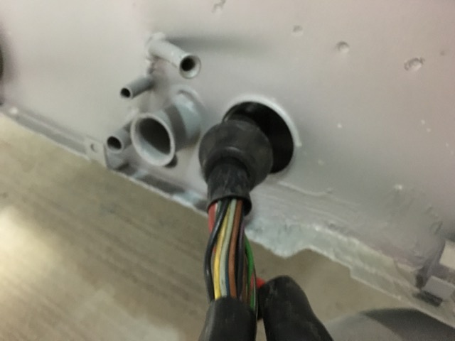

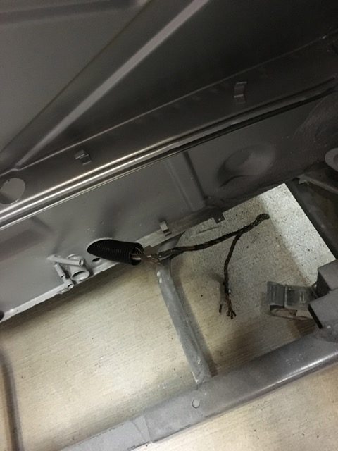

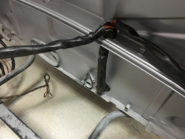

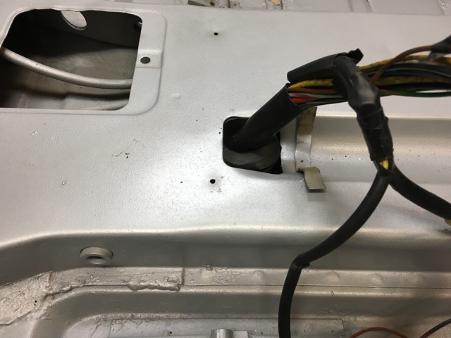

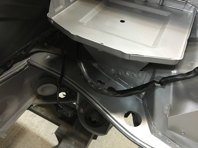

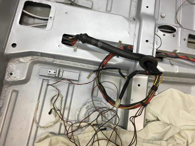

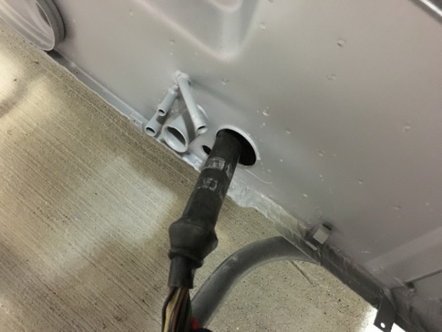

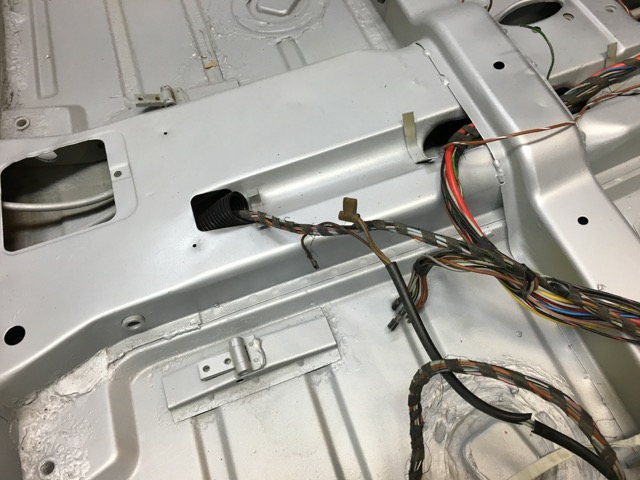

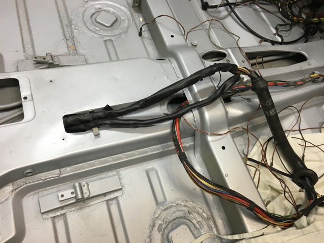

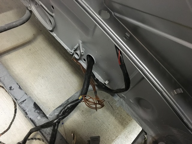

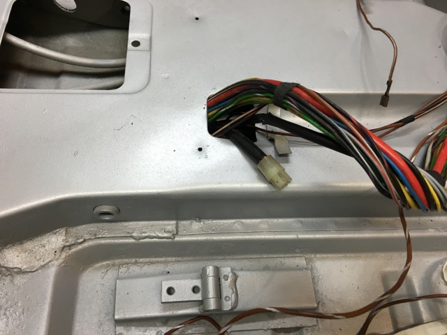

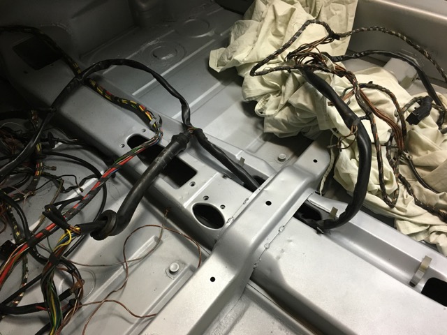

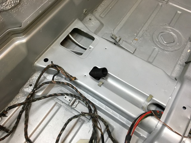

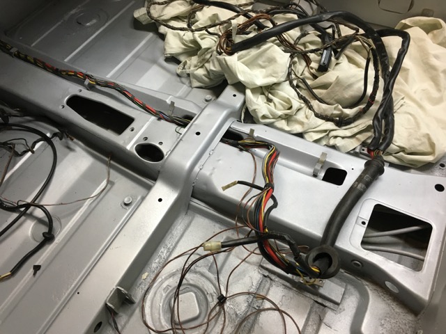

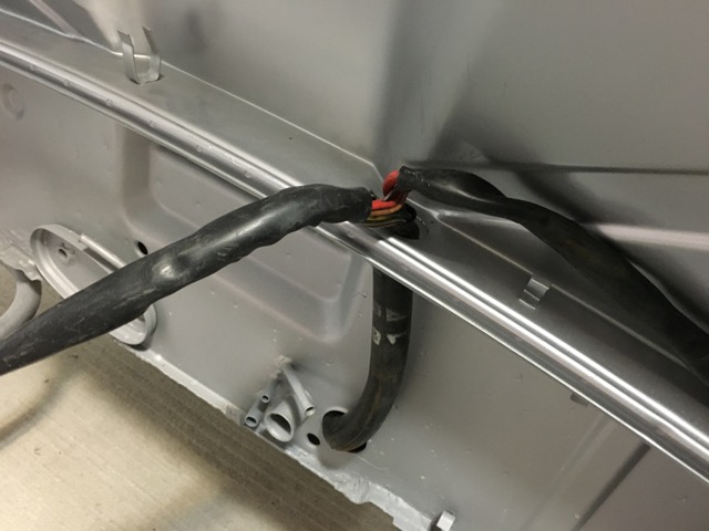

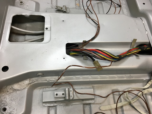

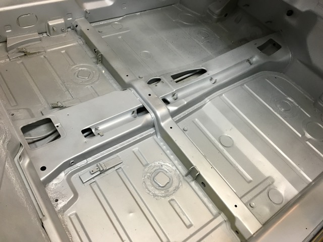

Here is the way I installed my wire harness. Step by step.
Remove plastic guide tube
Must move this conector through the hole, the harness is to stiff to do this step later
these photos show a black tube inserted from the tunnel to back thru the firewall.
Is this a part of the harness, or a separate rubber or plastic tube just used to help feed wires thru ?? If so what size ?
Garland
post Jun 7 2017, 07:22 PM
Restoration Fanatic
Posts: 1,424
Joined: 8-January 04
From: ......Michigan......
Member No.: 1,535
Just a black plastic large cord holder, with the slip down the side . Its only to protect and guide the harness.

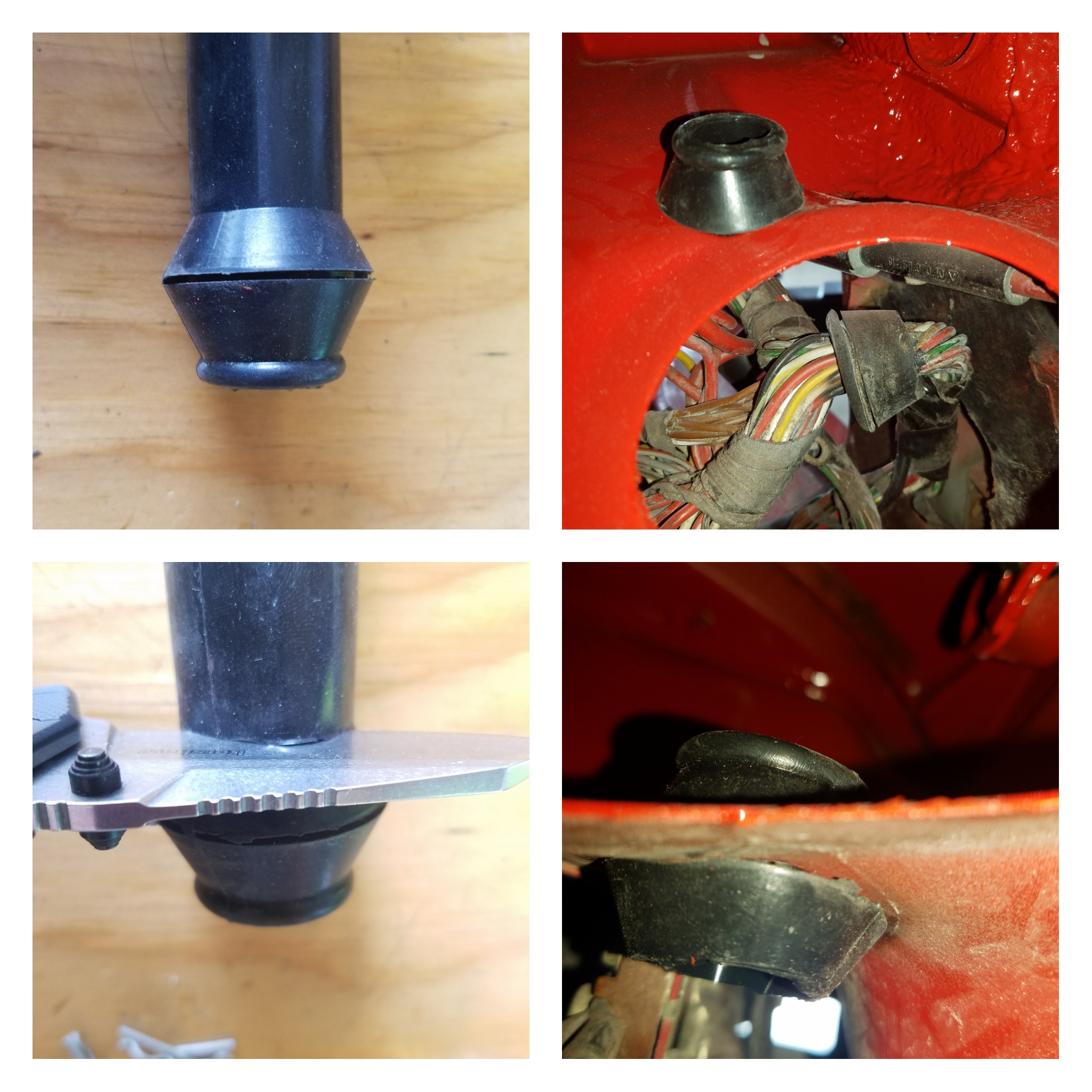

Figured out today that you can cut off the end of the 914Rubber Snorkel tube to use as the wiring harness grommet in to the front trunk. Early uses on end, late uses the other end (IMG:style_emoticons/default/w00t.gif)
