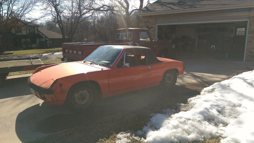

15 months ago I bought a crusty old 1971 914-4 that had been sitting in a garage for 20 years getting peed and chewed on by all sorts of creatures.

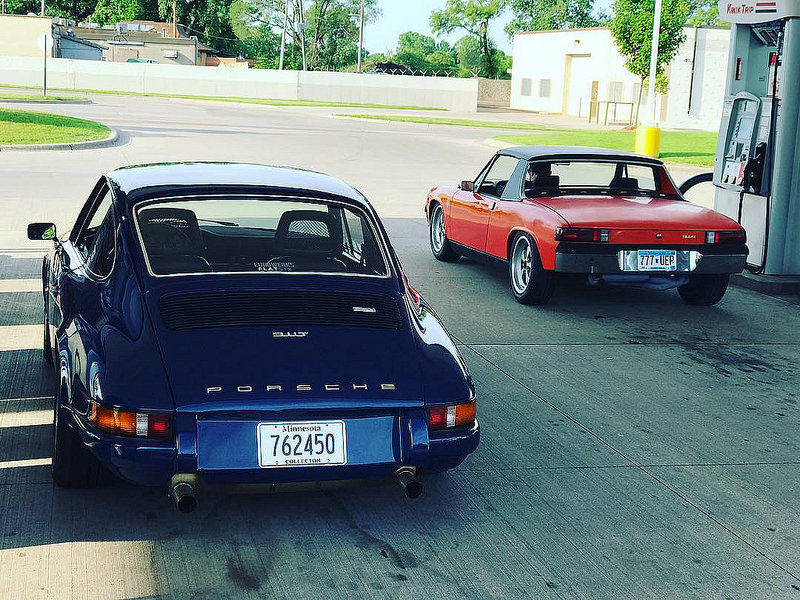

It's first real public appearance was at the June C&C that I attended with a good friend in his 911.
(IMG:http://www.914world.com/bbs2/uploads_offsite/c1.staticflickr.com-19709-1497540075.2.jpg)
Exiting a cloverleaf he pulled away like I was standing still. To add insult to injury a minivan pulled away too. This lit a little spark, I wanted more power. I started crunching numbers for building the type 4, goal is around 150hp. Can you get 150hp in a type 4 that's home built? Sure, lots of people have done it. But there's an even better, more expensive and headache inducing option...

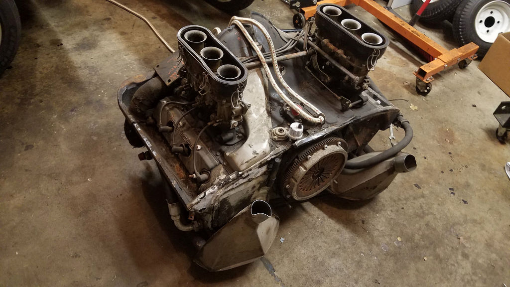

A friend of mine owns Flat Six in Minneapolis, MN. About 40 minutes from me. Sent him a message inquiring about core 6 cylinders and ended up coming home with this.
(IMG:http://www.914world.com/bbs2/uploads_offsite/c1.staticflickr.com-19709-1497540075.3.jpg)
It's a 2.2 from a 911T, the 125hp version. On top are a pair of Zenith carbs that will work fine for my purposes after a complete rebuild. It turns over smoothly and you can feel when it comes up on compression. Good signs for an otherwise unknown engine. If you had followed along in my build thread you'll know that I got some amazing deals, both for parts and for the car itself. The 6 does not disappoint in that regard, but I wont be sharing the details here.
Perhaps the best part of the deal is that he said if I get into it and find that anything is FUBAR, I can get a no-charge replacement from him since he has Parted several 2.2's. Again, this is a friend, I don't expect him to do this for anyone.
With his help we laid out a build plan. Going to get the T cams reground to the E profiles paired with higher compression pistons. Cylinders are iron so I can bore those. Goal is around 150ish hp. It'll be a "budget" build in the sense that I'm not going for huge power and will be doing the assembly/cleaning myself. I won't be cutting corners with machine work and inspection though.
