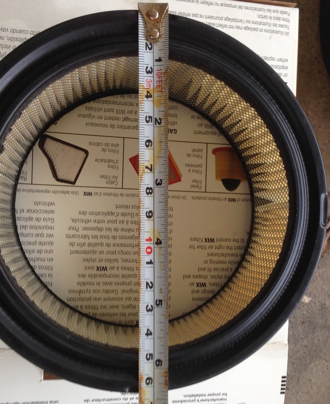

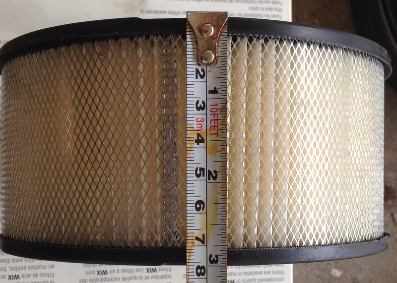

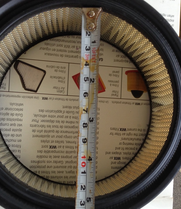

Here's what I'm running now.
Wix 42110
125mm ID
163mm OD
76mm tall
It's 6mm too short, so I cut a piece of cork gasket material the same size as the filter to fill the extra gap. I found 1/4" to be too much, so I think I've got a couple of pieces in there now that are just under 1/4" total.
