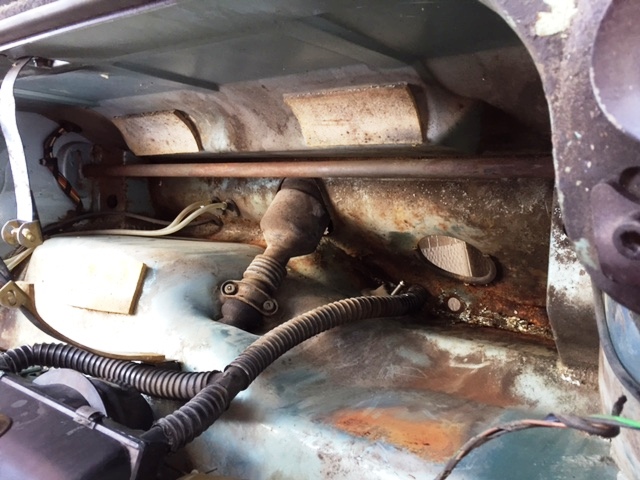

1/17/2021 - resurrecting to ask new question.

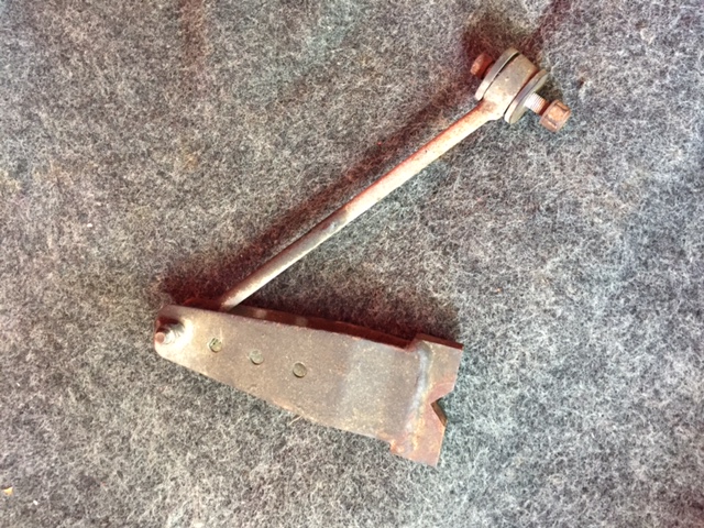

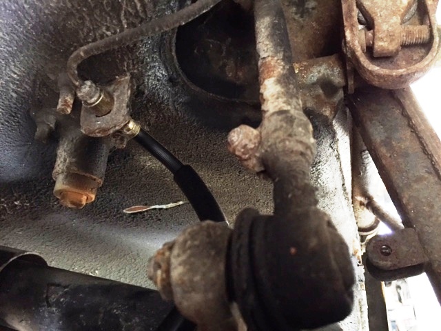

Had the fuel tank out to replace the fuel line in the tunnel. From that I could see the front sway bar. Interestingly, the passenger side was connected and the driver side is not connected. In a box of parts that was with the car I found the drop link for the driver's side. It, however, is missing the cap and bolts to attach it to the bar. Does anyone know where I can get the piece to fit this part? Size of the bolts? Thank you.

rhodyguy   Is that an H&H bar? Stock droplinks don't ...   Jun 24 2017, 12:23 PM
GeorgeRud   Looks like an old H&H swaybar. Should be easy...   Jun 24 2017, 12:24 PM
Matty900   This is what the stock ones look like.   Jun 24 2017, 12:37 PM
gandalf_025   That bar was made by H + H Specialties. The owner ...   Jun 24 2017, 03:32 PM
KevinW   I have one that I won't be using. The mate to ...   Jun 24 2017, 03:43 PM

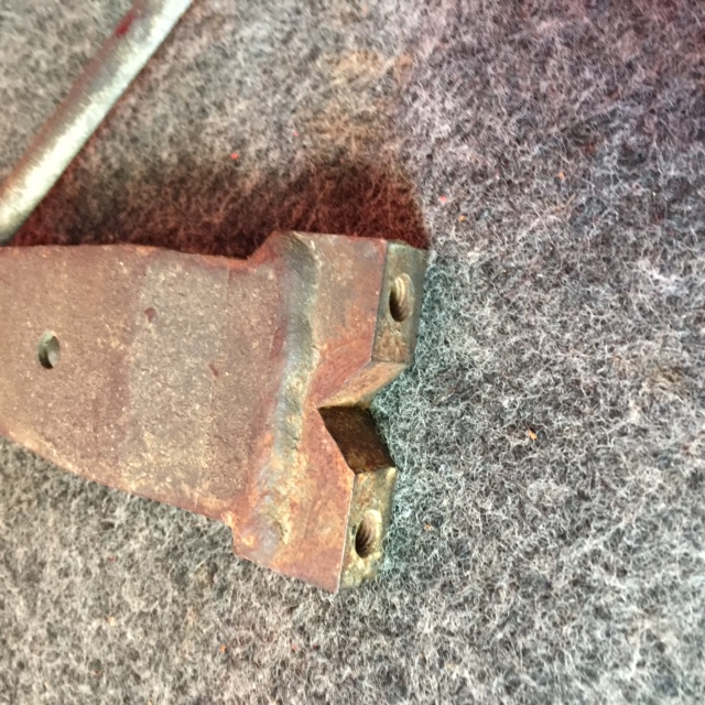

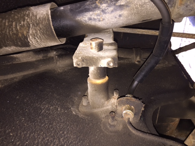

seanpaulmc   Here is a picture of the bar end and bushing. Bus...   Jan 19 2022, 04:13 PM
Superhawk996   That is an awful lot of front bar at 19mm. Stock ...   Jan 19 2022, 04:23 PM
roblav1   Concur with way too much front bar on that! U...   Jan 19 2022, 09:07 PM
Freezin 914   As others here have stated, for sure an H&H ba...   Jan 19 2022, 10:00 PM
bossboy302   This might help. The aftermarket kits that work wi...   Jan 19 2022, 10:14 PM

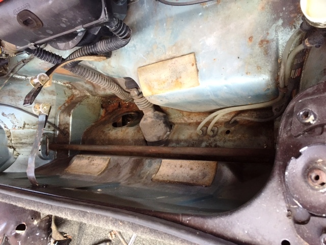

seanpaulmc   Hi All, Thanks for the replies. I’m still at i...   Jan 30 2022, 08:14 PM

rhodyguy   Good picture. Darn U bolts. The shelve directly un...   Jan 31 2022, 07:58 AM

seanpaulmc   I want you all to know I very much appreciate all ...   May 6 2022, 05:53 PM
rjames   Nice job. Glad to see the plates welded in properl...   May 6 2022, 06:26 PM
