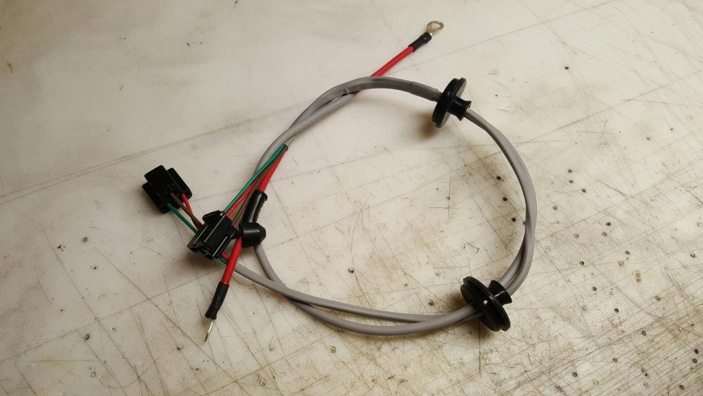

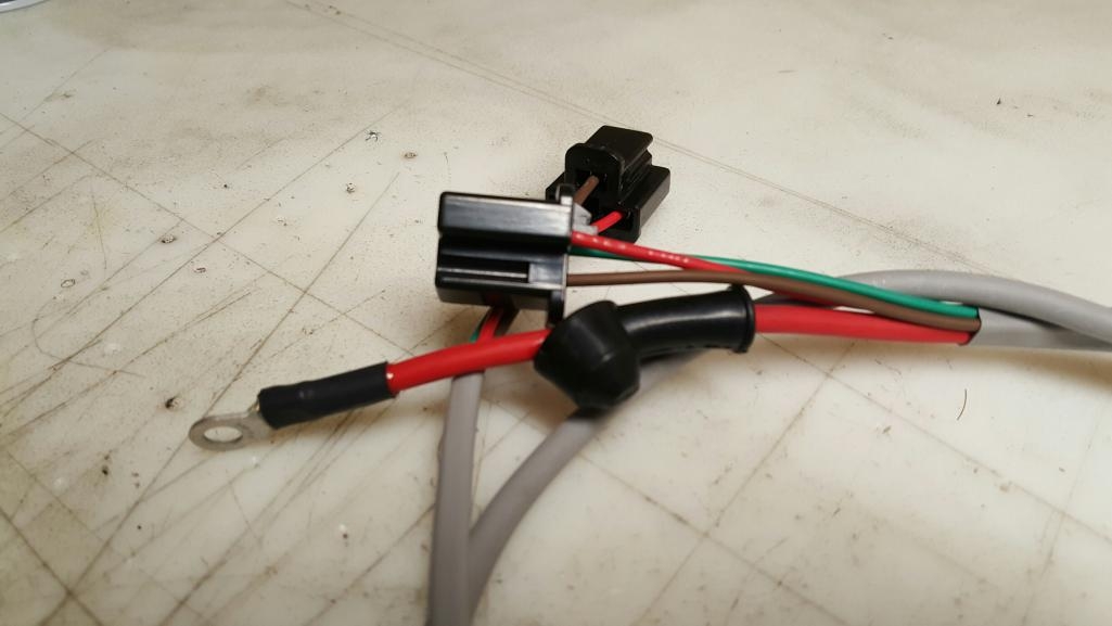

Mikey914
post Jul 7 2017, 11:43 AM
The rubber man
Posts: 12,772
Joined: 27-December 04
From: Hillsboro, OR
Member No.: 3,348
We have made the replacement harness with the correct cap on it. Also working on the deflector, boot, and some other little goodies that fit in there. Unfortunately, they are several weeks out. But the harness is in stock if you need one. Do check to see if the 3 prong connector is brittle, and it the red wire has evidence of melting the protective covering.
http://shop.914rubber.com/Alternator-wirin...m?categoryId=-1
Here's a code for $15 off it you need one
"ALT10"
In fact one of those parts is also ready and on sale (I'll start a dedicated thread)

QUOTE(Mikey914 @ Jul 7 2017, 10:43 AM) *
Are you going to make the gasket too ? (IMG:style_emoticons/default/smile.gif) (The one that goes under the backing plate )
