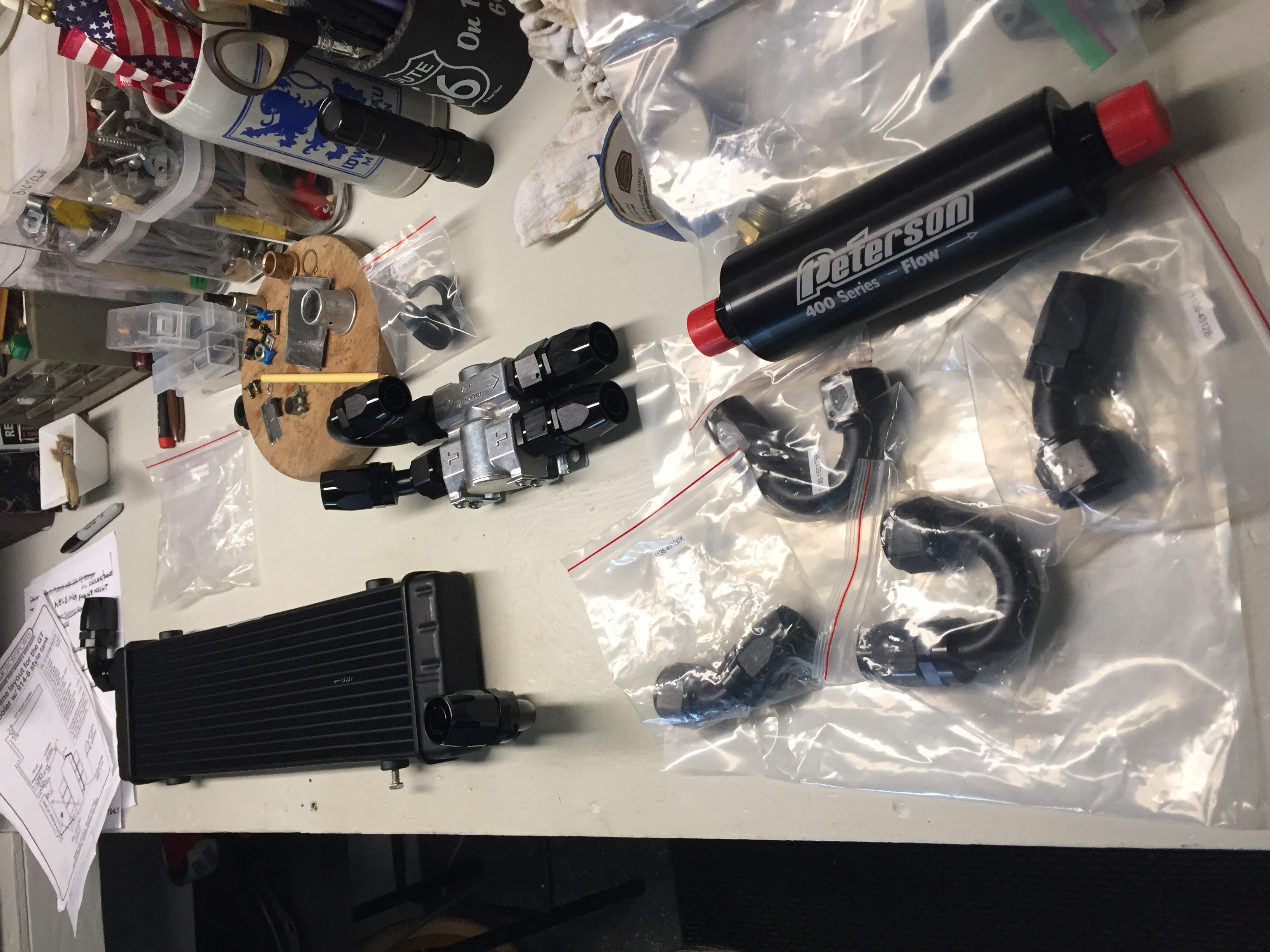

Keith came by to pick up the Patrick sourced Peterson inline style filter on my bench (on the right.) It has AN-12 ends and should let the oil flow as planned.
I wish Keith good luck on a Monday start-up with no more major oil issues.

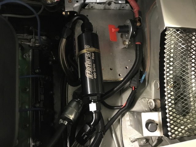

Installed the in-line filter that Larmo sold to me, problem solved (IMG:style_emoticons/default/beerchug.gif) Attached Image
