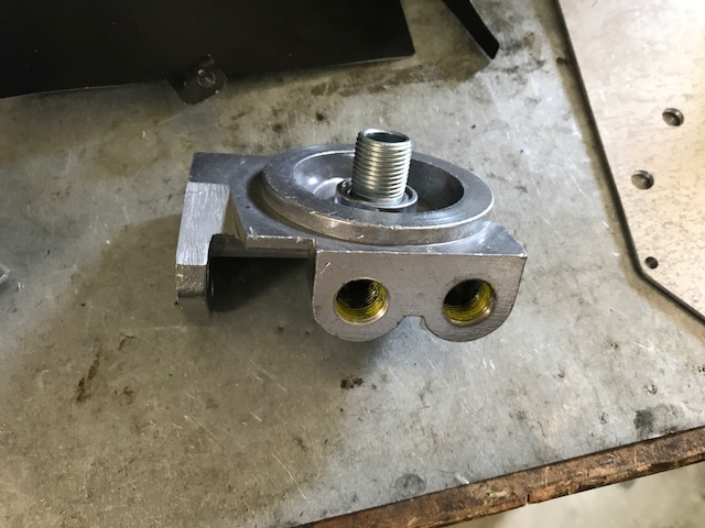

Next I owe you an apology - the inside non-threaded plumbing in toy old bracket -picture above, is 3/8'" diam, just measured again, and the inlet and outlet ports are 3/8"NPT. My new bracket, just delivered, has 1/2"NPT inlet and outlet ports with corresponding internal plumbing non threaded - much better than smaller old bracket. the filter spin on nipple however is the same 3/4"-16 as the older unit. I need to get AN12 fittings to connect the hoses to these larger 1/2' ports and a good filter to spin on - tomorrow will report back.
Mark Henry
1/2" NPT is still a tad small IMO.
All the AN-12 stuff (which is correct size for a front cooler) is wasted, as you flow will be restricted to 1/2"
The filter adapter should be AN-10 or 5/8" sized, which is right about the stock tank/filter size.

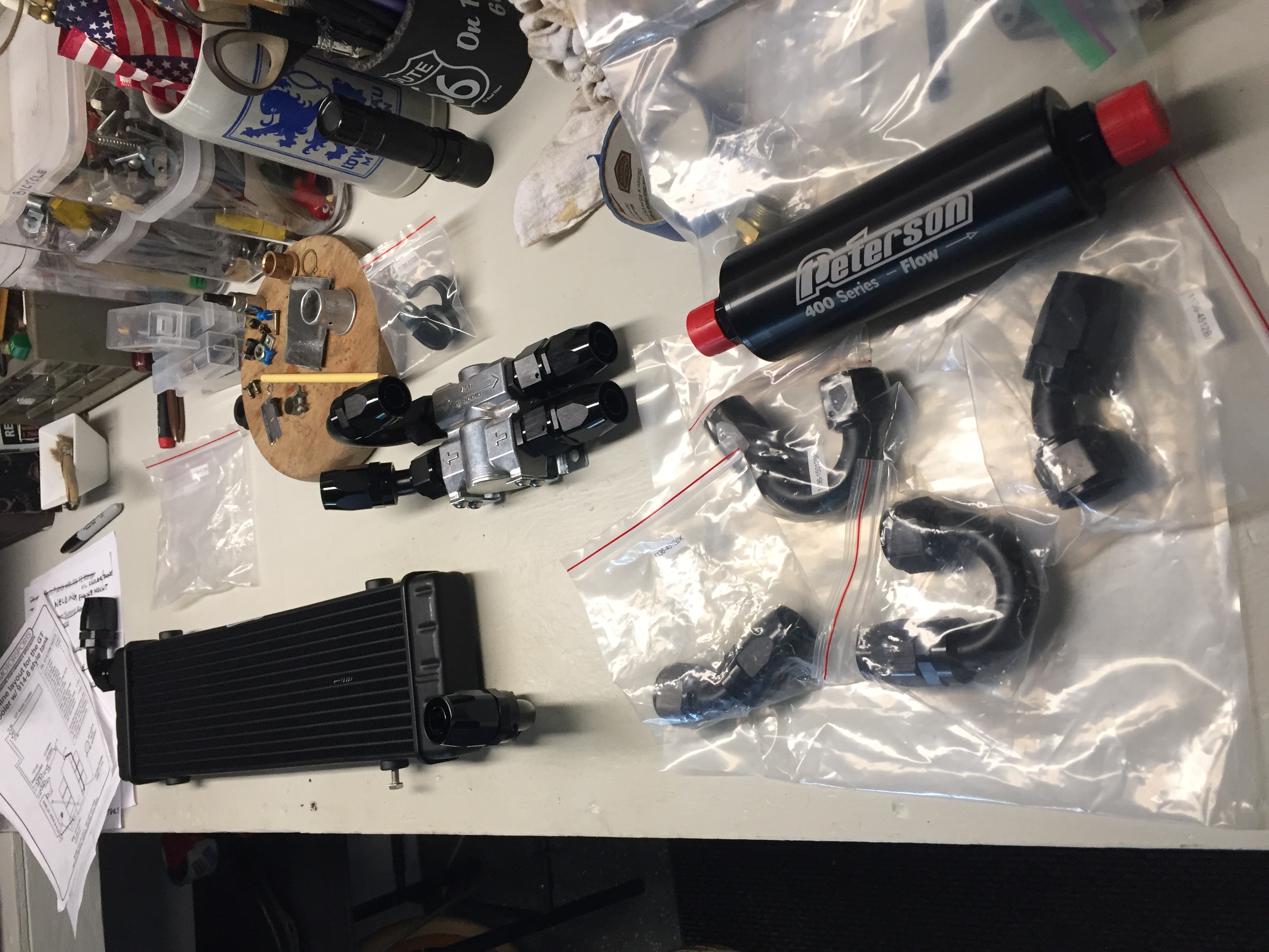

Larmo63
Keith came by to pick up the Patrick sourced Peterson inline style filter on my bench (on the right.) It has AN-12 ends and should let the oil flow as planned.
I wish Keith good luck on a Monday start-up with no more major oil issues.

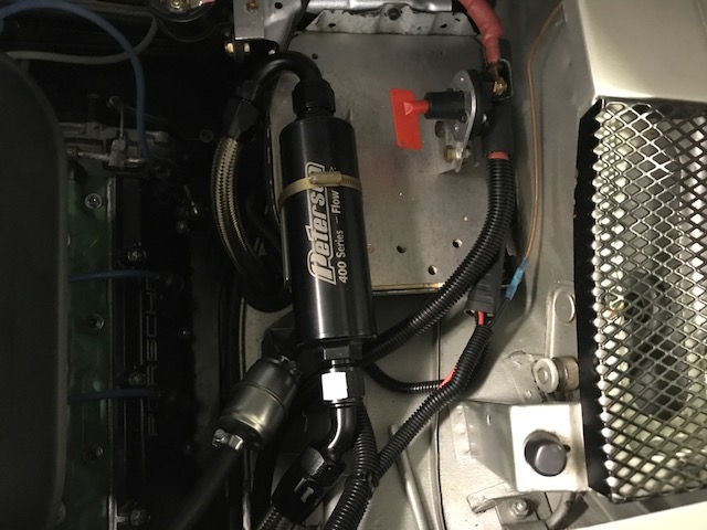

Keith914
Installed the in-line filter that Larmo sold to me, problem solved beerchug.gif Click to view attachment
