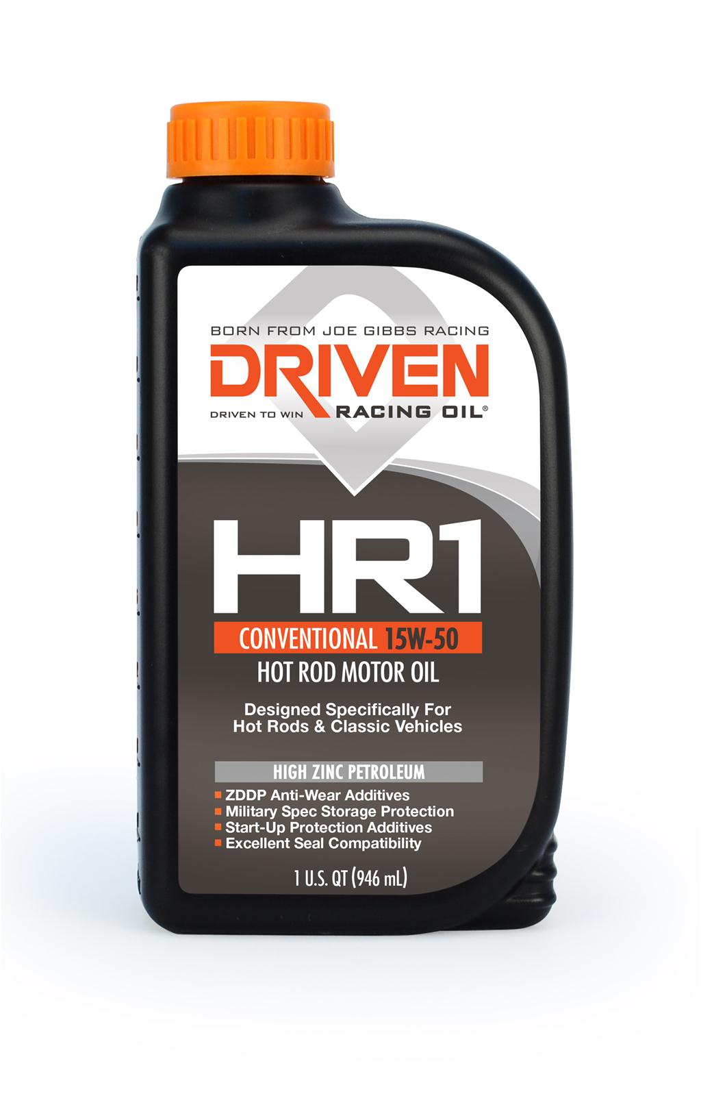

I have a 78 SC in my car and run Driven HR1 15/50 conventional. Lake Speed has covered this in a session I was able to attend. high zink (ZDDP) startup and storage additives. It's not loaded with detergents but all the right stuff for air cooled engines. I like it better than Mobil one and Motul
