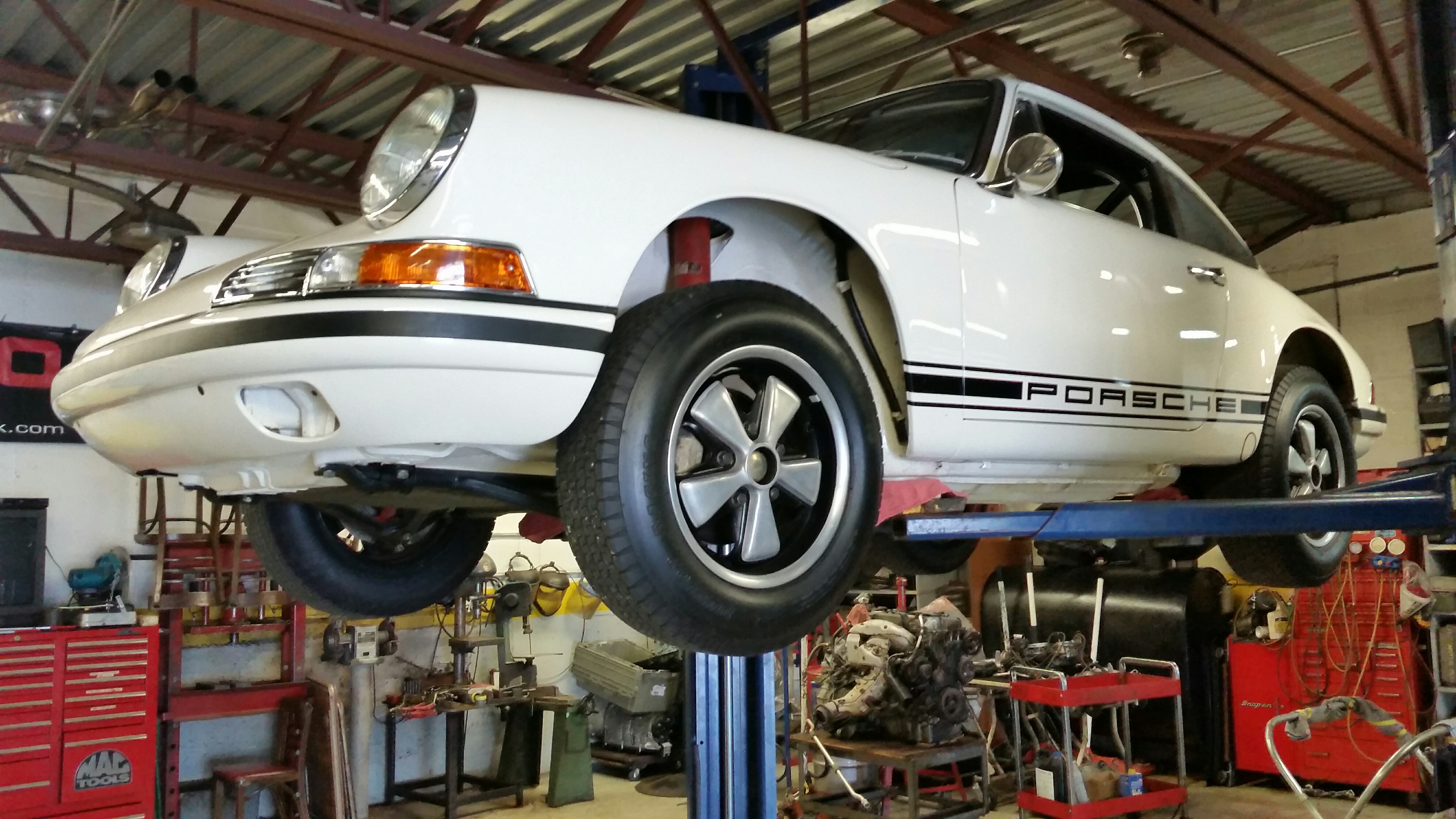

Hi all,
Last week a coworker sent me a photo of a 911 without a VIN.
Its a factory built race car that the owner bought new around 1970 (i think) and put the car away, never really drove it i guess.
To look at the photo you'd think it was a nut and bolt restoration, but its all original!
So, did Porsche actually build cars without a VIN in situations like this?
I can't help but think that they had to put some sort of numbers/ID on it.
Did they build any 914s in this same manner?
SteveAttached Image

carr914   It's called "Body in White" and a 91...   Jul 11 2017, 04:55 PM
SirAndy   It's called "Body in White" and a 91...   Jul 11 2017, 05:04 PM
Edward Blume   It's called "Body in White" and a 9...   Jul 11 2017, 05:11 PM
Tom_T   Steve, Since a VIN is technically only a US-DOT ...   Jul 11 2017, 05:14 PM
74ravenna   Thanks for the explanation Tom. Never heard of ...   Jul 11 2017, 05:18 PM
