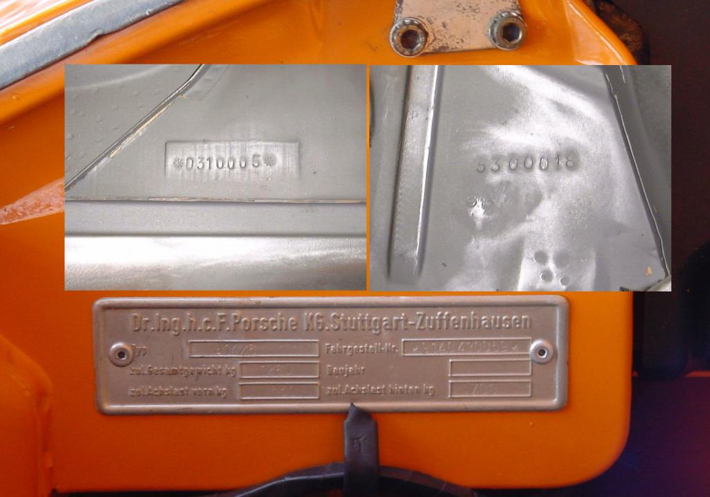

Hi all,
Last week a coworker sent me a photo of a 911 without a VIN.
Its a factory built race car that the owner bought new around 1970 (i think) and put the car away, never really drove it i guess.
To look at the photo you'd think it was a nut and bolt restoration, but its all original!
So, did Porsche actually build cars without a VIN in situations like this?
I can't help but think that they had to put some sort of numbers/ID on it.
Did they build any 914s in this same manner?
SteveAttached Image

carr914   It's called "Body in White" and a 91...   Jul 11 2017, 04:55 PM
SirAndy   It's called "Body in White" and a 91...   Jul 11 2017, 05:04 PM
Edward Blume   It's called "Body in White" and a 9...   Jul 11 2017, 05:11 PM
Tom_T   Steve, Since a VIN is technically only a US-DOT ...   Jul 11 2017, 05:14 PM
74ravenna   Thanks for the explanation Tom. Never heard of ...   Jul 11 2017, 05:18 PM

gms   I believe a “body in white” was just that, a b...   Jul 11 2017, 06:44 PM
Tom_T   I believe a “body in white” was just that, a ...   Jul 11 2017, 06:55 PM
gms   I believe a “body in white” was just that, a...   Jul 13 2017, 09:24 AM

gms   Hi Glenn, According to an e-mail I have from 2004...   Jul 15 2017, 10:39 AM

yellow75   that looks like a 911R. SUPER RARE..   Jul 12 2017, 08:17 AM
rgalla9146   that looks like a 911R. SUPER RARE.. It's...   Jul 12 2017, 04:41 PM
flyer86d   that looks like a 911R. SUPER RARE.. It...   Jul 13 2017, 05:01 AM
gms   that looks like a 911R. SUPER RARE.. It does not...   Jul 13 2017, 09:26 AM

Darren C   "Body in White" is a generic name used b...   Jul 13 2017, 05:15 AM
Tom_T   "Body in White" is a generic name used ...   Jul 13 2017, 07:51 AM

gms   found replacement body pix   Jul 13 2017, 09:36 AM
gms   I believe this was a 4 cylinder car in the Netherl...   Jul 13 2017, 09:45 AM
Tom_T   Thanx Glen! That's good "documentati...   Jul 13 2017, 09:52 AM
