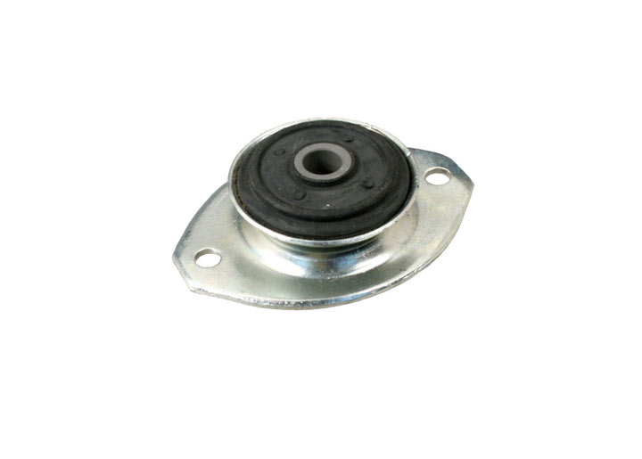

is there a difference in height or thickness from the 911 mount vs the 914 mount of this style?

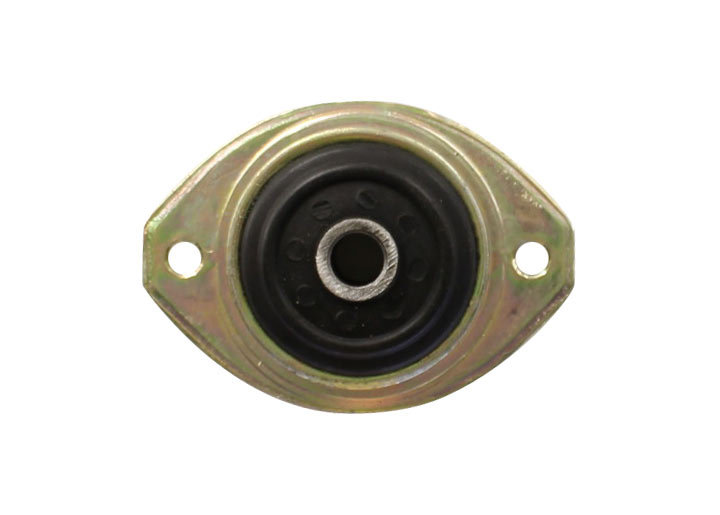

gms   I put them on my 914/6 as trans mounts as I recall...   Jul 13 2017, 11:02 AM
stownsen914   I believe the 914 mounts are substantially softer,...   Jul 13 2017, 11:50 AM
SirAndy   The 911 sport mounts are the same thickness but yo...   Jul 13 2017, 11:54 AM
jimkelly   because on the later cars the side shift engine ba...   Jul 13 2017, 03:09 PM
Steve   I think the rear 914-4 ones had holes through the ...   Jul 13 2017, 03:42 PM
flmont   I was actually going to ask if the 911 mount's...   Jul 13 2017, 06:18 PM
Dave_Darling   I was actually going to ask if the 911 mount...   Jul 14 2017, 09:30 AM
jimkelly   i plan to use 911 mount and these 2 oem 914 washer...   Jul 13 2017, 07:21 PM
flmont   Ahh Ok Ill look in to that ...Thanks   Jul 13 2017, 07:46 PM
GeorgeRud   The 911 mount will work as described. The origina...   Jul 13 2017, 08:19 PM
gms   I just saw the mounts for sale on Pelican . You w...   Jul 14 2017, 09:41 AM
gms   901-305-311-00 they look like this   Jul 14 2017, 09:53 AM
Andyrew   911 sport mounts for the trani (What you have pict...   Jul 14 2017, 10:37 AM
jimkelly   it's always something :) so it looks like 2...   Jul 14 2017, 11:48 AM
BillC   it's always something :) so it looks like ...   Jul 14 2017, 12:19 PM
gms   are they big enough to hold engine off the floor ...   Jul 14 2017, 12:26 PM
mepstein   I wouldn't buy used. The new ones aren't t...   Jul 14 2017, 12:34 PM
jimkelly   thanks guys :wavebye: yup, seems best to buy mo...   Jul 14 2017, 12:40 PM
