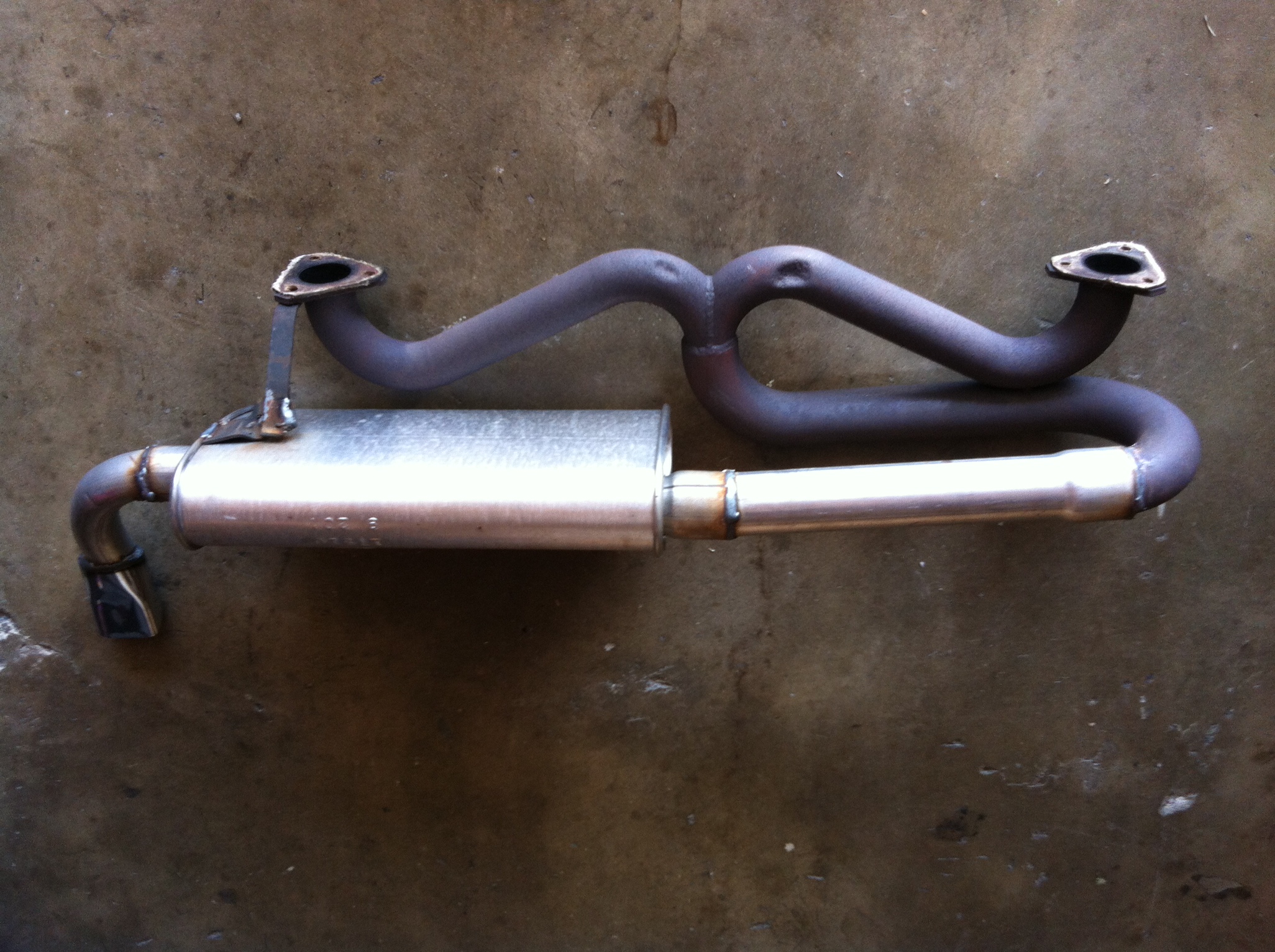

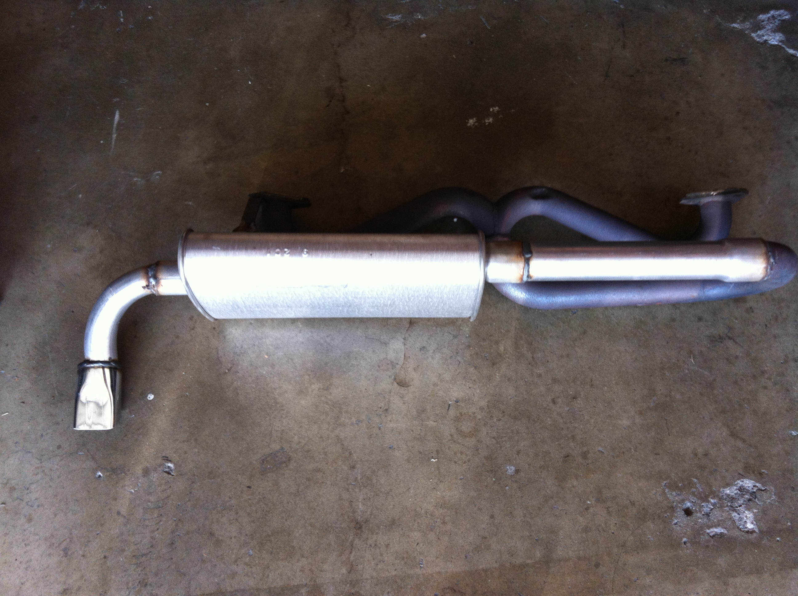

ndfrigi
post Aug 2 2017, 12:44 AM
Posts: 2,983
Joined: 21-August 11
From: Orange County
Member No.: 13,474
This exhaust came from my 75 1.8FI when I still have the original 75/76 HE. The pipe is the original for 75/76 but I replaced the muffler to aftermarket plus square shape chrome tip. Actually it is for sale.
Attached ImageAttached Image
